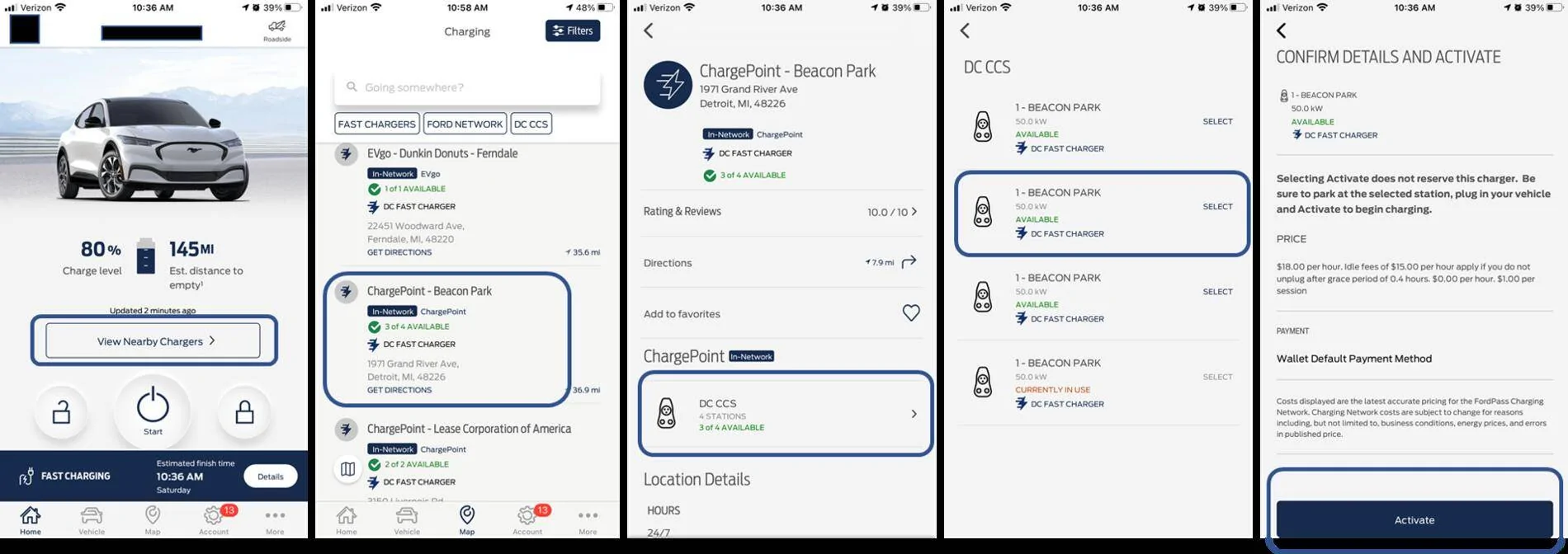

Here's a step-by-step for charging from the FordPass app sent to me from Ford:
Ford Mustang Mach-E How to Enable Plug & Charge in 7 Steps Activate Charging
