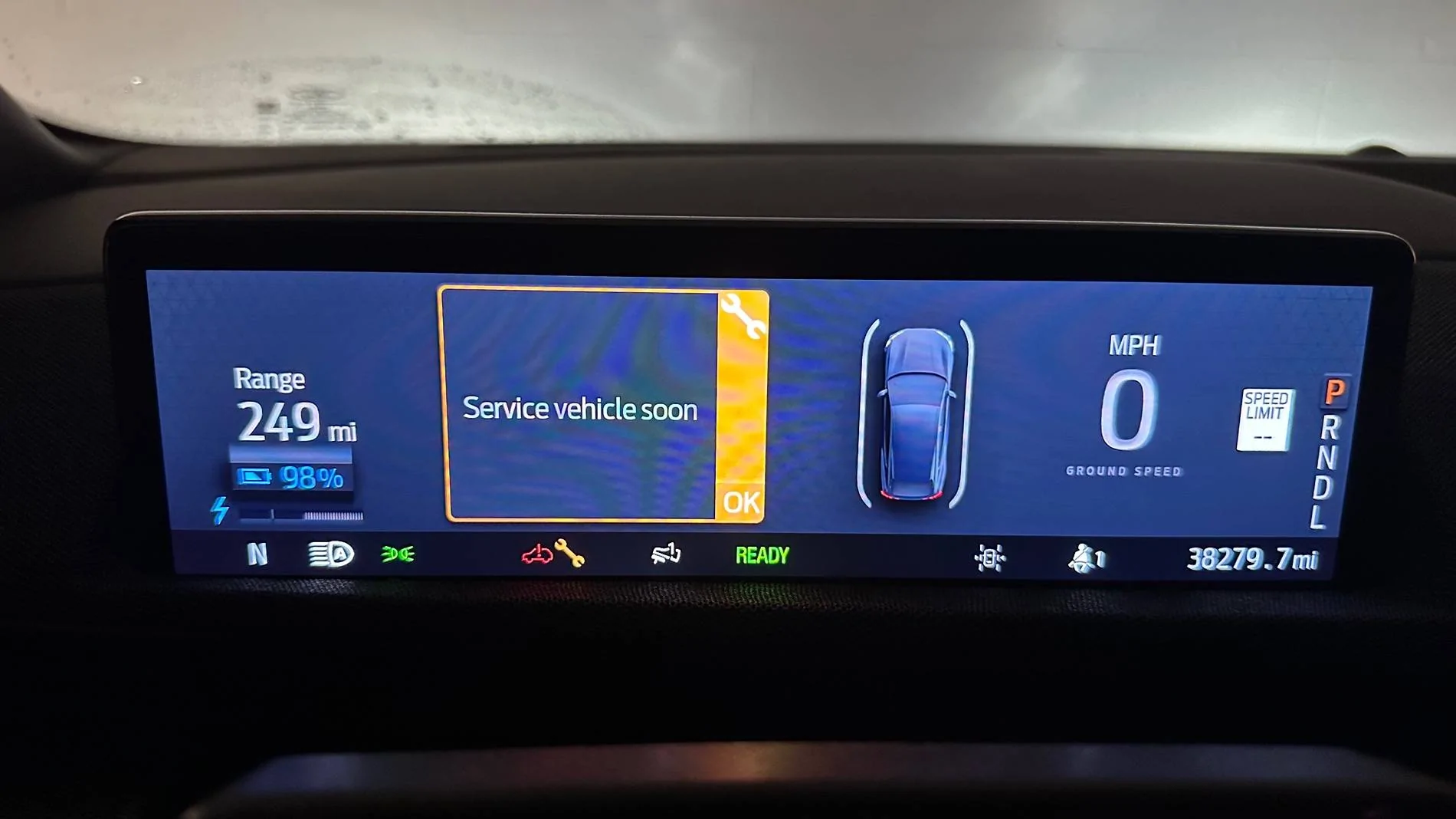

Have you had to get the car towed each time this fails or are you still able to drive it to the dealer?
I've had mine replaced twice and both times have been able to drive normally to the dealer 50 miles away after the warning and each was done promptly.

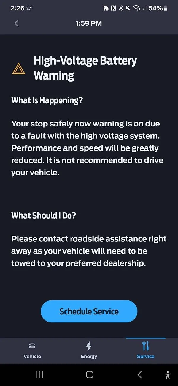

It depends on the issue the car has seen with it. If it presents you with Service Vehicle Soon (SVS) then you can drive the car for a while. If you are presented with Stop Safely Now (SSN) you can only drive a short distance and the car may lose motive power. An SVS may turn into an SSN at any time. Most people have been under SVS for hundreds if not thousands of miles and never saw it progress to an SSN. My 2021 was under SVS and it switched to an SSN while I was waiting in line to check my car in at the dealership service department. That is a very rare case. ??

While many people can still drive, you won't be able to DC fast charge faster than 42 or so kW. We had this happen on day 2 of a trip, thousands of miles from home, with thousands of miles to go. Fast charging went from 30 to 90 minutes per stop, and added 14 hours to the trip. Ford's BEV group was unaware at the time of this change made to the code. Really pissed me off.
