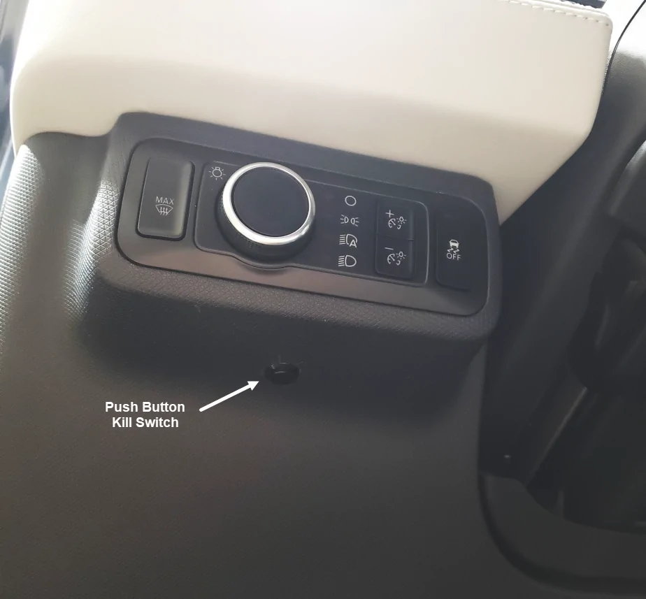

Aftermarket Device #1:
I have a hardwired dash cam, power for which comes from two fuse taps in the passenger foot-well fuse box. One - a switched tap - is for driving mode, i.e. vehicle power button is 'on' and the other - an unswitched tap - is for parking mode, i.e. vehicle power button is 'off'. Both circuits are integrated and controlled by an inline brain box that does two things: (1) it provides power to the camera when the vehicle is turned off (i.e. vehicle is 'parked'), and (2) it has a user-adjustable cut off function to prevent excessive battery drain when the unswitched 'parking' circuit is active. My cut-off is set at 12.4V. So then, when my vehicle is turned 'off' the unswitched parking circuit activates to provide vehicle-off camera power. So in parking mode, whether the camera is actively recording or not, it remains 'on'. To preclude unwanted video recording of the inside of my garage when I return home, or any other time I don't want or need parking mode recordings, I installed an inline kill switch to open the parking mode circuit (my unswitched circuit). My habit is to actuate the kill switch when I arrive home, but there have been times when I either forget or I clumsily don't actuate the switch when I think I have (it's a mini-push button style switch). In those instances, the 12.4V cut-off has worked as advertised to prevent battery drain and I've never had an issue with low voltage. Ever.
Ford Mustang Mach-E I got the dreaded 'Electrical Drain' warning message 1778011075130-3
For clarity, my kill switch was actuated (power was off) in the time frame of receiving the 'Electrical System Drain' message.
