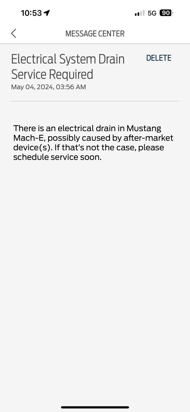

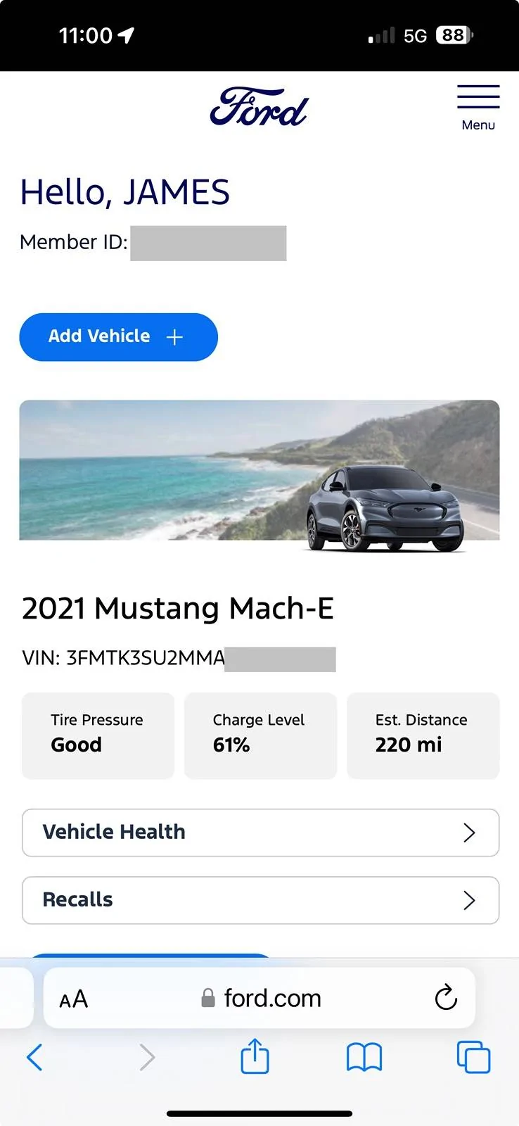

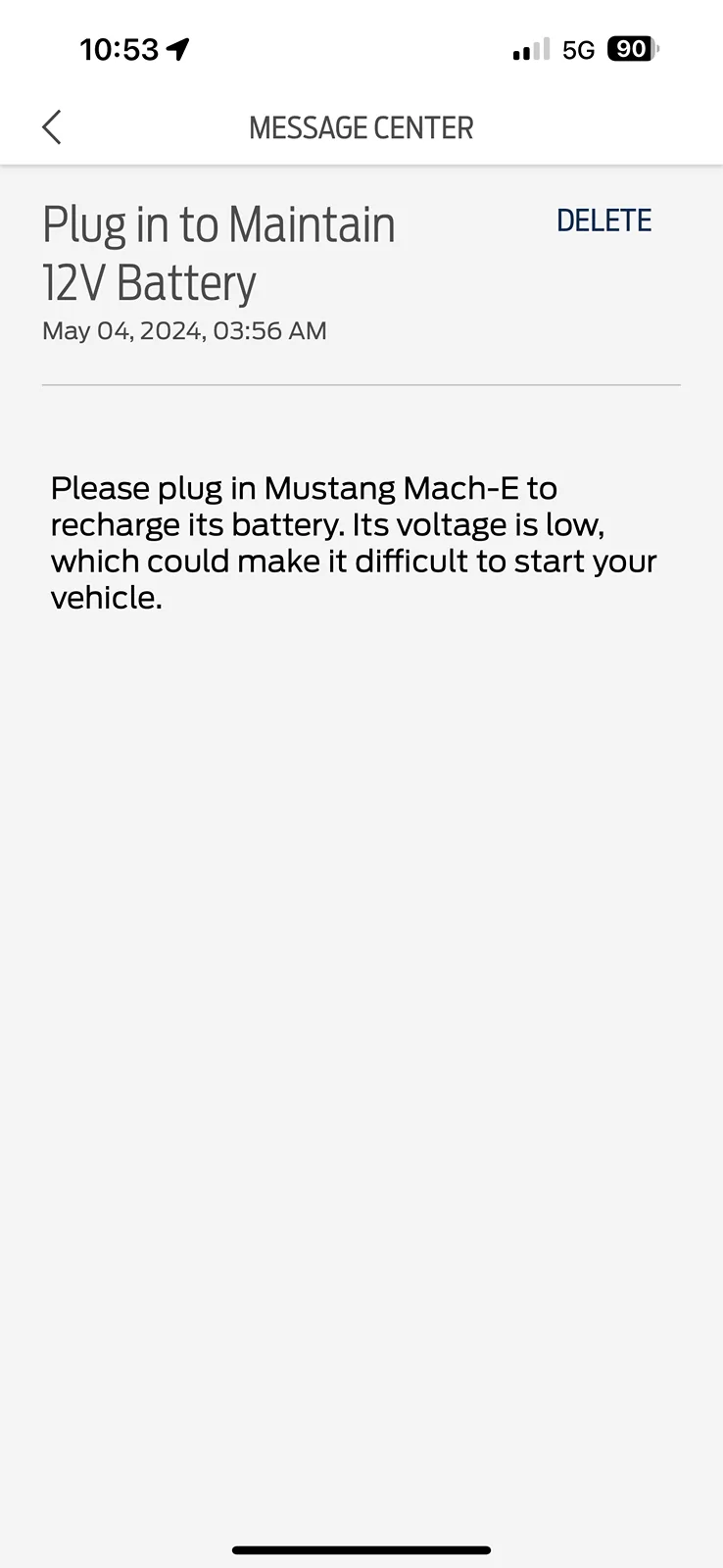

Rather than starting a new thread, I’ll piggyback off of this one. To start, I have a MY21J1 Premium AWD ER. I do not have ANY aftermarket accessories (and specifically, NO Electrical accessories like dash cams, illuminated ponies, koi pond aerators, etc.) Got in the car this morning to be greeted by a dialog on the IP that said “Electrical system drain. Service required.” According to Ford.com, my battery (presumably still 12V) is at 61%.
Went into FordPass and saw the two messages below. So, the big question: am I ok to drive around this weekend until I can schedule service?.
