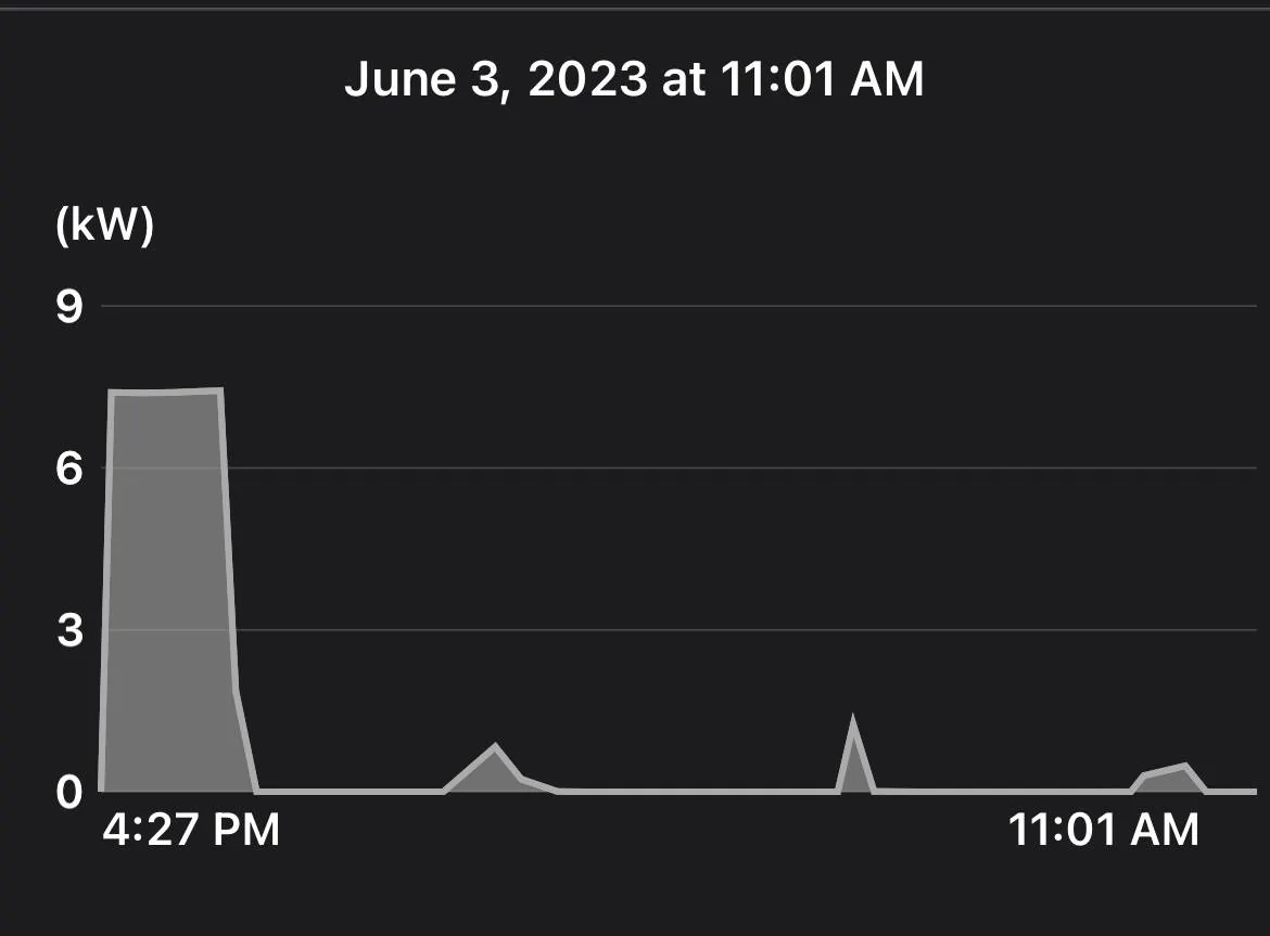

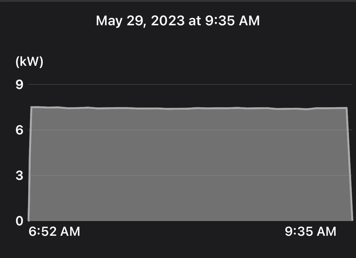

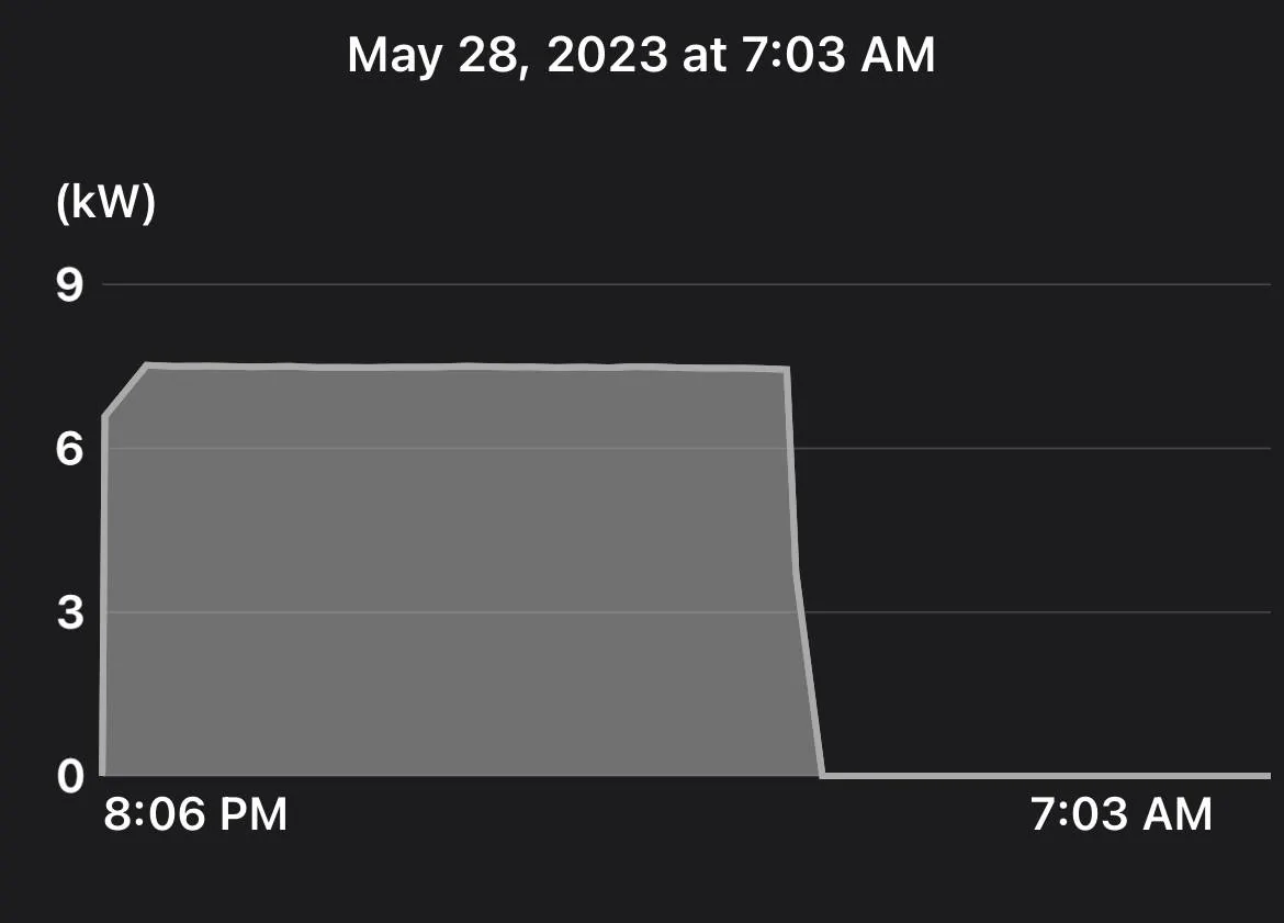

The two sessions before the message. The 5/29 one was the charge fault when unplugging.
Ford Mustang Mach-E Electrical System Drain error message - no TSBs? IMG_0119
Ford Mustang Mach-E Electrical System Drain error message - no TSBs? IMG_0124
This one after the error messages began.
Ford Mustang Mach-E Electrical System Drain error message - no TSBs? IMG_0120
Blips are strange. Hmmm.
