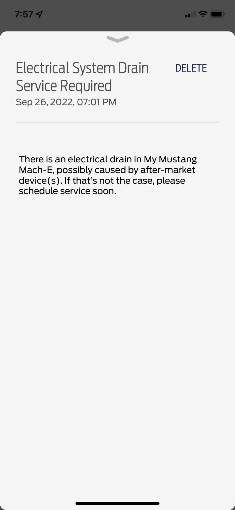

I got the message below about Electrical System Drain twice in the last two days on both FordPass and a few seconds on starting the MME.
The SOC% was what I expected and the car ran normally. Is this anything I should be concerned about?
BTW, I don’t shave anything in the ob2 slot or anything aftermarket attached.
It's a 12V battery drain and not your HVB. Usually I get it if my dashcam doesn't turn off or if I have left my phone plugged in. Also, the car is NEVER "off". It talks to Ford/FP app even when off which will use 12V battery power. However if unplugged and you have enough charge in the HVB it shouldn't be too much of an issue as your 12V should get charged from the HVB.

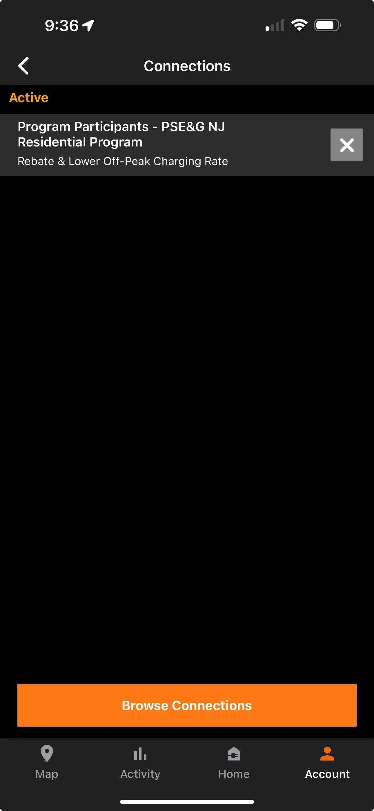

I just started using a ChargePoint EVSE connected to my utility provider for the off-peak discount and am now seeing the ā€œElectrical system drainā€ message. However, I did not connect my Ford account to the utility or ChargePoint. All the utility has is the ChargePoint serial number and a ā€œconnectionā€ in the Chargepoint app.
Would it be the ChargePoint charger polling the car for data that is causing this? That would seem silly since the charger would need to be plugged in to do that, meaning the LVB wouldn’t drain, right?

My utility also uses ev.energy. I’m in CT. As long as they are connected directly to the EVSE, and do not have your Fordpass login password, this isn’t causing your drain.
If for some reason you allowed ev.energy to login in to your FordPass account, call them and have the vehicle removed ( change FordPass password).

Thanks. I'm not sure what my utility uses, below is the screen I was told to connect with my utility in the Chargepoint app. Thankfully no Fordpass connection needed. So pinging should only happen when the EVSE is plugged into the car, and like you said, should keep the 12V topped off.
I have a dashcam installed via USB but unplugged it the first time I got this message a few days ago. Still getting the drain error message.
Ford Mustang Mach-E Electrical System Drain Message 89285

I have the same. Chargepoint home flex connected to my electric utility. It has not caused any 12V drain issues. I’d be very surprised if the utility is able to poll the car in any way through the Chargepoint. I believe all it does is disable the charger during times of peak electric demand.

I am going to try this: Instead of the *vehicle* having the charge schedule I will set it to "charge whenever plugged in" but make the Chargepoint dictate when it charges on the schedule. Perhaps that will stop the EVSE from pinging for charging data while it's plugged in since it has more inherent information about the session.
