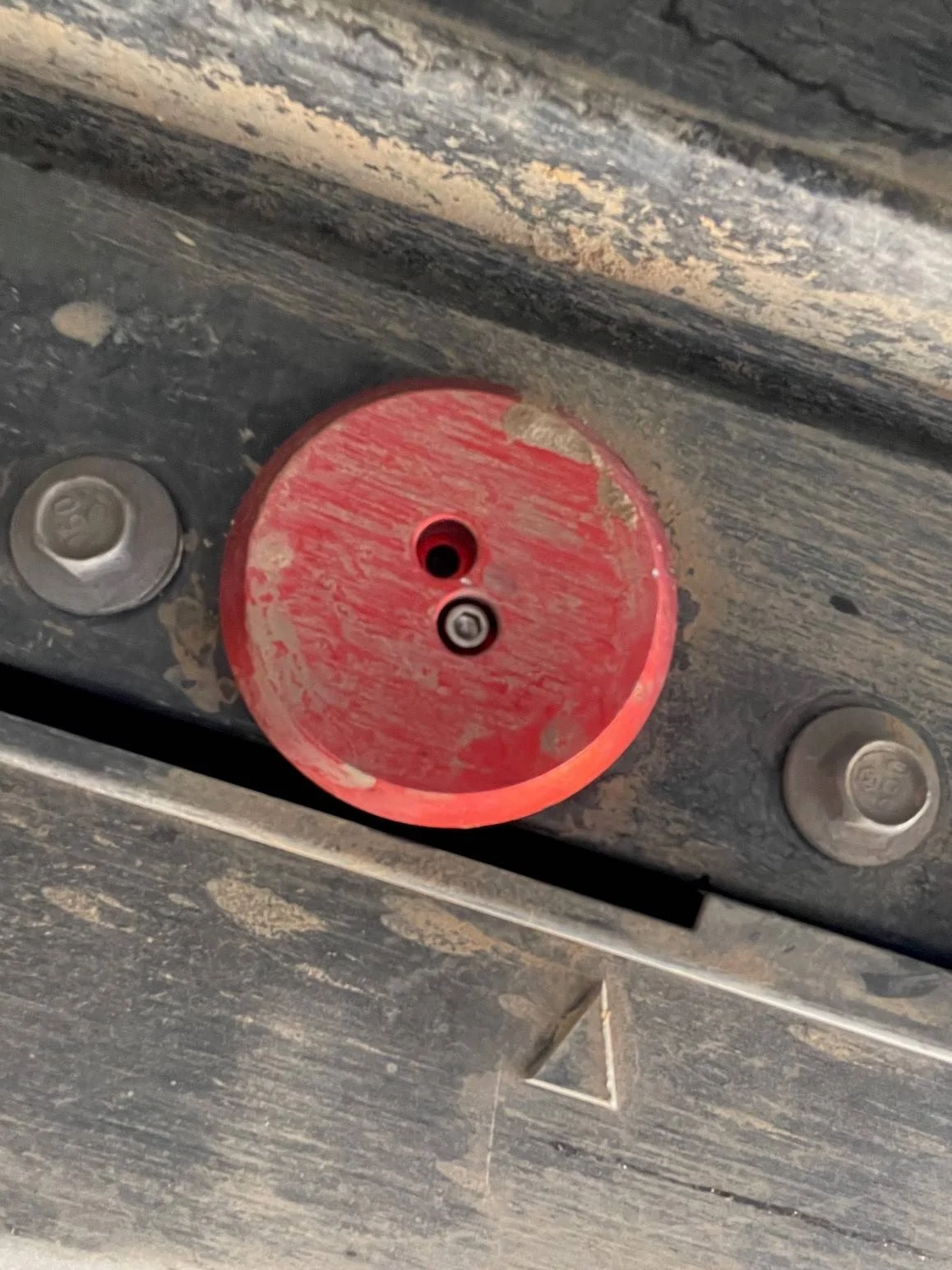

This is a very important topic and I want to confirm everything. I have purchased the "LIFT HERE" stickers and the Corvette pucks. I placed the stickers between the arrows pointing toward the lift point hole. Is that correct? And many on the forum have placed the corvette pucks permanently, yet these links say do not leave them on permanently. Please confirm I have the right information and placement. Thanx, y'all.
I put on a set of the corvette pucks as well, they show up even when the car is dirty. I see no harm in leaving them on permanently.
Have you had to remove them for any reason. I had them on and then took them off. Someone had mentioned they may need to be removed if the battery had to be dropped. Someone also mentioned possible corrosion.
haven’t had time to put them back on. Assume any tire shop will not have an issue with them on

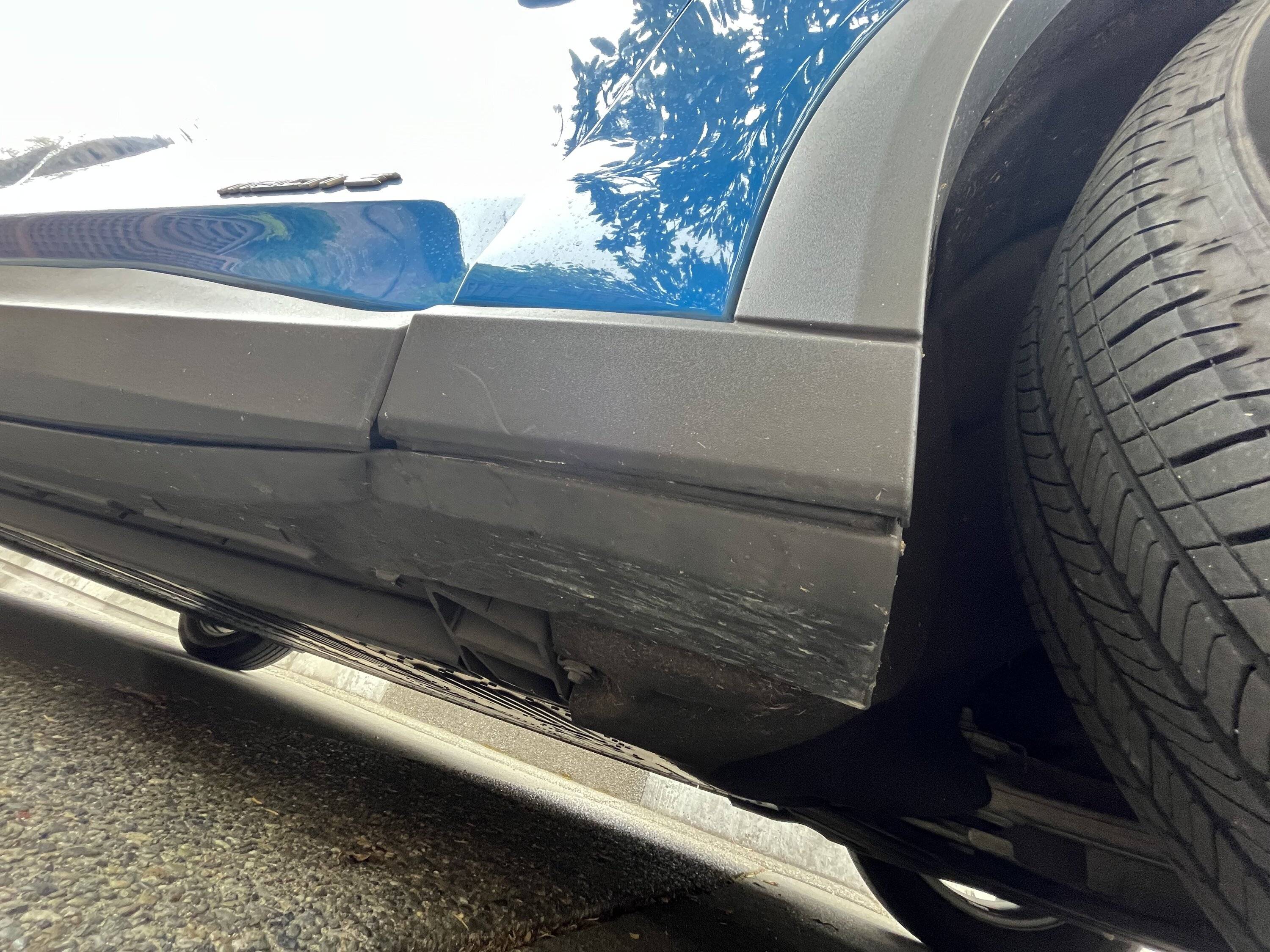

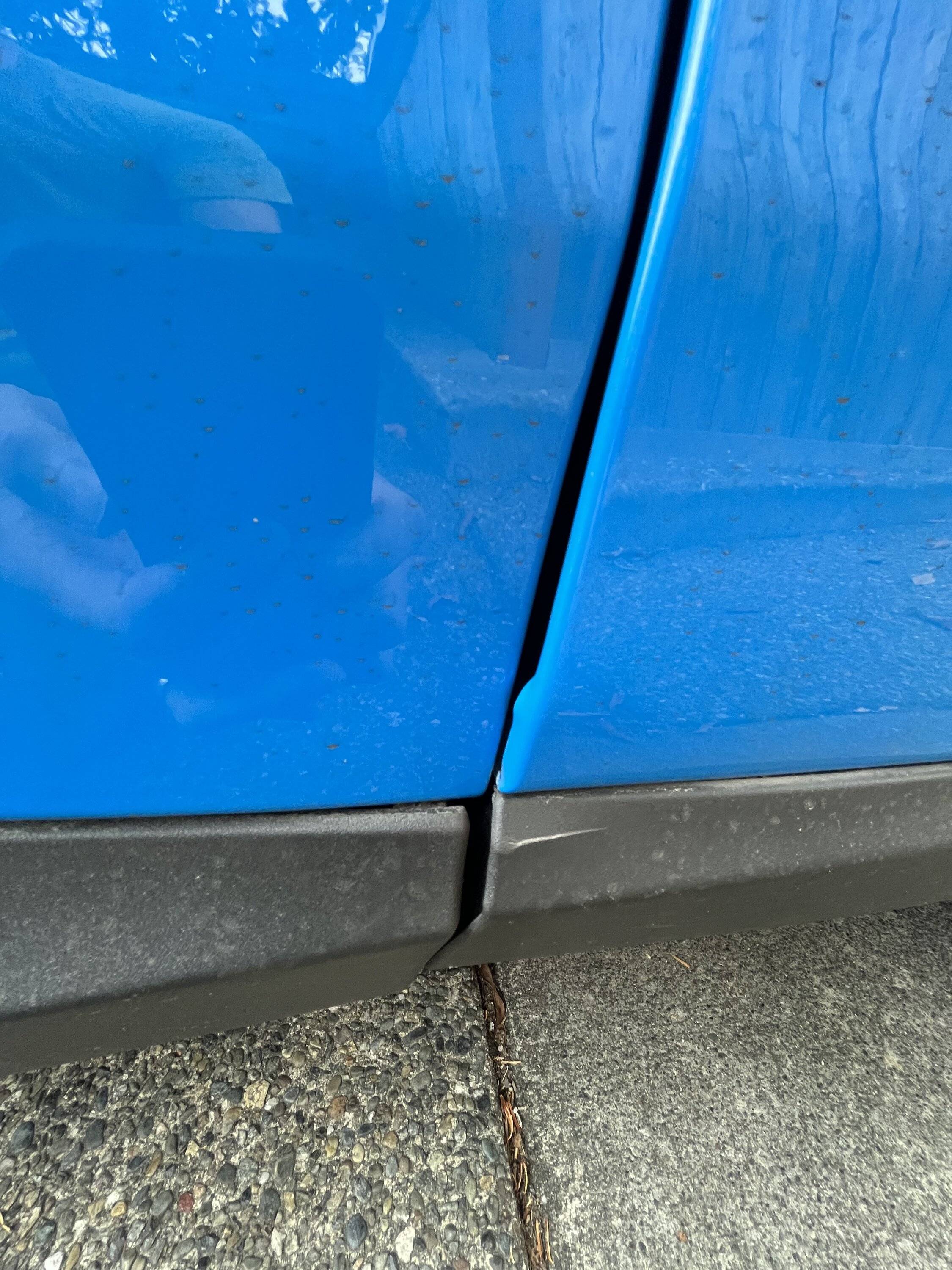

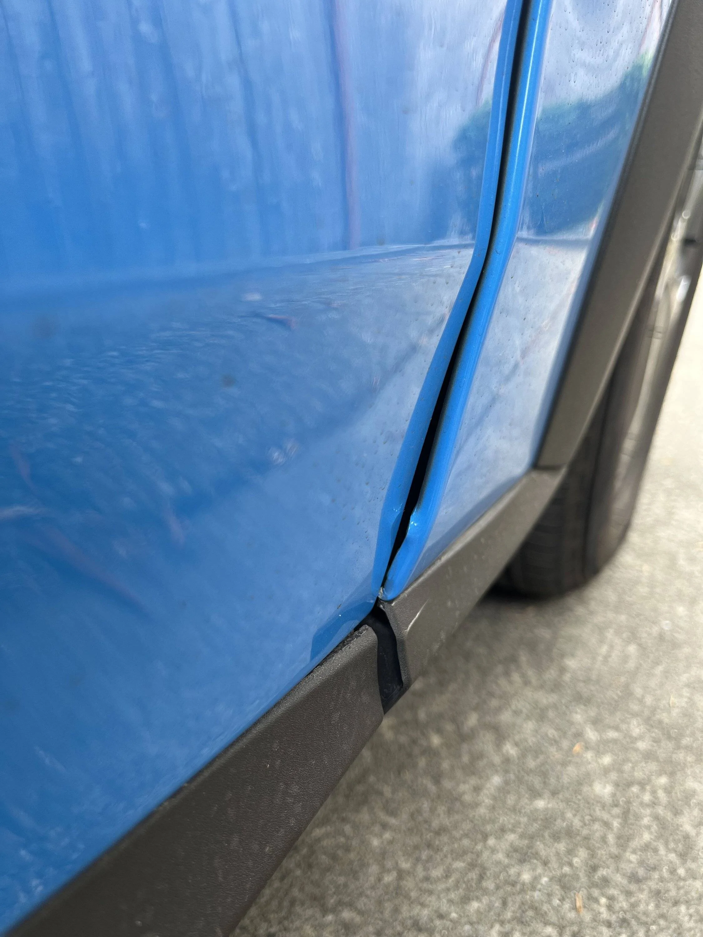

Took my Mach E to the North Seattle Discount Tire for a tire rotation, advised them to be careful when lifting the car. They assured me that they lift EVs all the time. The next day I noticed that the front passenger door crashed into the fender when opened. I took a closer look and discovered that Discount Tire had jacked the car up using the plastic rocker panel under the fender instead of the proper jack point. This bent the fender, rocker panel, and possibly the door as well. Though Discount Tire failed to disclose damaging my car, they were willing to submit a claim to their insurance company when I returned to the store.
Discount Tire uses “Fleet Response” to handle their claims. It’s very difficult to get any help from them. I have multiple preliminary estimates from body shops to repair the car, but I can’t get approval from their insurance.

Update: Discount Tire’s insurance company paid out my claim.
