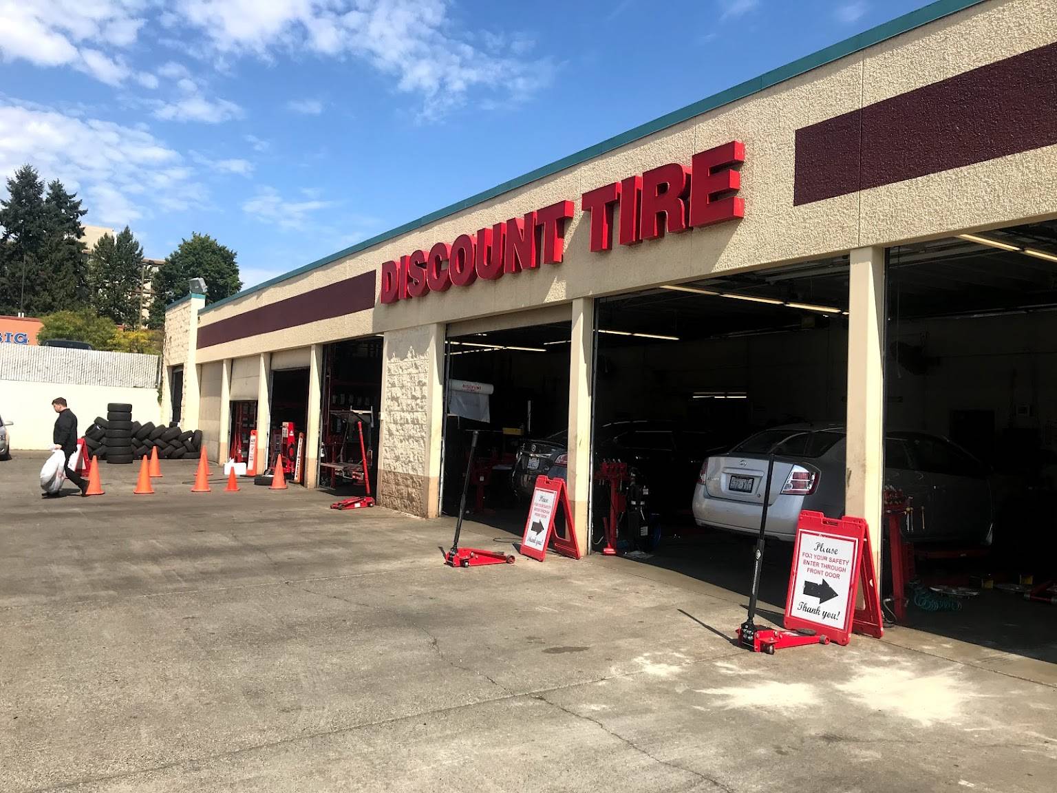

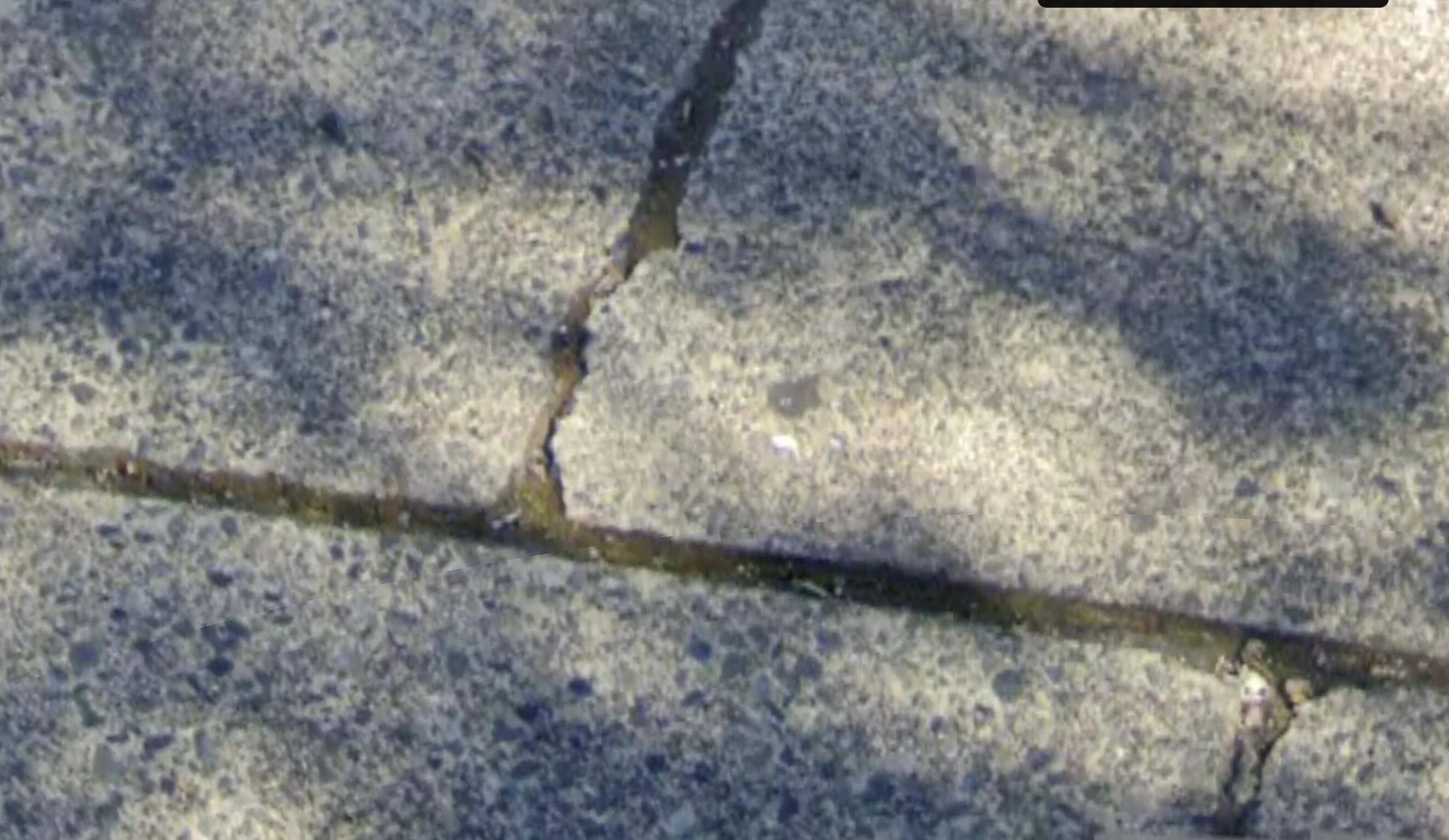

You guys need to institute a nationwide safety campaign to educate your employees about the dangers of using a rolling floor jack on rough surfaces. A floor jack needs to roll under the car while the car is being lifted, but it can't on a rough surface which is why it slips off the car. In addition to generating a vehicular damage claim, it could also seriously injure an employee if the car fell on them. Which is why it should be addressed proactively.
Ford Mustang Mach-E Improper jacking by Discount Tire AF1QipMtyRgf8dmHUHL0qJNGzE1rN6A-1XrjGe519tes=s1536
Ford Mustang Mach-E Improper jacking by Discount Tire Screenshot 2023-09-07 at 5.31.39 PM
The store in question appears to be using floor jacks on a rough concrete apron, which was likely the cause of the incident.
As far as I'm concerned, every floor jack at a Discount Tire should have a warning sticker that says "Do NOT Use Jack on ROUGH SURFACES" and all employees should be trained on why that is improper use.

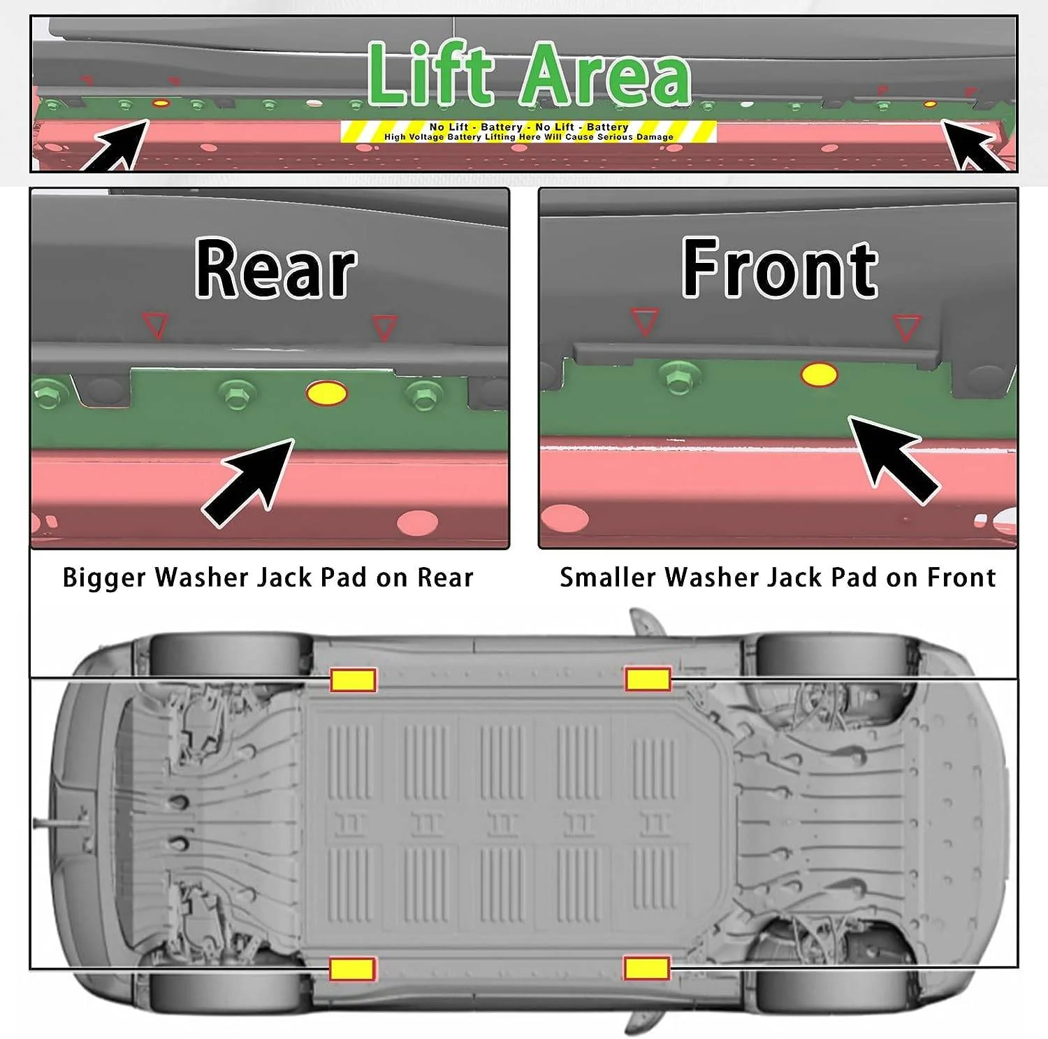

its sucks to see this from happening!:mad:
We made this image(the bottom one is borrowed from Ford) as part of the instruction on our Jack Pad product. i think Mach E owners could print this image out and hand it to the tire store or auto shop to prevent cases like this from happening again.

This is a very important topic and I want to confirm everything. I have purchased the "LIFT HERE" stickers and the Corvette pucks. I placed the stickers between the arrows pointing toward the lift point hole. Is that correct? And many on the forum have placed the corvette pucks permanently, yet these links say do not leave them on permanently. Please confirm I have the right information and placement. Thanx, y'all.
