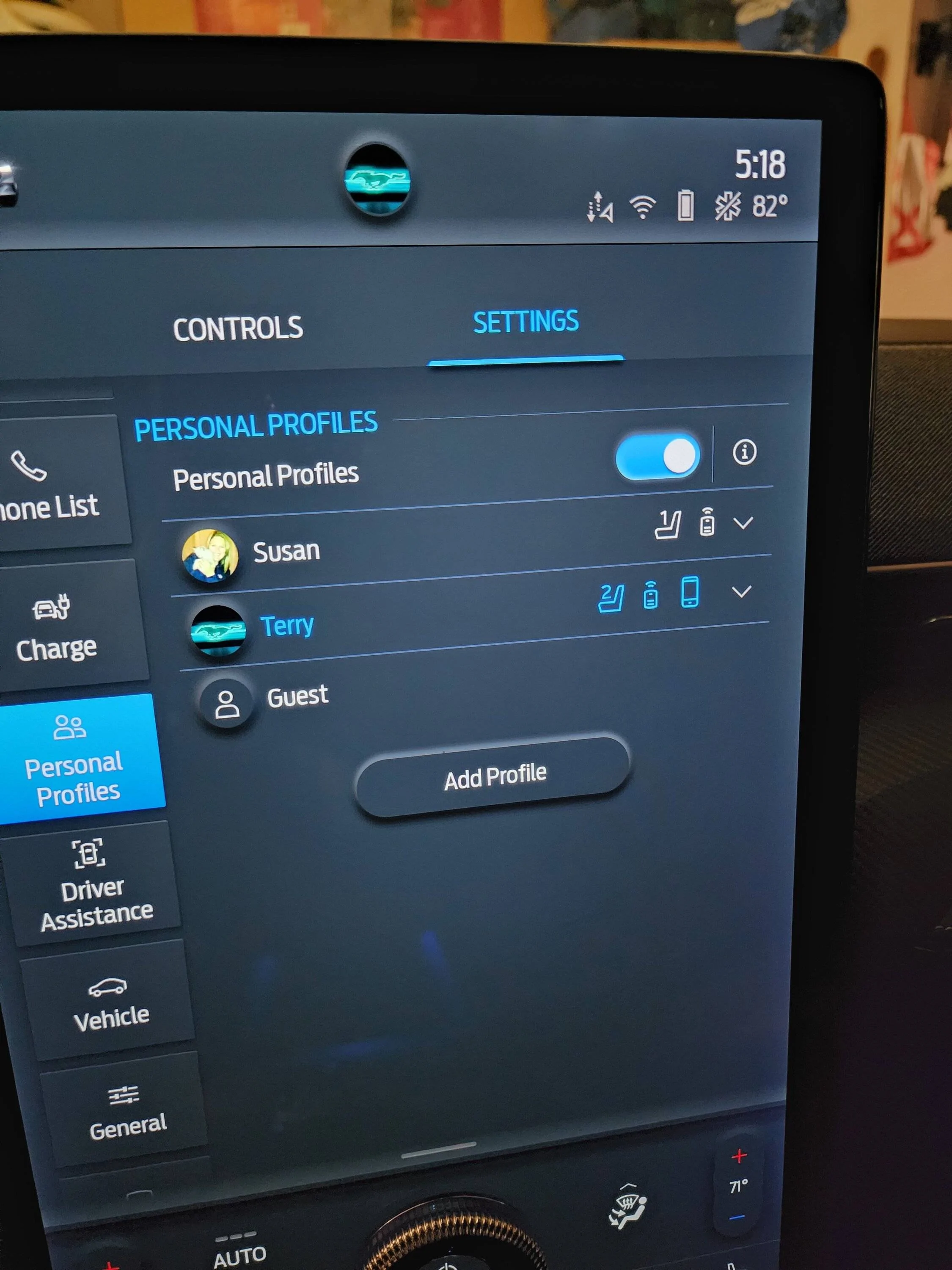

Yep! Under the profiles screen, my wife's shows a fob assigned to her, and mine has a fob and my PAAK assigned to it. I originally thought perhaps my assignments got "forgotten" by the car but nope they are still there.
It should be working! I can show my screen later when I get around to it as well.
Pulled up our profiles to show the settings that I believe to be correct, while the car's behavior isn't.
My wife as profile1 with one fob assigned; me as profile2 with one fob and one android phone as key assigned:

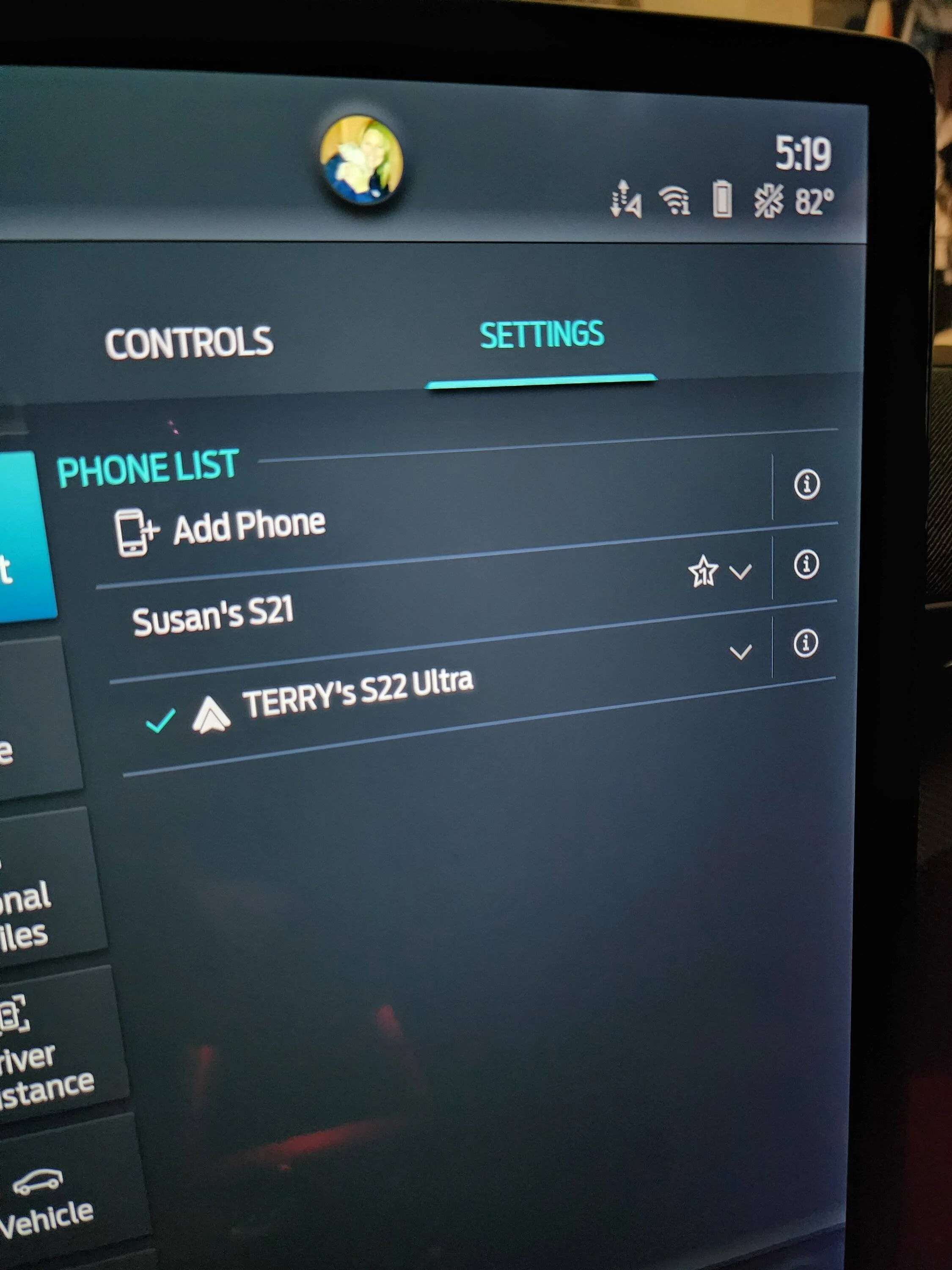

Switched to the wife's profile to show her phone is favorite (mine is currently connected though):
Ford Mustang Mach-E Inconsistency loading driver profiles? 20220809_171911

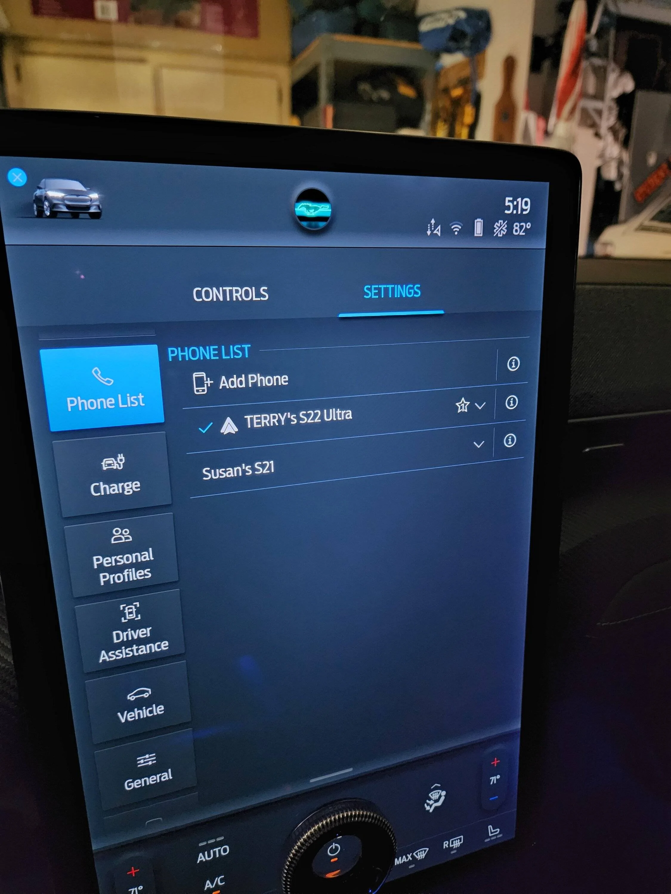

Switched back to my profile to show my phone as favorite:
Ford Mustang Mach-E Inconsistency loading driver profiles? 20220809_171943

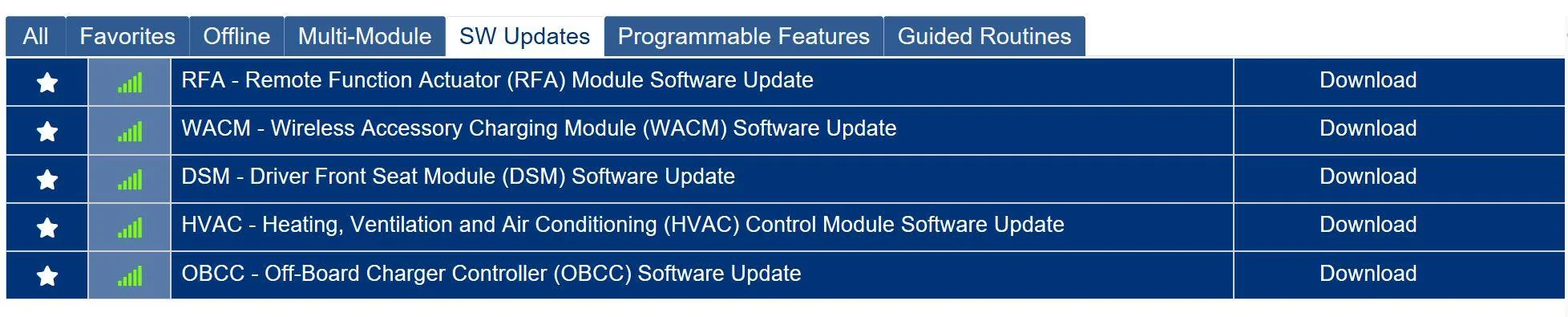

Damn, not an easy one. Had another idea! Since you have a newer car like mine I am assuming we likely have the same pending updates. I am curious if the DSM Driver Front Module Update would help with the issue you are having. I would assume that module is tied to the profiles. My wife doesn't drive the car very often so I don't experience the problems you describe above.

Sadly I was told these updates are no OTA yet. I took mine into the dealership to have a few of the updates causing problems for me installed.....day two at the dealership and the car has not moved

As mentioned above with the software, I also have the DSM update and hope to update these soon (and hope the DSM update will fix this) with FDRS as soon as I get the plug.
Don't count on those updates being OTA anytime soon.
