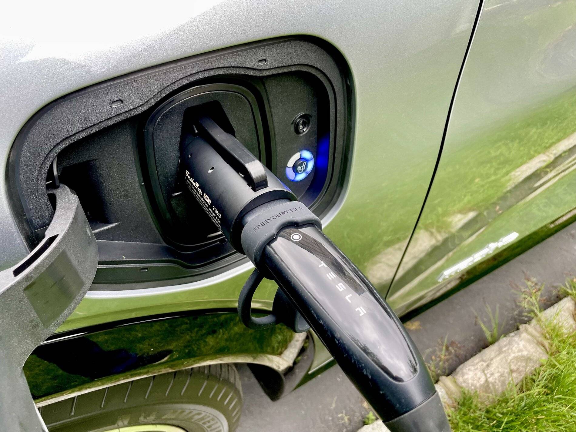

Mine was damn loud.
I ordered a MY tesla until Elon decided to scrap radar, so I got a Mach-E overnight.
Use a Tesla Tap with my Tesla Wall charger and it'll charge the thing in 3-4 hours, but it sounds like a small to medium data center in terms of cooling
Had two people ask about it, told them unless it starts beeping or smoking, it's likely normal.
Level 2 on a Tesla Charger gives the same cooling that I get at a 50kW DC quick charger.
