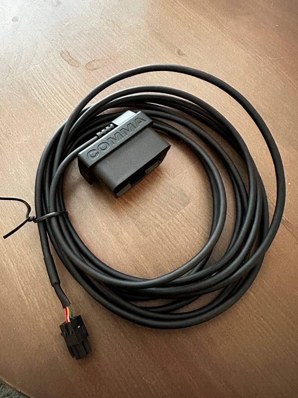

Looks like Comma have updated their OBD2 harness, it’s about 8ish feet long, no more RJ45
I’ll have to check to see if will work.

Interested to see what we can do in Mach E. You can always omit it. The device works fine without the ODB2, it just powers down between drives.
Worse case I’ll slice it and extend it
Update:
It looks like ATX 4 pin cable might work. I’ll order one today
