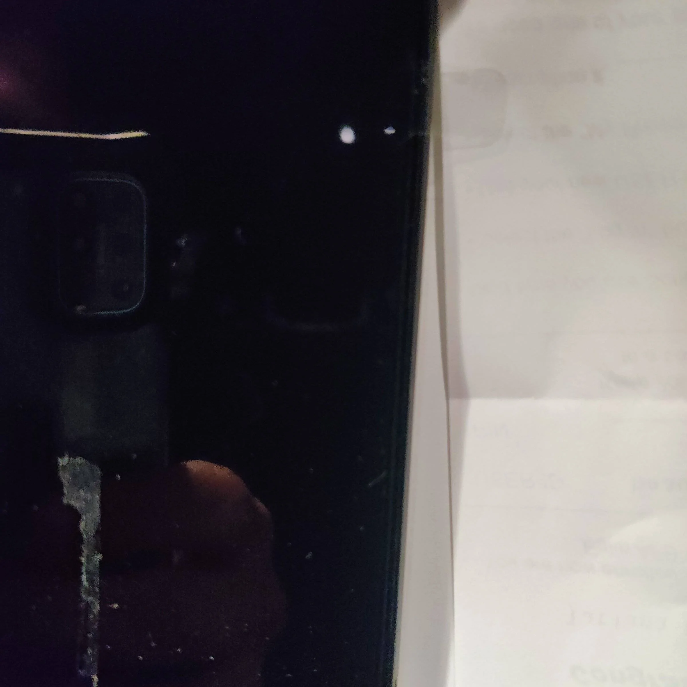

Afraid to comment, one year and one month anniversary with our EVPONY and no issues. Well except still no Blue cruise. Hopefully the GT being built on the 18th will have it. I do see a commonality for all who have had minor issues; they've all removed the plastic film protection on both screens. I think it's more important than people realize. Luckily my wife has not let me take it off.
