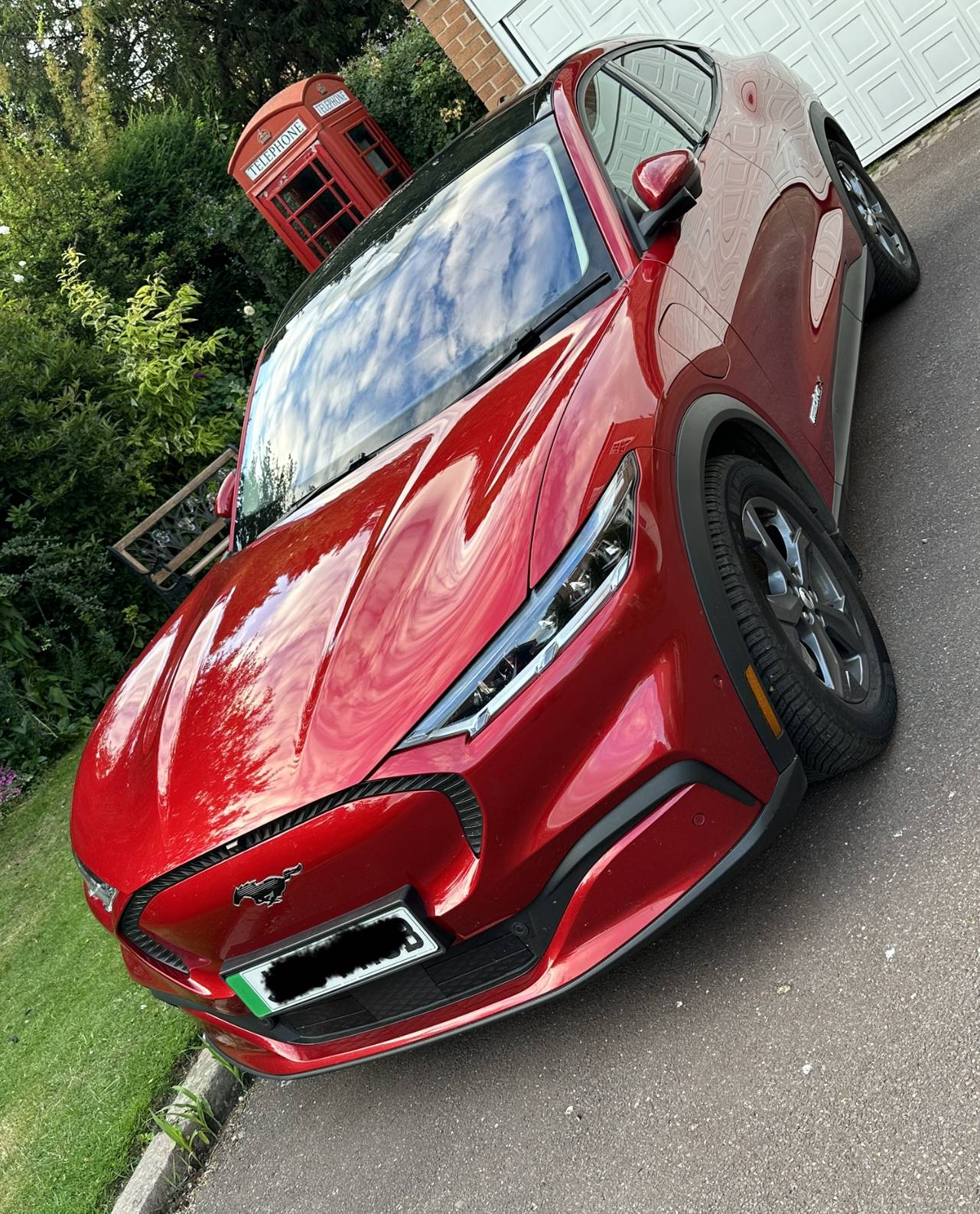

“Don't worry about charging to 100% when you need it”
This!
I virtually always charge to 100% at home because when I need the range I need it!
Or the crap about “possible” 379 range is a “possible” 330 range at 90% charge and in the real world, the realistically achievable 320 summer range and 220 winter range becomes 280 or 180 range respectively at 90% charge when the car would find itself on Autotrader ?
25% of my charges are out on the road at rapid DC charge points, often just adding 10s of miles to ensure I get home, sometimes to 80% and rarely and only if nobody’s queuing beyond 80%.
The car works for me, and boy has it worked for me over 63,000 miles &26mths fully loaded, I certainly don’t work for it.
Its HV battery SoH is currently 95.5% after 26mths with which I’m happy because I doubt there was ever a 100%.
Amazing car, drop-dead gorgeous and works like a slave for me.
It’s probably only worth £28k but I reckon I wringed just about every penny out of it.
Amazing value for money.
The love for the ‘Stang remains unconditional ?
