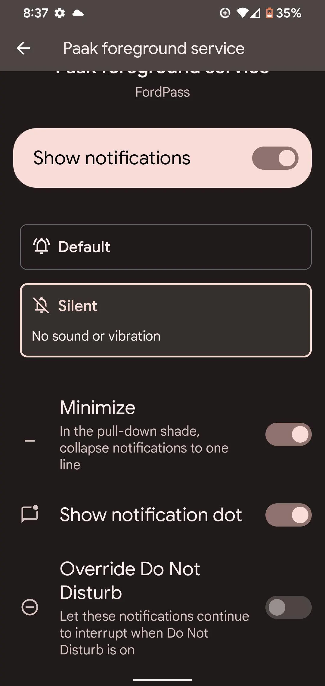

And to be honest I'm not sure how I feel about this discovery.. it's nice that it's reacting faster, but having this present all the time is going to drive, OCD, dramatic me insane:
You can minimize it without hiding it.
Ford Mustang Mach-E Is PAAK really good now? Screenshot_20220215-203734
Makes it better.
