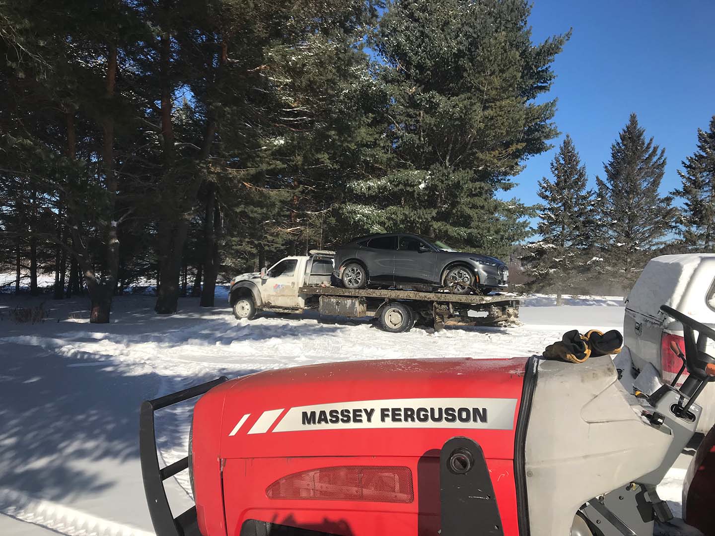

First time after that it was rescued with a 12V charger (Feb 2021). We knew about tow mode was -28C and needed a space heater in the cab to warm up the monitor, dragged it up backward by the wheels no problems or lasting repercussions that I have noticed. Think we are too late to learn about these new ones? The guys here have done a sobdmc and a hvjb box and have been good. Appears I am their training vehicle.
