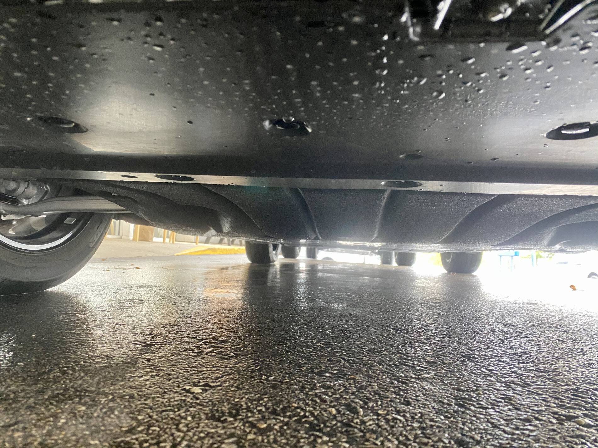

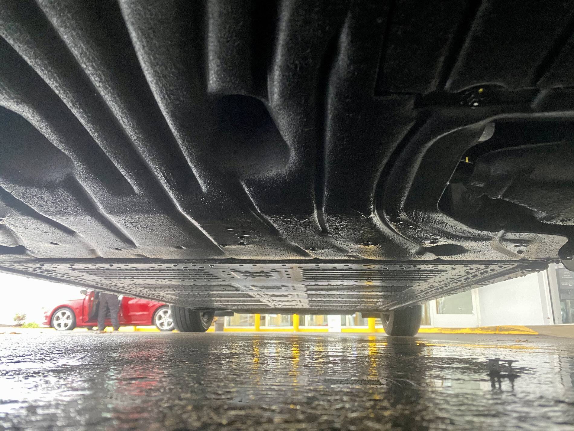

Either inside that little bumper port, or, perhaps one of those magnetic underbody secret spare key storage thingies.
Spots like these are hard to find in cars with so many non-ferrous metals and plastics and aerodynamic undercarriages. We'll have to get creative.
I was thinking about that. But is the large flat undercarriage area not made out of steel, then? Yeah, might need to get creative, or maybe use the old zip-tie method somewhere.
502
14,316
28,672
No, most of the bottom seemed to be non-ferrous materials. I didn't do a thorough check, though.
