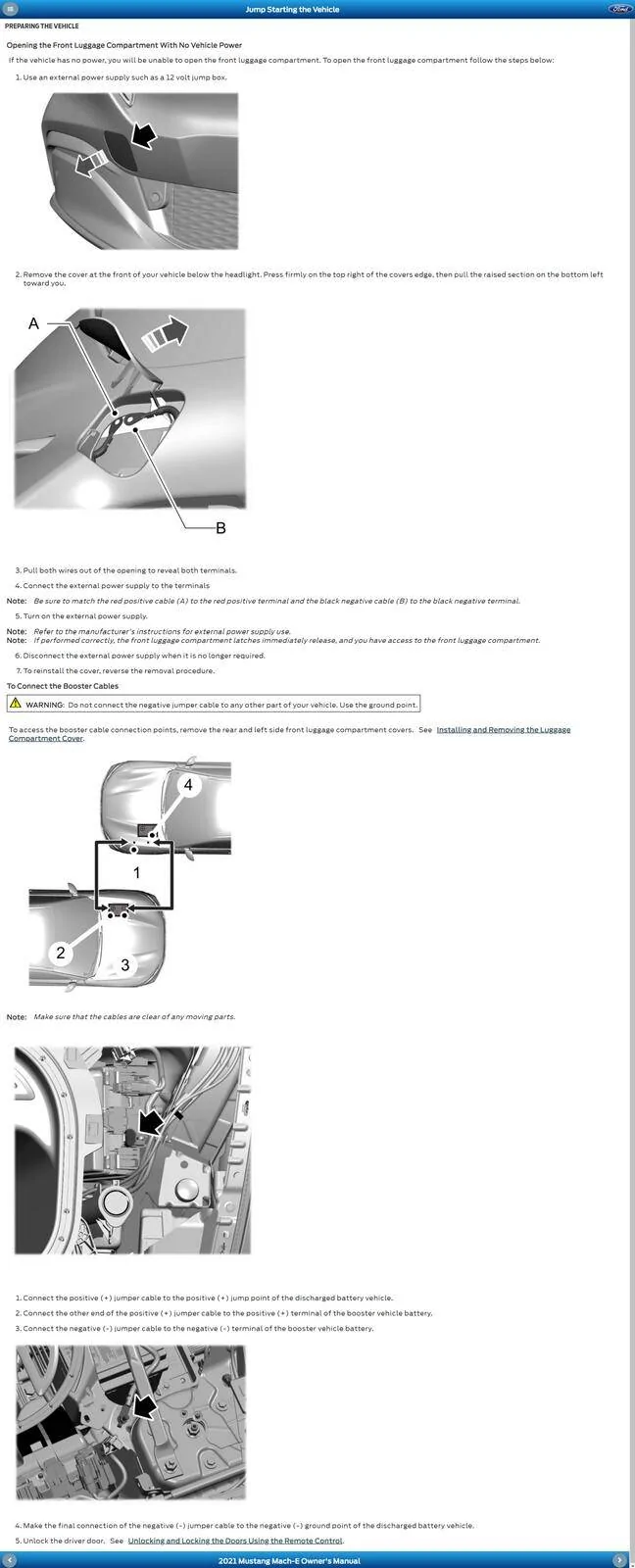

I was reading through posts on the drained 12v battery this morning, and found most of the replies seeming not understanding how to jump start the vehicle without opening doors or opening hood or opening covering inside the hood.
And here goes the guide in Owner Manual, that it shows where to find the wires easily from the front bumper cover as bottom pic shows.
Hope it helps!

I don't think the issue was that people didn't know how to do it. The issue is that it's a PIA.
Those wires don't jump start the vehicle, they just open the hood. It's not possible to jump the vehicle without opening the hood and removing the rear and left side panels.

You need to re-read those instructions. Applying power to those wires ONLY enables opening the hood. In order to jump start the vehicle, you need to open the hood AND take the covers off in the luggage compartment to expose the battery positive jump start terminal and apply power there. Removing those covers in the luggage compartment is not that easy, as @ChasingCoral has mentioned.

Thanks (and welcome to the forum!), but as others mentioned, this will not jump start the vehicle. Those terminals exist only for popping the frunk; you can't jump or charge the 12v from there.
Of course, this begs the question, why not? Ford went through the trouble of putting those wires there. It sure would have made life a lot easier if you could just jump start the car with those wires. You wouldn't even need to get into the frunk.
WARNING: COMPLETE SPECULATIVE GUESS FOLLOWS
it's likely due to the size (gauge) of the wires and the current load expected in that scenario.
