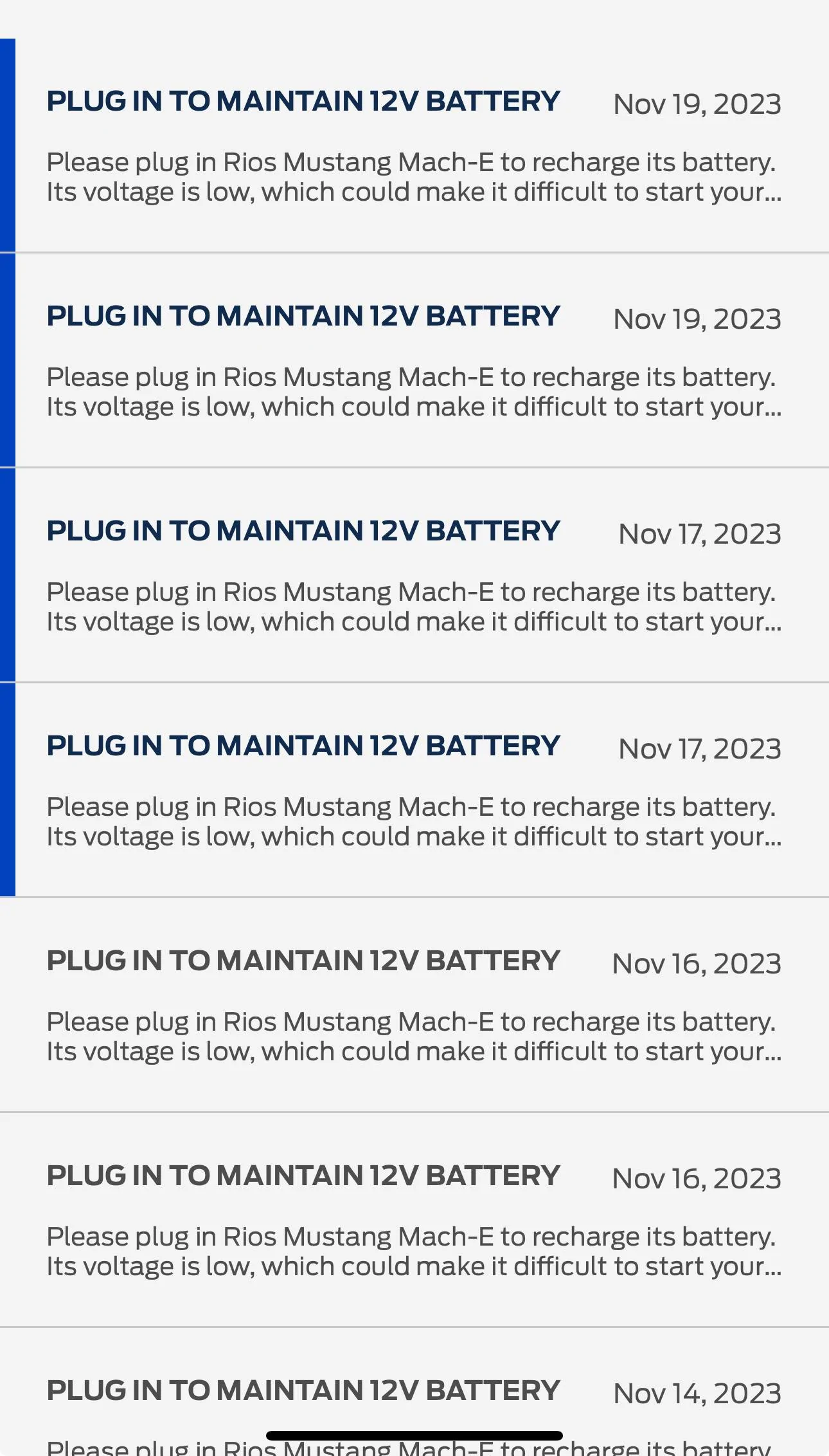

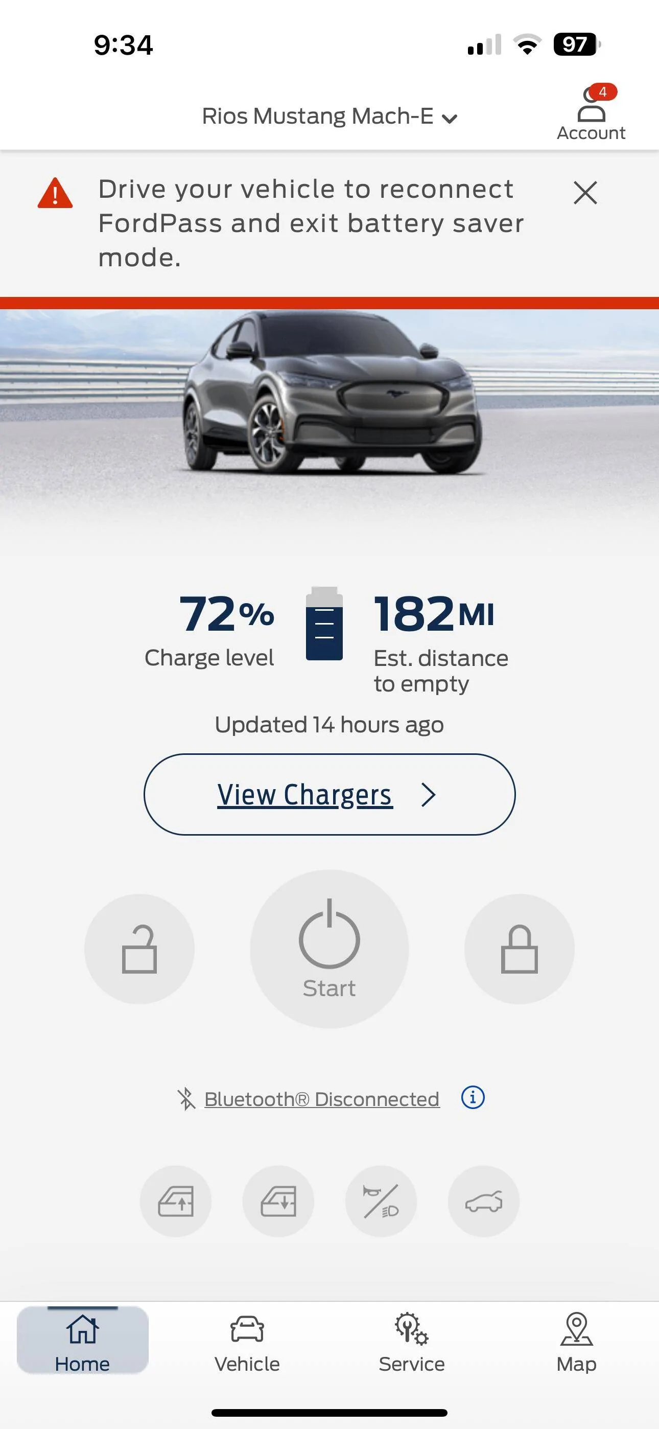

I get the dreaded 12V fault all the time too. Dealership has no clue why and says the battery is testing good.
And just today i got this new message that i had never seen before.
Was just thinking the same as the dealer regarding these messages because they are counter to the way the DC/DC converter, which is effectively the HV/LV charger, actually functions.
Is this more likely to be false messaging, misreporting something which doesn’t actually exist?
