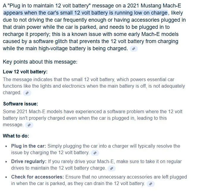

I have 2022 Premium AWD Mache with 43,000 miles and it is approaching three years in age. I keep getting error messages on my screen and my phone that say "Plug in to Maintain 12 V Battery" even though the car was plugged in and charging overnight. It seems to be worse on colder nights with temps below freezing. It seems that when I plug in to charge the main battery, the 12V battery does not charge. I try to always make sure to set the head lamps from Auto to off when I leave the car as I heard leaving the lights on Auto overnight may drain the 12V battery. It seems like something is draining the 12V battery when the car is off. I drive the car at least 5 to 20 miles just about every day.
I did a google search and found this article. Does anyone know if there is a scan or software update that will correct this issue so the 12v Battery will charge overnight? Should I replace the 12V battery after 3 years? The car is no longer covered by the 3 year bumber to bumber warrenty, so I am hesitant to bring it to the dealer until I have a better idea of what needs to be done to correct this issue.
Thanks. I appreciate any advice you can share, especially from someone from Ford.

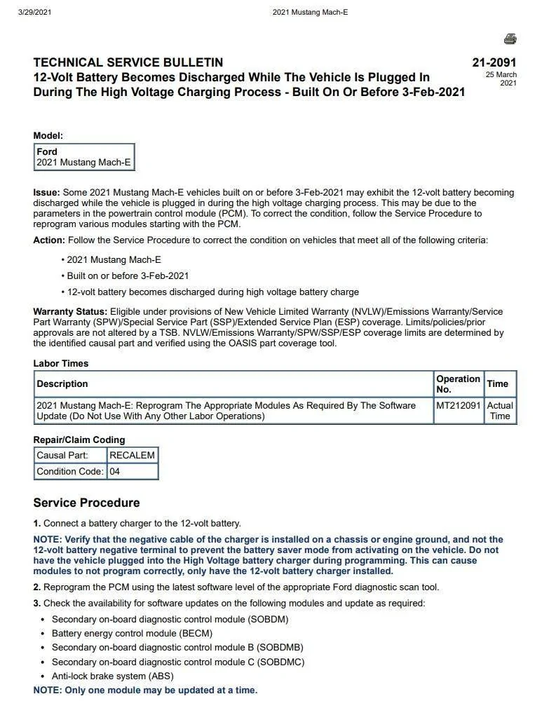

Great, thanks. I will have the 12V battery changed.
What about TSB 21-2091. Should I have my local Ford dealer do this or leave it alone. I purchased my car in February 2022.
Thanks,
Eric

Absolutely get the dealership to update any/all software updates that you can convince them to do for you.
And presenting them with TSB/CSP/etc documentation is certainly one way to get them to at least consider doing updates. (since they can be paid by Ford for doing so)

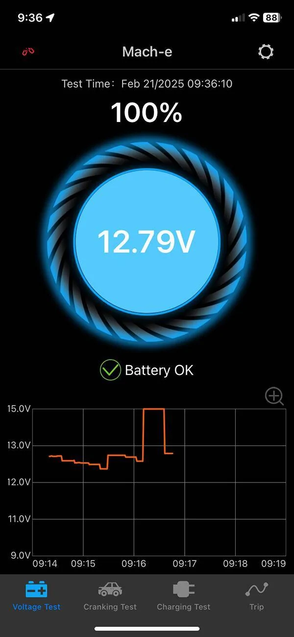

I also have a 2022 Premium. If you park in a garage you can do what I do to charge the LVB.
Every Sunday, or every other Sunday if I forget, I turn the car on and disable the automatic turn off option on the screen under the Vehicle tab.
I let the car idle for 12 hours or so and this keeps the LVB at a level that will stop those messages.
You can also install a battery monitor like the Ancel BM300 and then you will have the ability to see the state of charge of the LVB on your phone.

Here’s a screenshot of the LVB being charged by the HVB while parked. The app is from an Ancel battery monitor.
Notice the jump to 15v.
