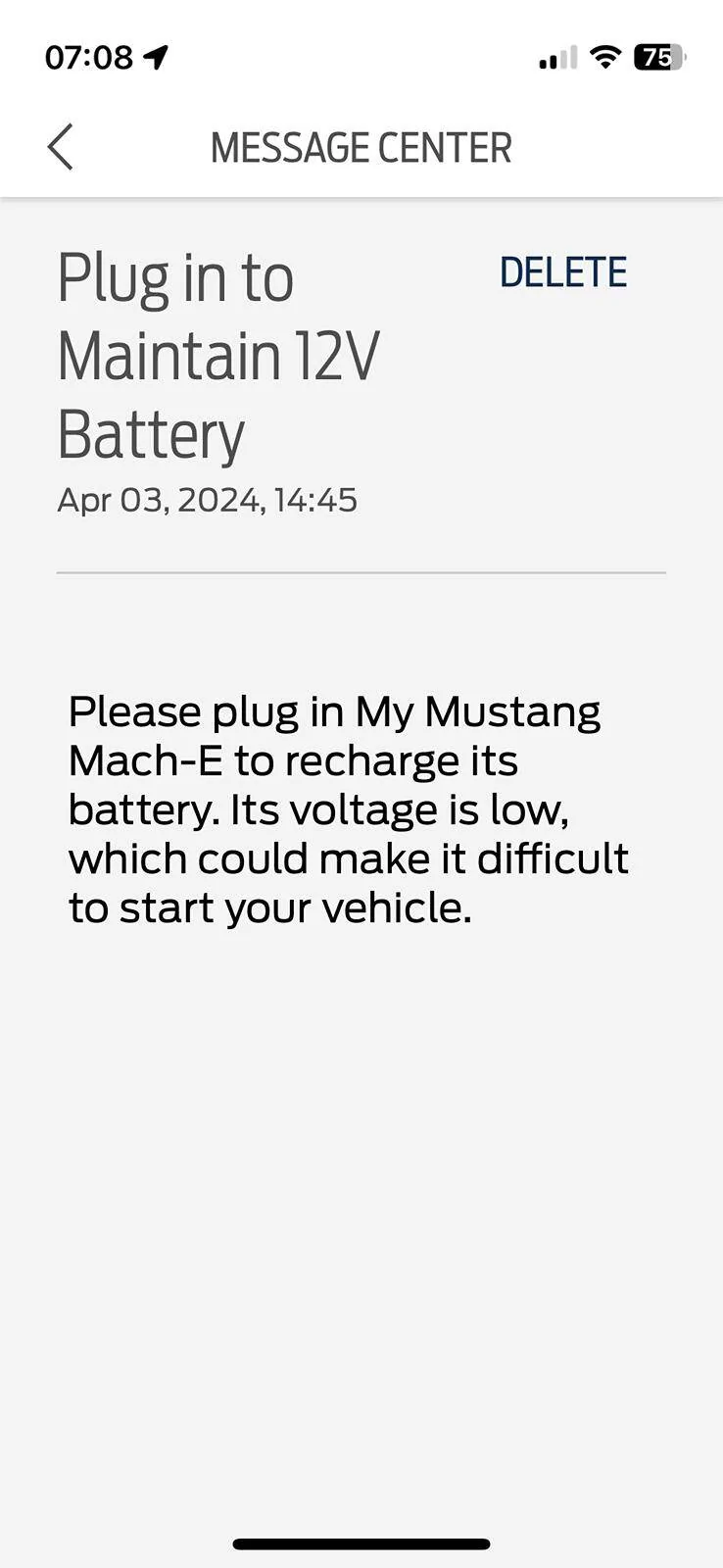

Checked 12V SOC on Ford website Monday (saw a post) and it was 90%. Yesterday saw the note about electronics shut down to preserve battery and today, I saw this message on the Ford app to plug in to maintain 12V battery. A quick check on the Ford app shows 12V is down to 60% (maybe due to it installing 23-PUM3-UNX-DC ?‍♂) while HVB is 76% (charged to 85% Monday).
My question is plug in what, the 12V? My understanding from the owner’s manual and the FAQ section here is that in my situation plugging in the car would only charge the HVB. Is it telling me to remove the frunk and connect a charger to the 12V?
You could do that, and it would work to solve your problem.
But it's probably more trouble than it's worth.
The FordPass message is telling you to plug into an L2 charger, and during that time it will use the DCDC to also bring up the 12V SOC.

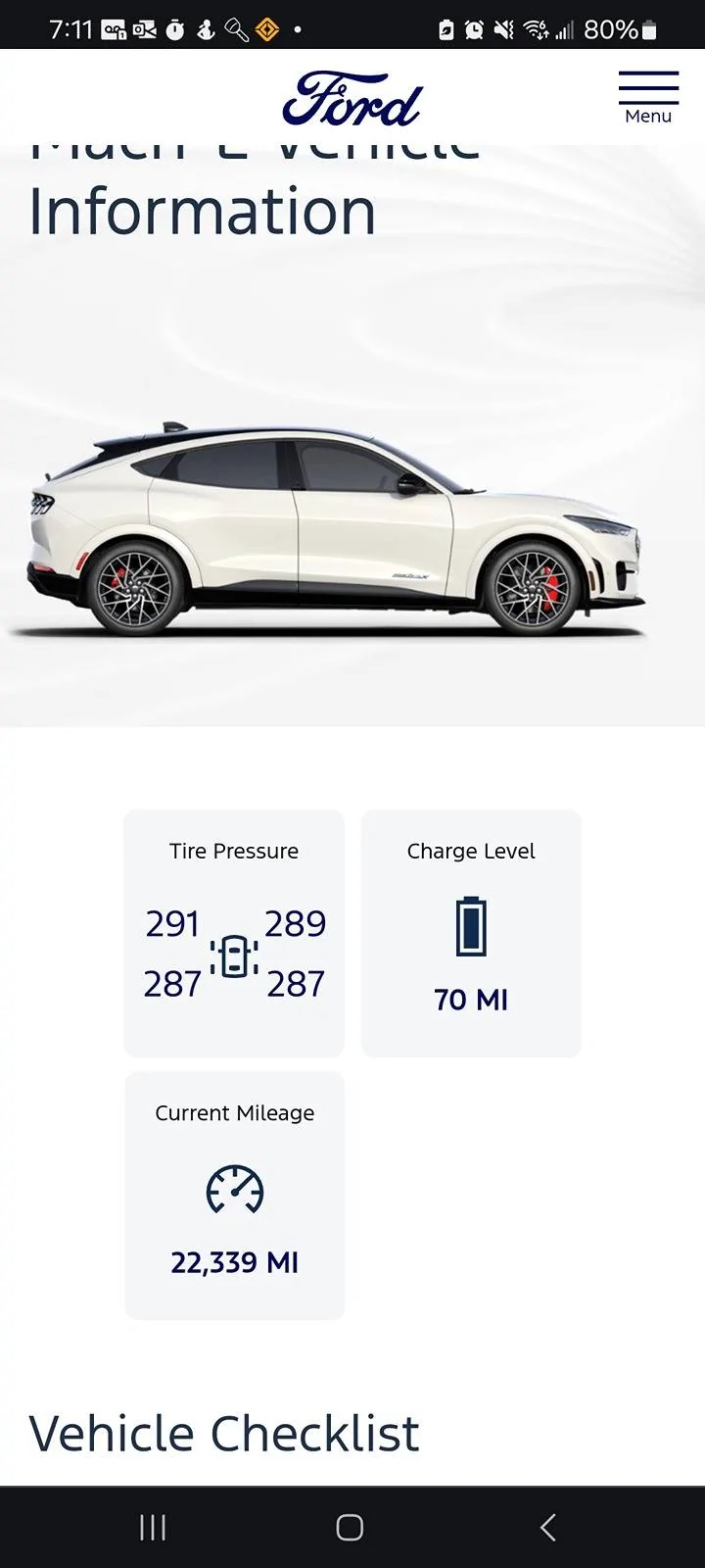

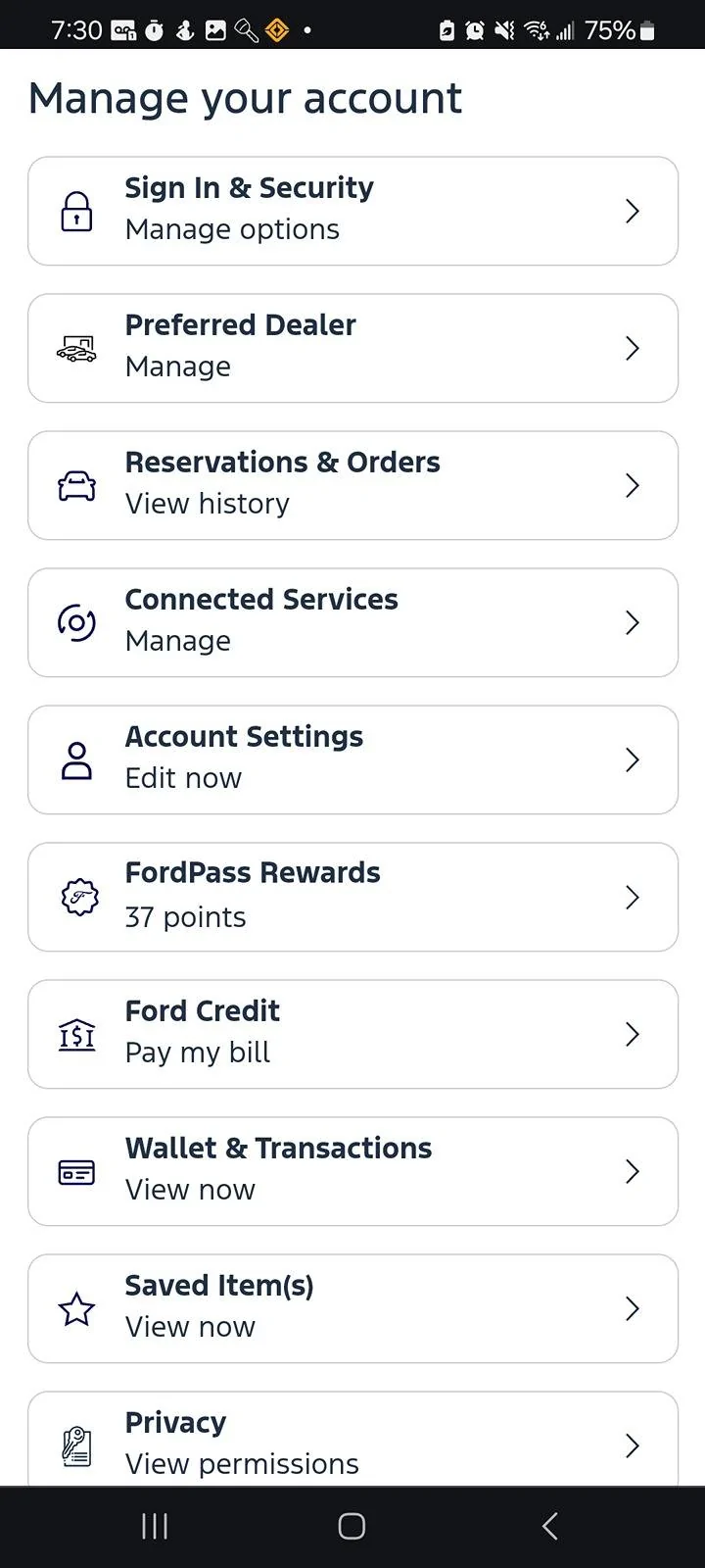

I keep getting same message. I can't find the % on ford website. Simewhere else I'm supposed to look?
Ford Mustang Mach-E Plug in to maintain 12V battery. Screenshot_20240405_071126_Chrom
