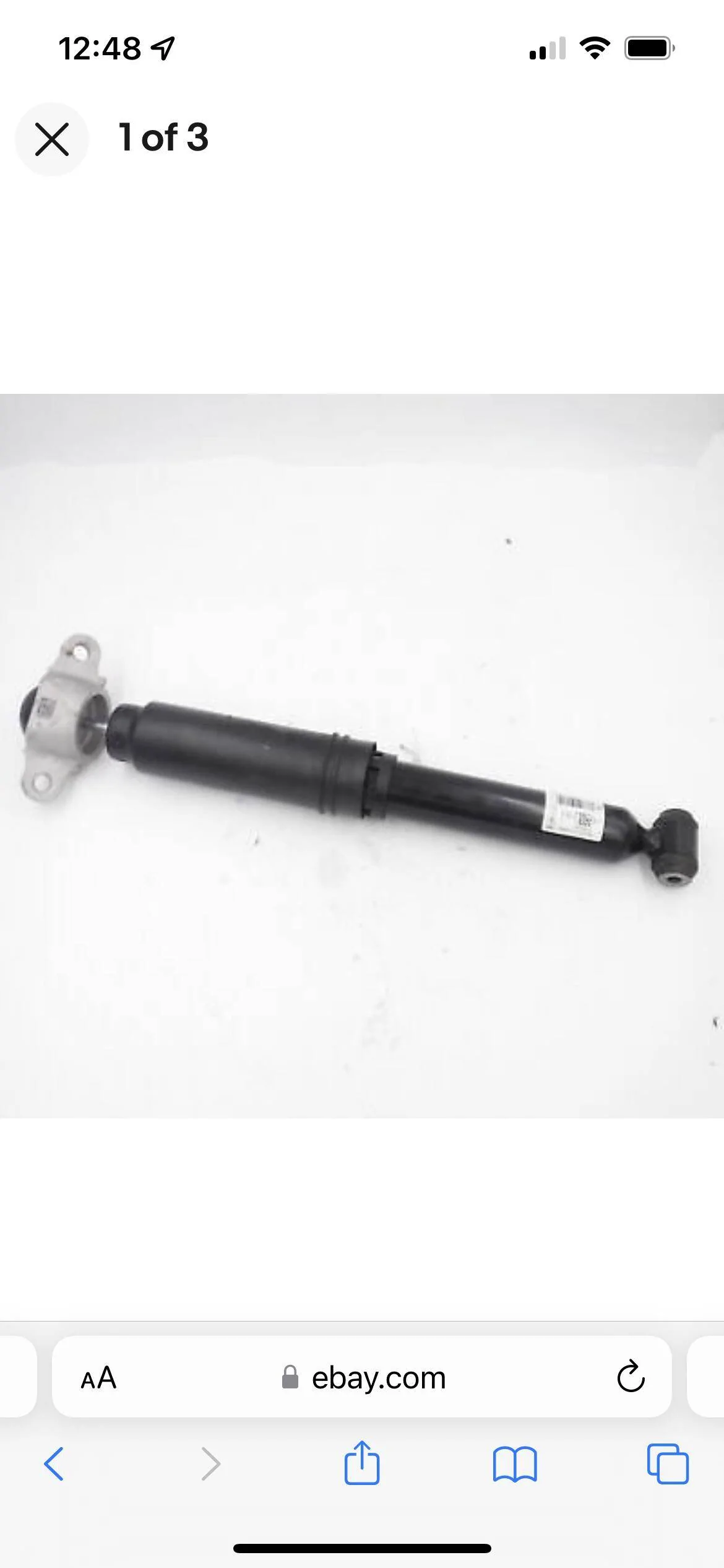

Edit: found a pic of the rear shocks.
Why are these so odd? Wish it had a normal single bolt mounting at the top.

As far as the rear shocks go, the top mounting support can be removed and possibly put on the other shock and the lower mount can possibly be altered to fit but the issue is the Aviator/Explorer shocks are longer than the Mach-E shocks because the suspension on those cars have more travel. It's not just "will it fit" but the length has to be the same.

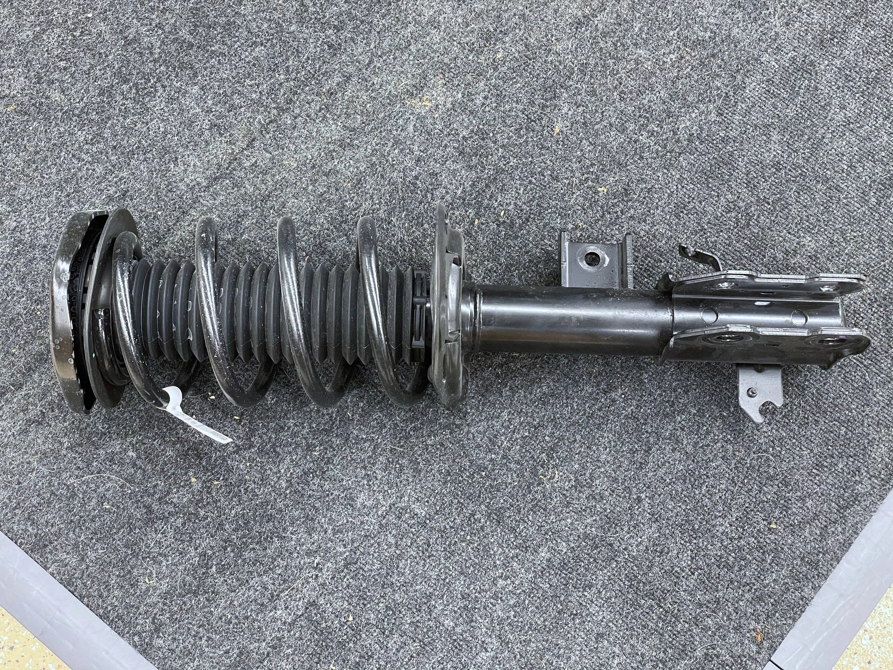

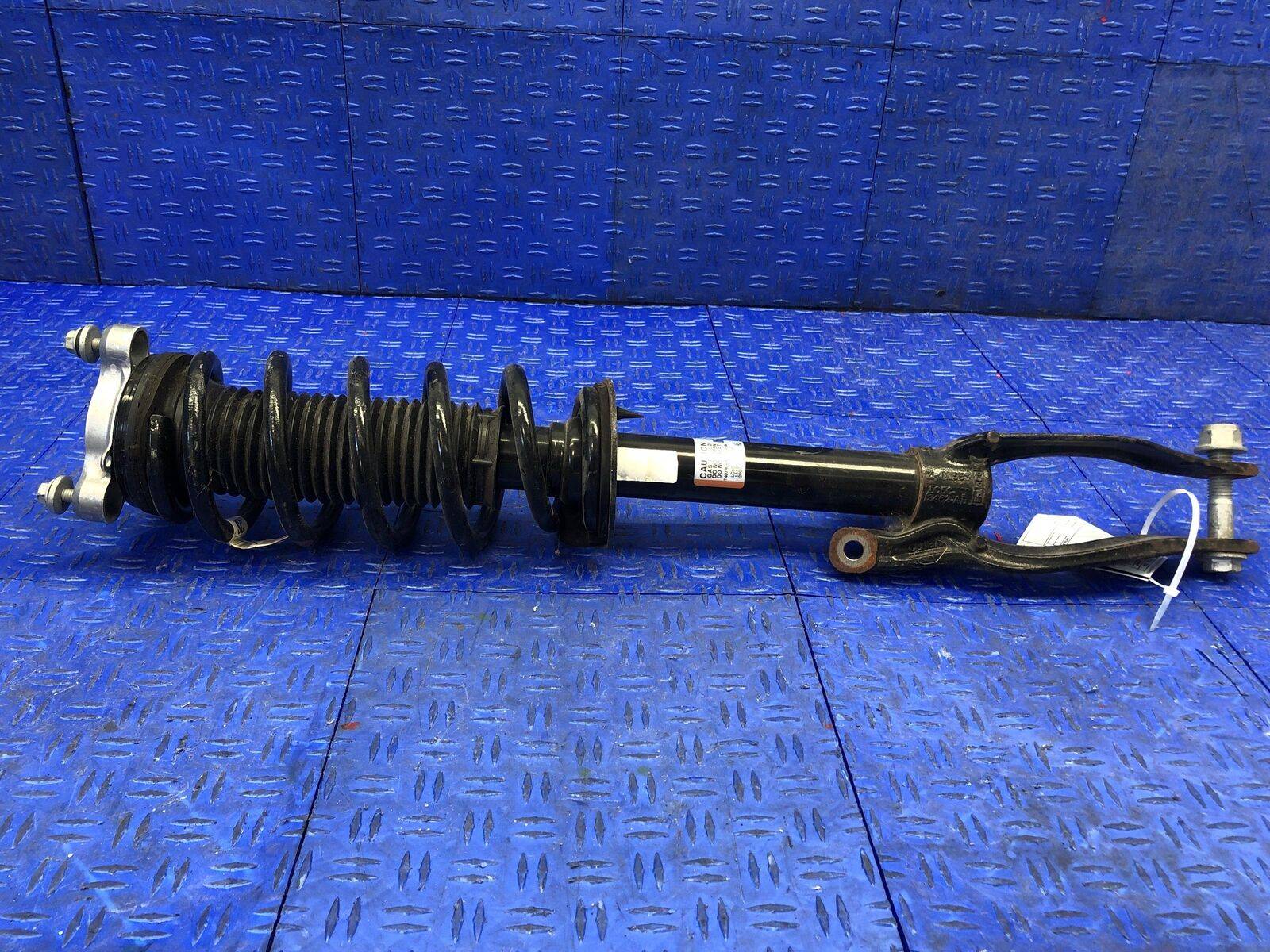

The fronts are completely different and again the Mach-E strut are shorter. Fist photo is an Aviator/Explorer front strut, second photo Mach-E front strut.
