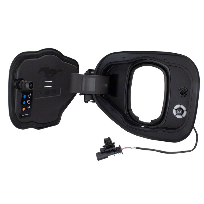

Turns out it was not the part and was the Drive Motor Battery Pack Charging port pocket. LJ8Z10370B
thanks!
That is the charge port door and surround, not the charge port itself. I don't see how the surround would cause a powertrain fault unless it somehow involved the wiring for the status lights or unlock button (which is dumb, it's just a status light).
Obviously the charge port door and/or low voltage wiring would not be covered by the EV warranty.

Completely agree. I don’t understand its connection to powertrain either.
Dealer wanted $1.2k in labor to replace. Going to DIY and hope it solves it. I’ll update in a few days
