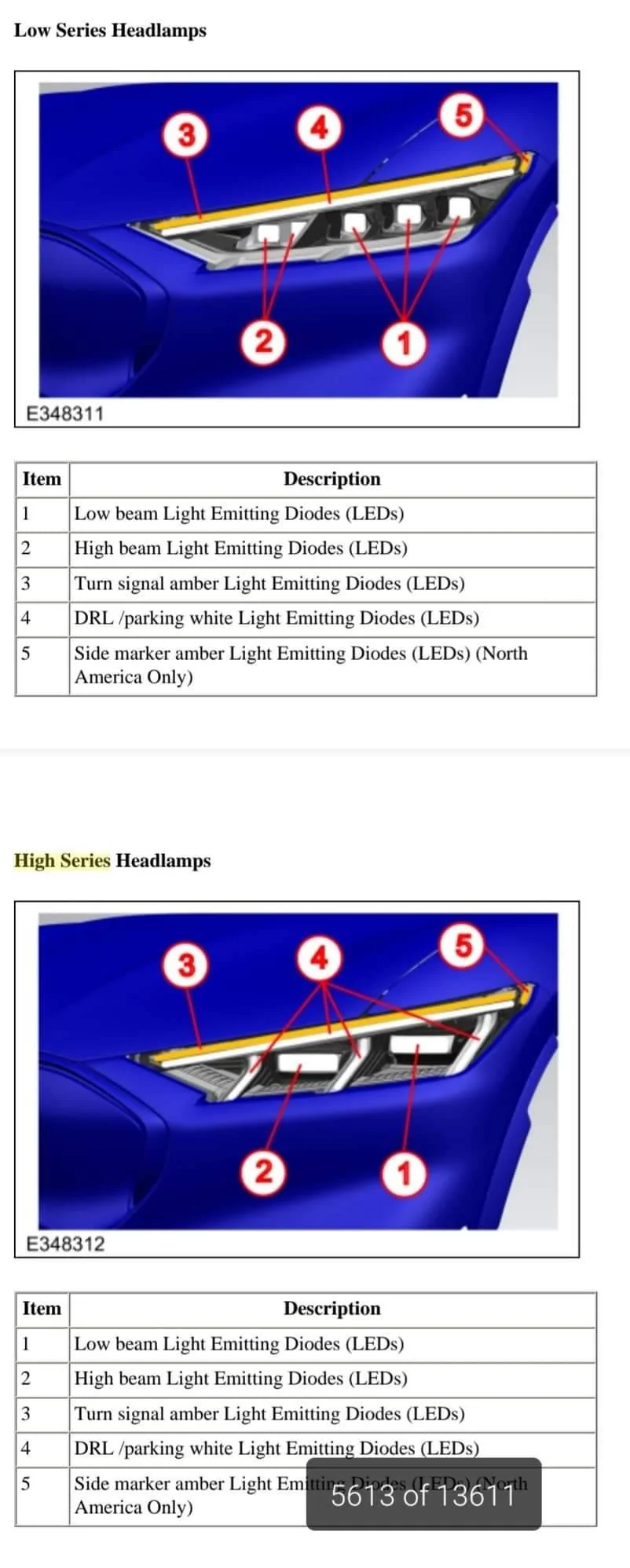

there’s another theory John has that will not require opening up the car. I’m installing an auto liftgate for another car this AM and will test his theory today as well. If this theory holds true then there’s really no need for a chart.
his theory has to do with the low/high series lighting. You see theres two different headlight styles. How can you tell the difference? Simple, but looking to see how your headlights are configure.
How'd the install go? I'd love to know if this theory works and save needing to go up to the BCM.
The latest install video didn't look like it would be too difficult, but why work harder..

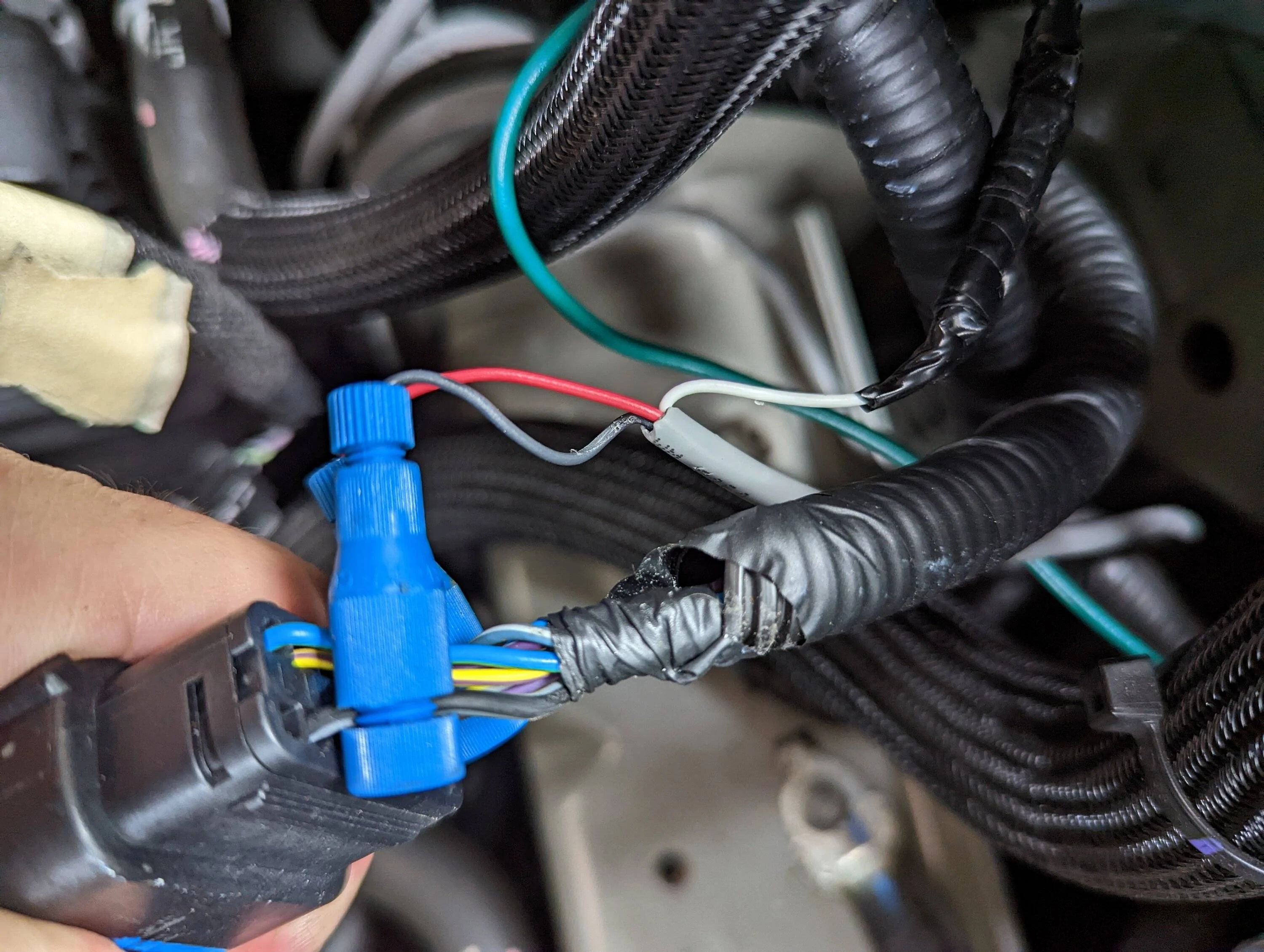

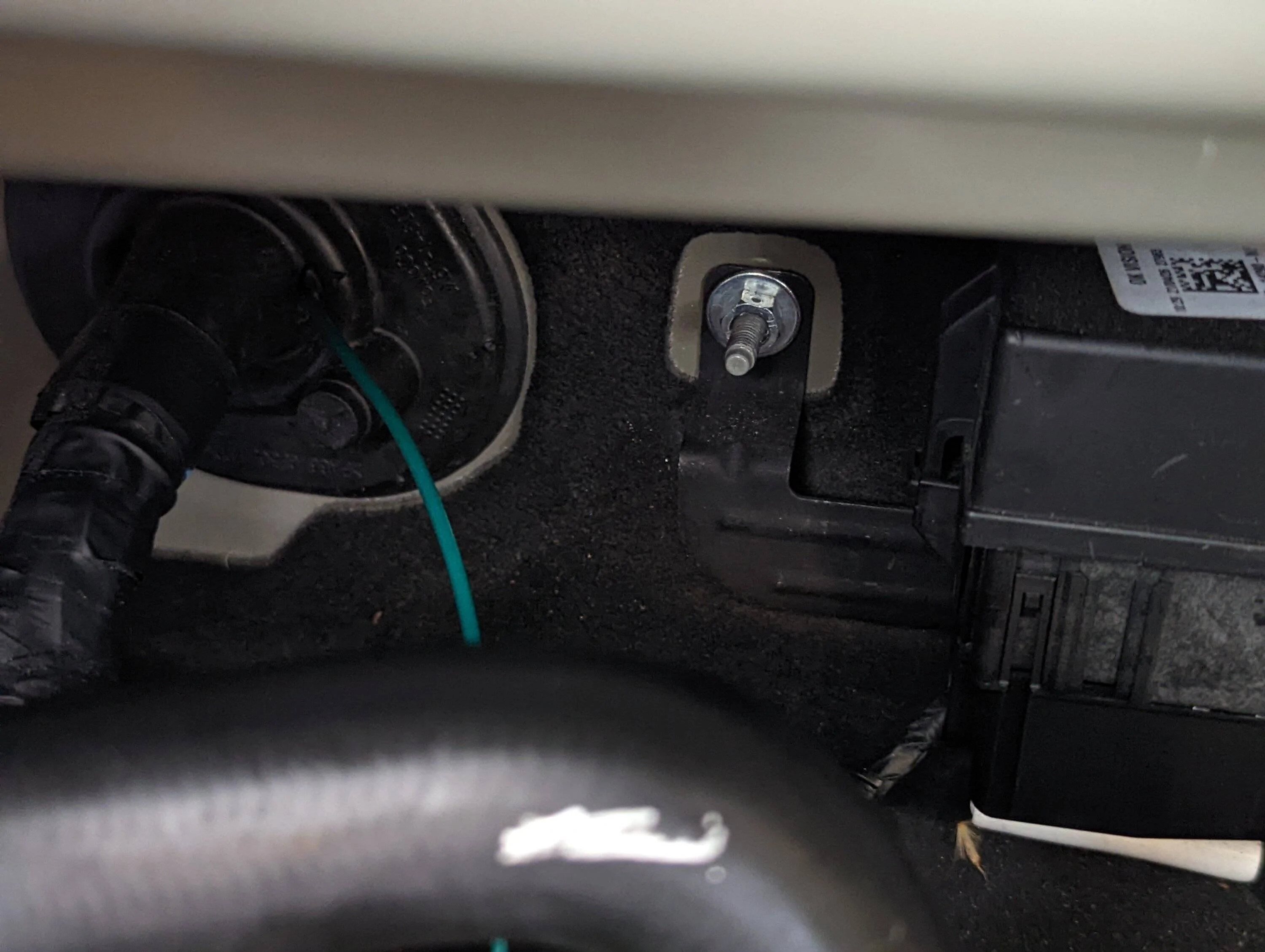

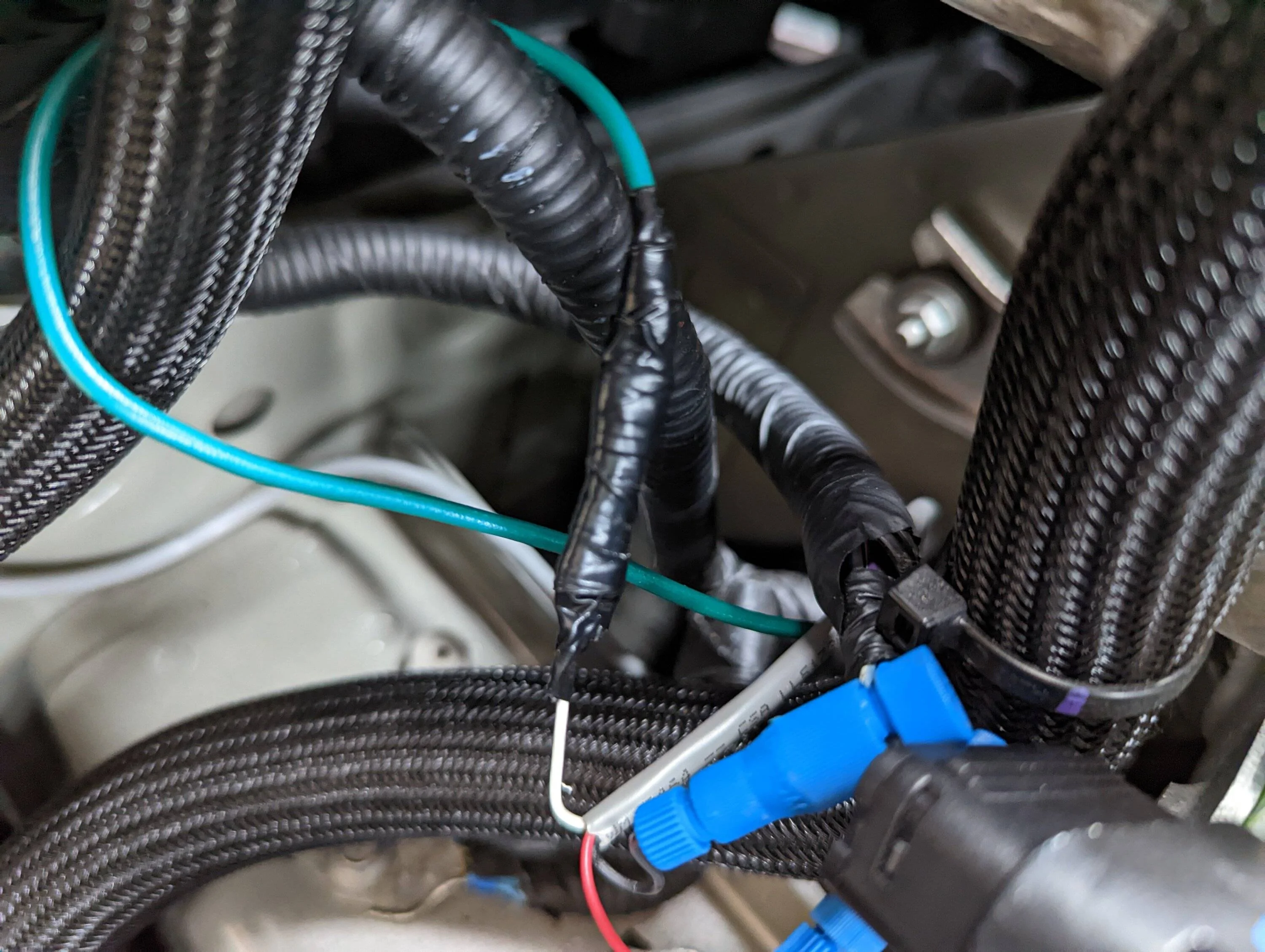

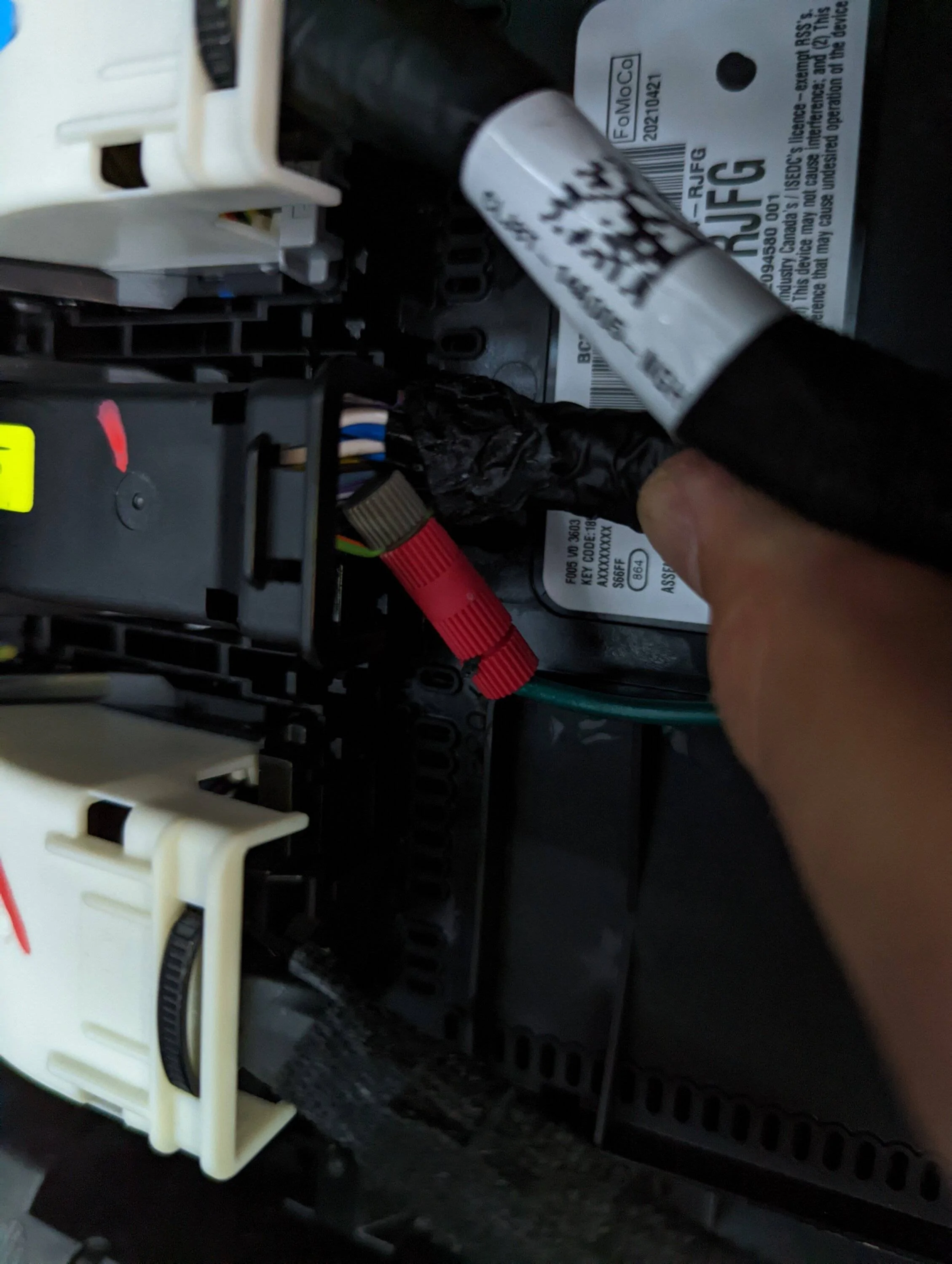

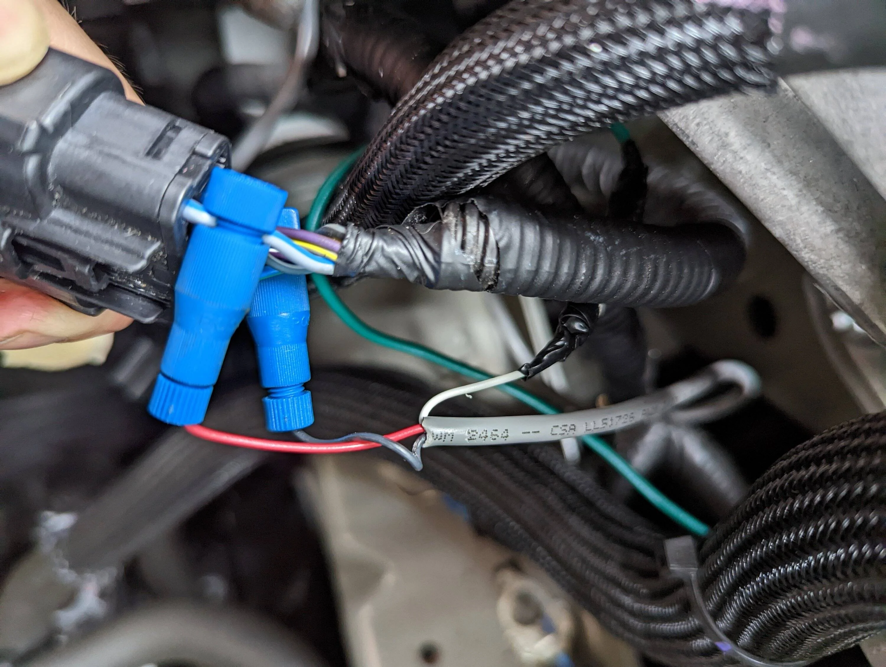

So, I did not have the patience to wait for an easier install and just thought I'd give it a shot.
The taps on the old pony did not work for me, instead I pushed the pony in as much as I could to try to get a little gap and was able to stick a small pry par in there and slide off the old lock washers. It wasn't easy but, it worked, only ended up breaking off one post... Not too bad.
The hardest part was definitely getting through the firewall. Not sure if this is correct, but in the video it looks like John punctures it near the top area, while this is the easiest spot to get too from the frunk, on the other side it's MUCH easier if you try make the puncture near the bottom.
I followed the passenger headlight instructions to a T:
Pony red to grey/blue
Pony black to black/grey
Pony white to green wire via butt connector, through passenger side firewall, and to green/orange on BCM..
unfortunately, it wouldn't turn on :/
It started raining so taking a pause on the project till it lets up... but I plan to check the connections on the Posi-Taps and butt connector to see if contact wasn't made somewhere once I can. Any advise?

Check that Ground Posi-Tap. It doesn't look screwed in all the way at the bottom. That's where I would start. But otherwise, looks like the wiring is right. Just check connections.
Also remember it takes about 5-7 seconds to power on.
Let me know if you continue to have trouble.

Fun (not so much) updated for everyone invested!
I think I may have possibly just identified why no doors will open on my vehicle, even after getting the battery charged up.
When my car died last night due to the battery drain, I did not realize till just now that the BCM was left unplugged! I know that's 100% on me.. between trying to beat the rain, not getting the pony to turn on, trying to keep bugs outta my car, and watching the install videos... it was a bit of a mess on my part. I'm about 99.999% positive an unplugged BCM would make doors, windows, etc become inoperable, regardless of state of charge for the 12v battery (John helped confirm this).
Word to the wise for everyone attempting this install, lower all windows and be sure doors DO NOT latch... Not sure what drained my 12v battery, but if anyone's concerned about drain, you could also disconnect the battery to prevent any problems there as well.
This was all through no one else's fault but my own and not a symptom of the install! Hopefully everyone has a better go at it than me, and John's been a great help the whole time, so have faith guys!
