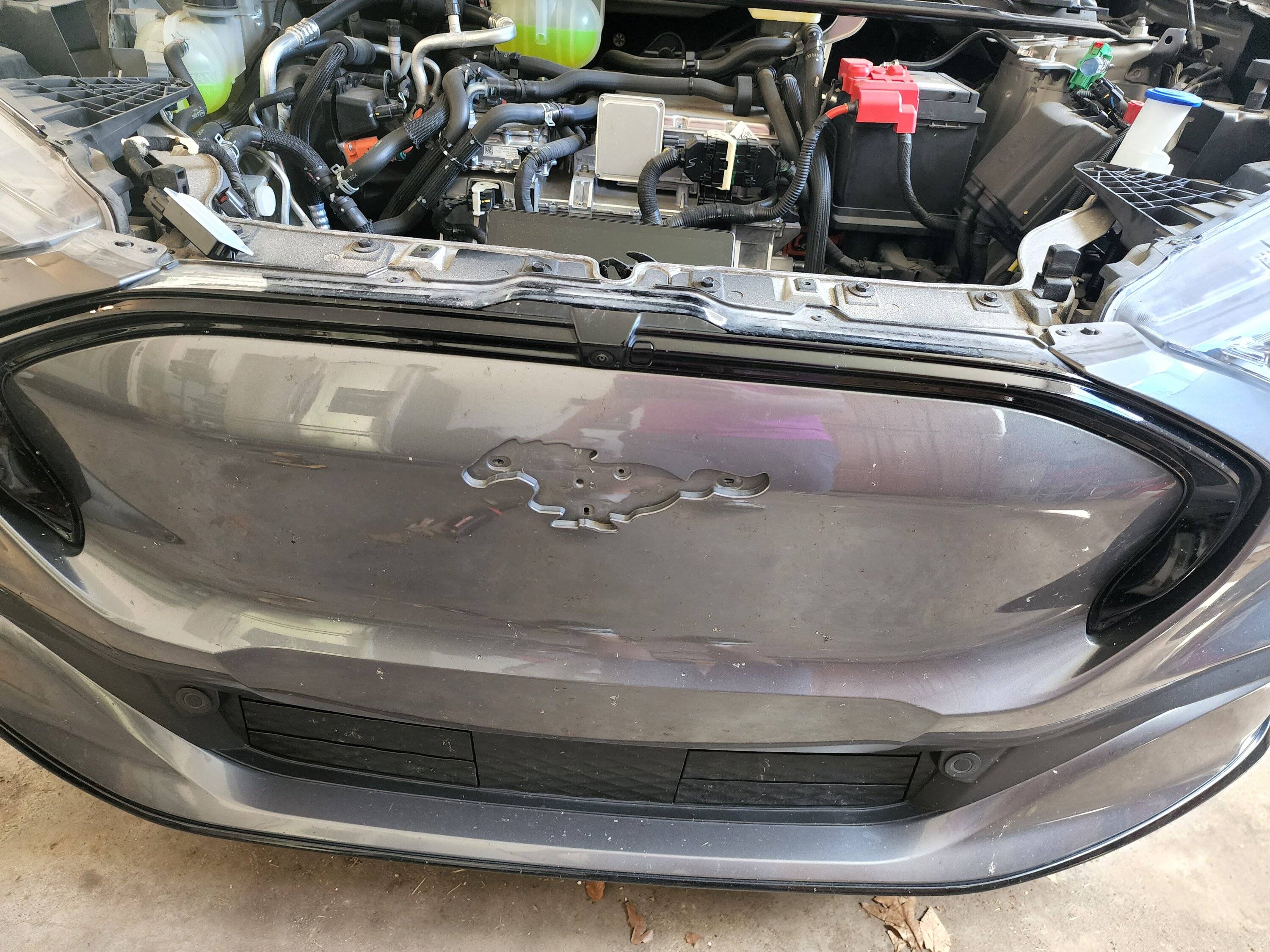

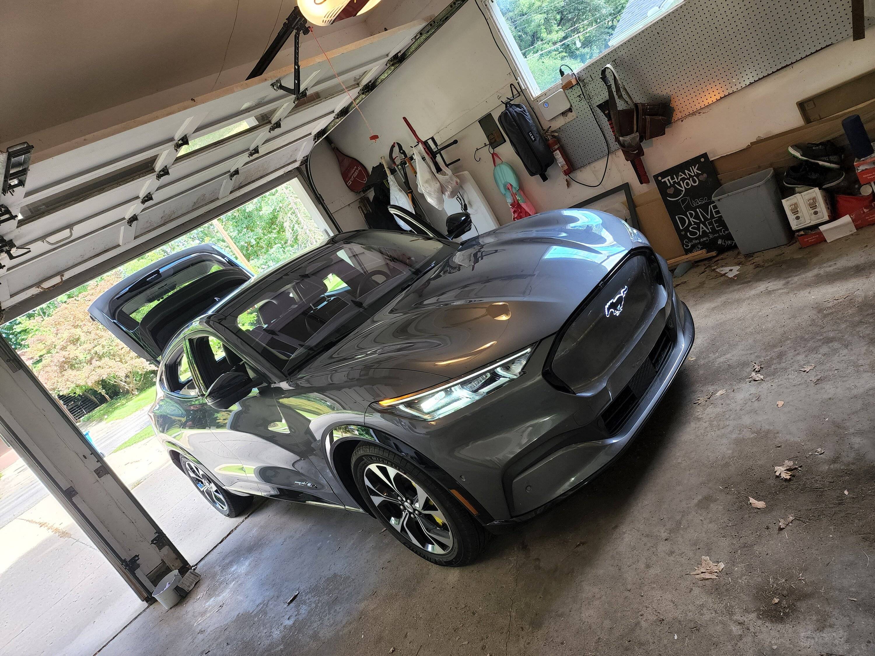

Completed mine in about 2 hours, went through firewall, looks excellent! I do wish the LEDs were frosted behind the plastic to refract the light a little more only because my 3 year old loved seeing it turn on when I showed her but her first words were: Cool! It has Polkadots! ?

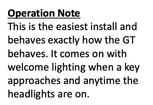

Ok... I'm confused about the different behaviors when wired to the BCM wire or always on.
From the instructions, the BCM connection does this:
Ford Mustang Mach-E Lighted Pony Project (back it!) Screen Shot 2022-07-30 at 9.19.34 AM
What exactly happens with the "Always On" installation? At about 3:12 in this video () it, John says:
"... the white wire turns on anytime you approach the car, and anytime the car is on, this white will turn on 12 volts..."
So what exactly is "anytime the car is on?"
-When the car is remotely started, or the start button is pushed?
-When you walk up to the car with a key or PaaK?
-When the car wakes up or is awake...independent of starting it?

The pony lights up anytime the DRLs are on, when you walk up to the car with the fob or with PaaK, when the car is switched on, and when the car is remotely started. Interestingly, I just tried remote starting my car while watching my security camera in the garage and the remote start failed like it does occasionally. Even though the car didn't start, the pony lit up for about 30 seconds and then went off even though no other lights came on. I tried starting it again and it started with the DRLs coming on along with the pony. I turned the car off remotely and the pony is still lit up, it will go off in 15 minutes like it always does. If the car is plugged in and charging, the pony will illuminate the entire time the car is actively charging, going off 15 minutes after charging is complete. Hope this helps.

Thanks, very helpful! Obviously, that white wire stays energized for a bit even though the logic for the headlight prevents the headlight from powering on.
