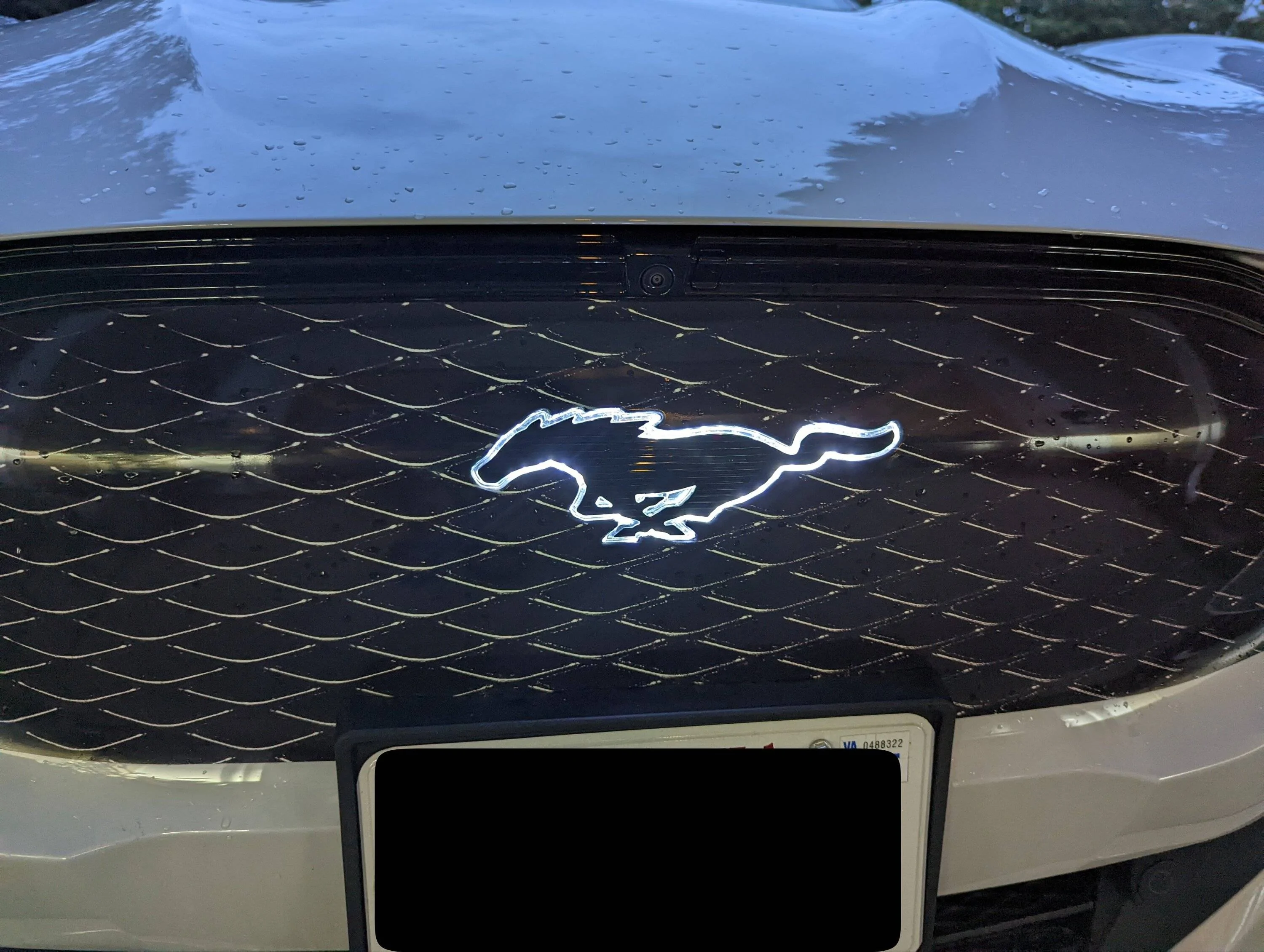

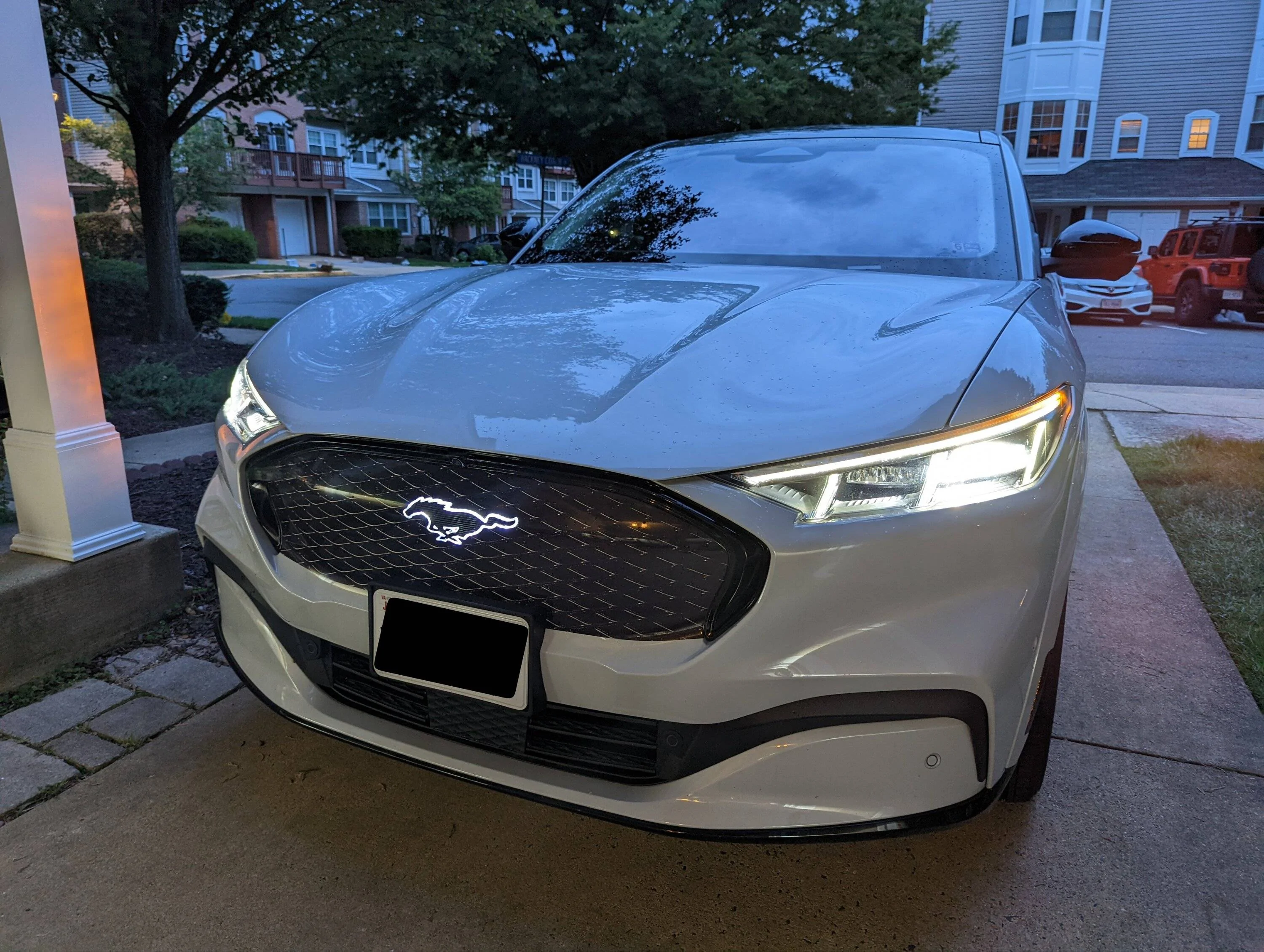

Man does this pony look NICE!
Weirdly enough, I could only get it to turn on via the "always on" wiring option. For some reason, it didn't power up when I tapped into the green/orange BCM wire.
I'm going to test an alternate method that John suggested, of tapping into a brown/yellow wire that is supposed to behave the same way and power the pony whenever the headlines are on. Going to attempt this once it cools a bit and will report back. This heat is brutal!
But for the time being, I'm enjoying seeing my pony always come ALIVE when I approach the car!
