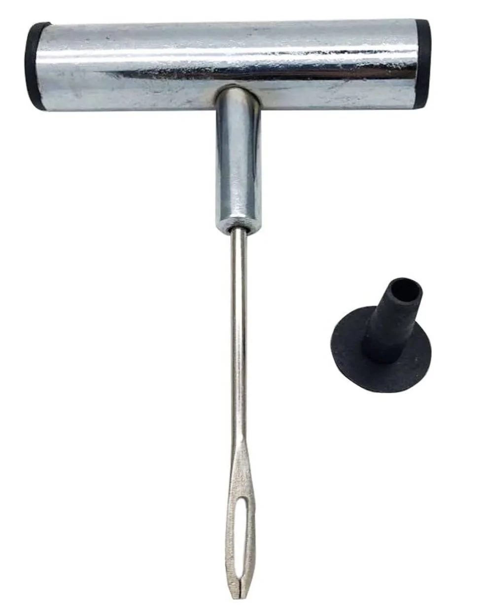

I'm not sure if folks are making a new hole or trying to feed it alongside the existing wire bundle. I made a new hole.
This might get a few laughs, but I used a t-handle tire plug repair tool with my wire taped to it. I'm also 6'6", so I could reach and touch the firewall without much of an issue from the outside.
Super easy to make a hole and pull the wire through on the left side of the wire bundle.
I hope this helps someone.

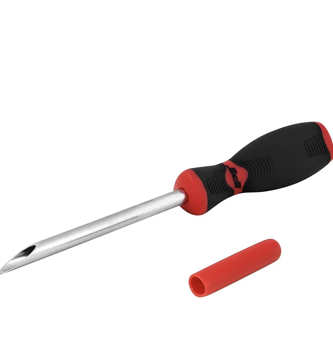

Thanks for your suggestion. @supared mentioned he was going to use try the tool below at some point. I figured either would be good to get through the firewall.
