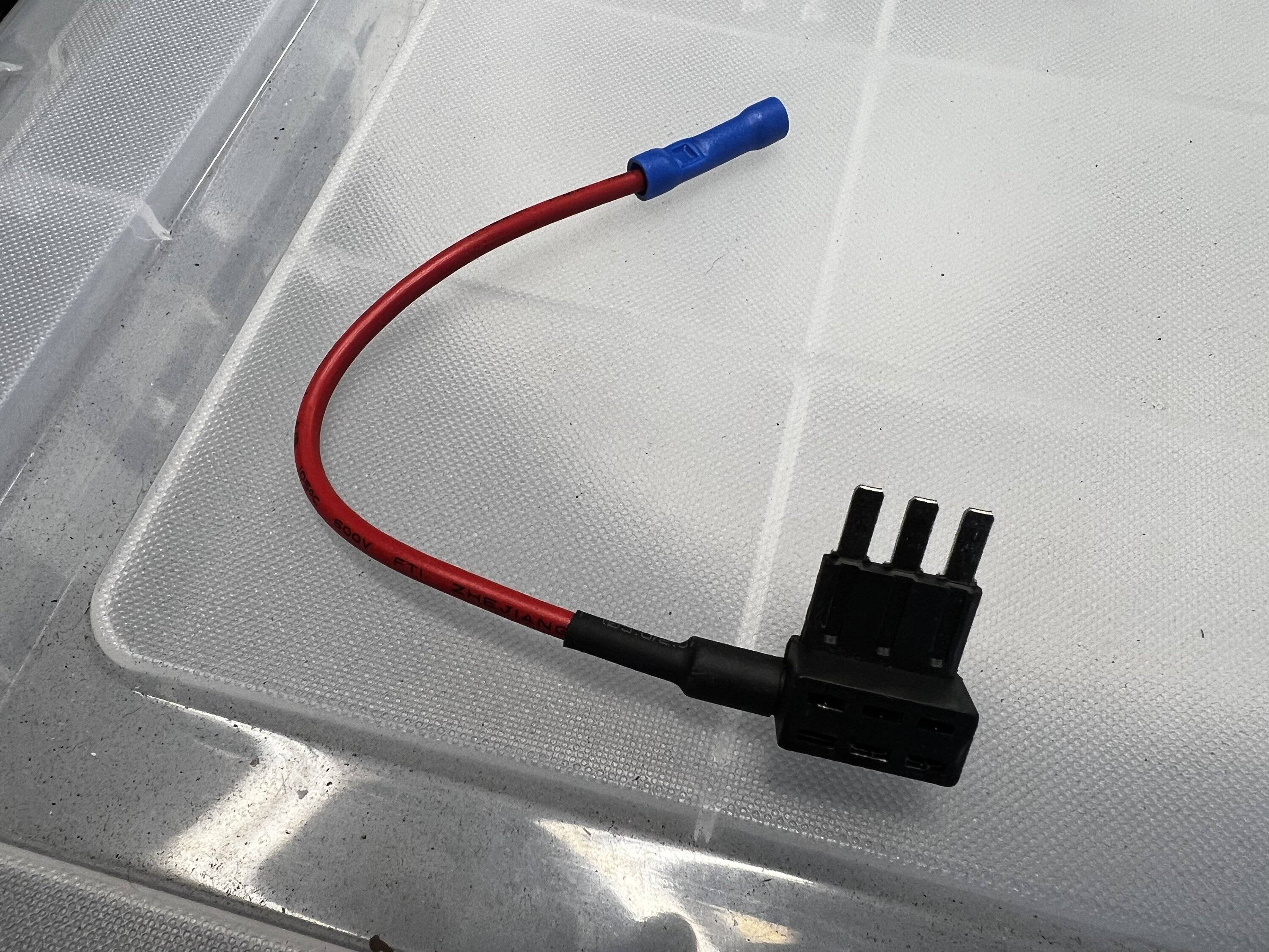

What is this harness that shipped with some of the most recent versions? (I’ve had it for months, just getting around to putting it in)
Ford Mustang Mach-E Lighted Pony Project (back it!) EF3205AD-4DCE-4BB7-91EC-66738A42B317
