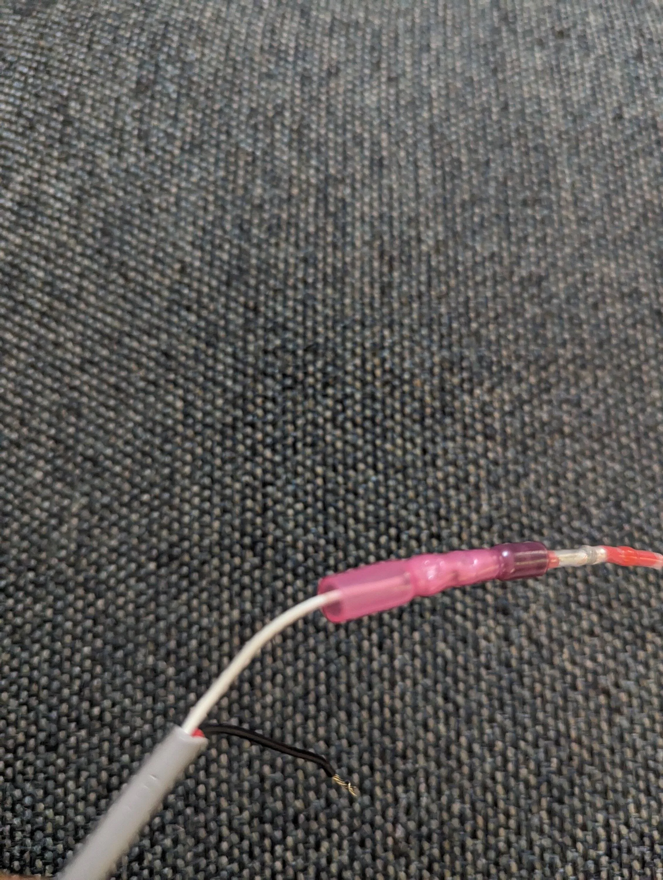

For those of you who had the zener diode already installed on your pony when it came, were both the white wire and red wire tied into the diode? Mine new pony just looks like the white wire is tied into it. In the picture below you can see a tiny bit of the red wire peaking out of the grey sheathing. The white wire is fully connected to the diode.
Does this mean I don't need to attach the red wire to anything anymore? The white will just run to the firewall/bcm and the black to the headlight harness?

Both the red and white need power. I think both were tied together and crimped in the diode on mine.
