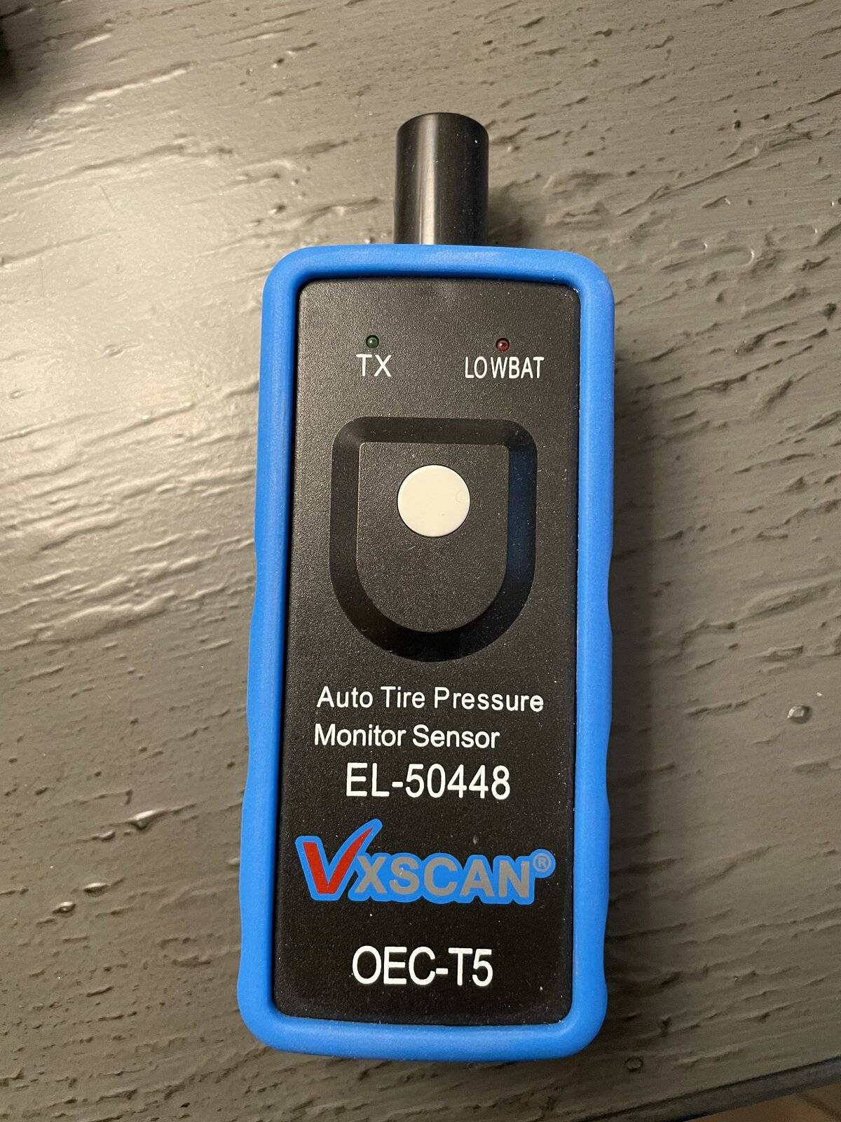

Perhaps you can go into the vehicle menu and do the TPMS re-learn procedure like any tire shop would do when rotating tires. Then use a TPMS tool like the one pictured to perform the re-learn. Not that you should have to do that but may be better than going to dealer.

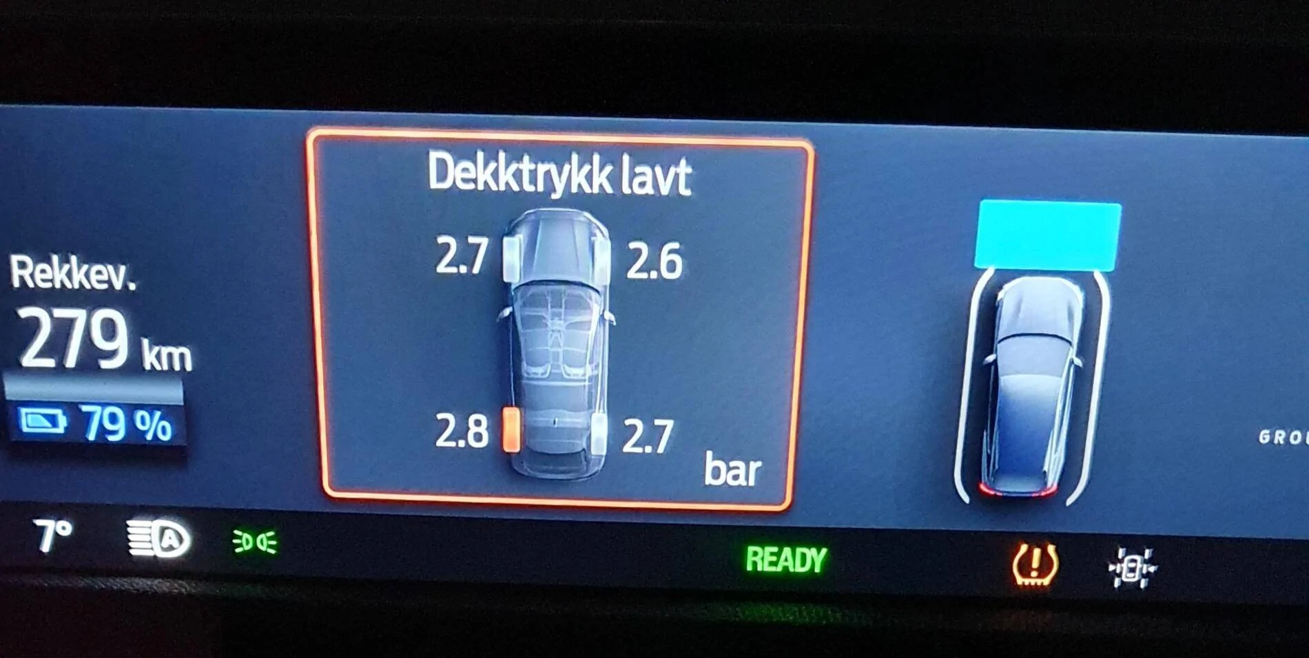

What do the tire pressures in the car say? Post a picture of the TPMS screen on the radio. Does it say "low tire pressure" or does it say "TPMS fault"?

Here is the warning screen:
Ford Mustang Mach-E Low tire pressure warning don't disappear Bilde_2021-11-17_143447
It's Bar (metric) not PSI
"Dekktrykk lavt" means "Tire pressure low"
It is no fault indication of TPMS
There is no other info on the "big screen"
