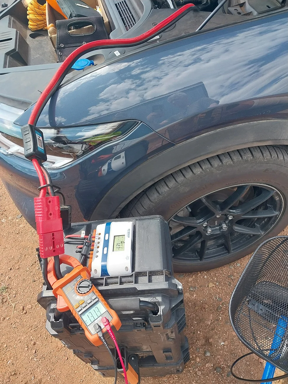

MME to the rescue today for a 12v "boondocker" that over discharged their batteries without a generator..... I go tthey back up and running in less than an hour by dumping in 12v at 130amps straight from 12 connection.
Make sure you keep an eye on the DC/DC + wire temperature, high amperage for a long period will get the wire very hot. The wires in the car were not sized for sustained 12V loads greater than about 100 amps. Just like EV charging, sustained amp loads are a different ball game.
amps drop from 130 to about 50 within a few minutes as voltage in the "dead" battery comes up. I am using 2awg welding wire.... good for 100a continuous, but you're right the wire in the MME under the connection points is not 2awg, so I would not want to run too high for too long
