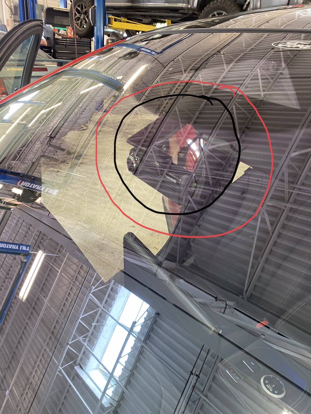

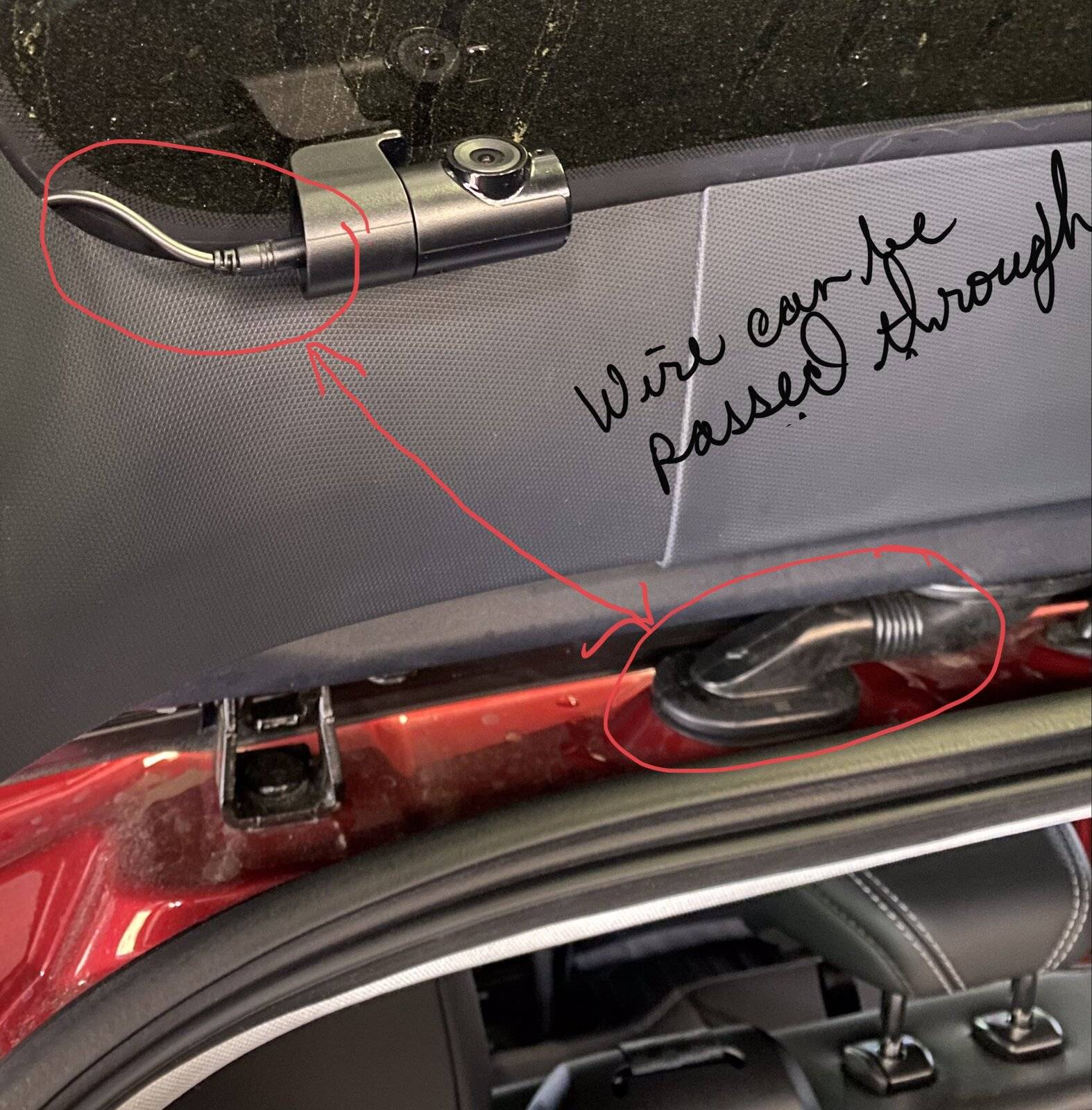

The Ford Branded Thinkware Camera is, as of today, installed in my car. Model DC-M1-FG. Camera Front and rear and OBD connected. The tech at Crossroads Ford Wake Forest did a great job installing the cameras. As you can see in the attached photos the front camera is just below the rearview mirror and not really in the way. The rear camera is on the left side of the car (my choice) slightly angles to the right side. The video and audio quality are good. Records one minute snips.
Also when you take you Mach-E for service bring the fob. It was an adventure starting the car when he needed to move it. They have no "dealer access" which is good.
Working with the system is interesting. I think I have to use this for a bit longer to form really strong opinions. It uses WiFI not Bluetooth and getting connected is more akin to setting up a HomeKit device like a light dimmer. Once connected I had full access to the camera and settings. It has a setting for driving, parking, manual recordings and so on. You can Look at the videos on the app on you phone or tablet. When you connect you are warned that ADAS and other functions don't work. Not sure whey I would want to see the videos while driving.
Personally I think it is easier to pull the memory card out and use the Thinkware Player on your computer to watch the videos.
It came with a 16gig memory card. I had a 64gig card so formatted it and placed the firmware update on the card and put it in the camera. That started and adventure; it did not recognize the card and stated it needs to be formatted. There is a very tiny woman hidden in the camera that tells you many things. Turns out I had formatted the card to FAT32 as was the original card. No you want to use ExFAT and 128 block size (if you have that option) and then the card will work in the camera. (not easy to find on the Thinkware site used a BING search to find it.)
Does not come with the GPS antenna and not available via Ford that I can find. So I ordered the Thinkware antenna for $39.99 making the bet it is compatible. The application has it already. Hope it works.
Have put questions to Echomaster and Thinkware about the statement in the documentation that says "*not compatible with electric vehicles". Yet it was listed as a Mach-E accessory, hmmmm. Hope to hear back soon on that statement.

Now on to mess with the settings.
