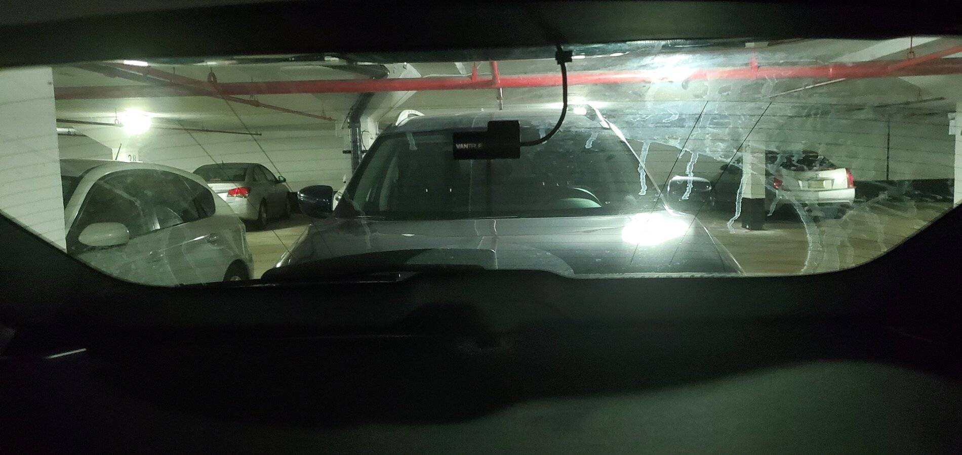

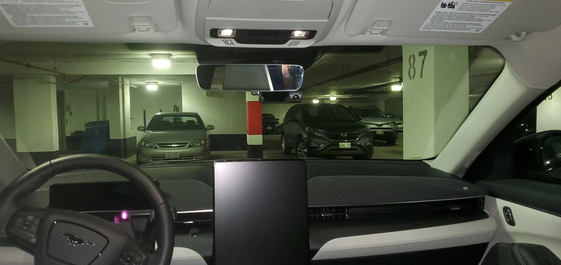

I ended up going with the Vantrue N4 3 channel camera. It records the front, the interior, as well as the rear for a total of 3 cameras.
Here is the link if anyone is interested:
https://www.amazon.ca/gp/aw/d/B0861M2VXT?psc=1&ref=ppx_pop_mob_b_asin_image
I also added the adhesive GPS mount, because it's more compact and less obtrusive, and it actually stays in place. Whereas suction cups always tend to fall during temperature extremes, which is super annoying and potentially dangerous.

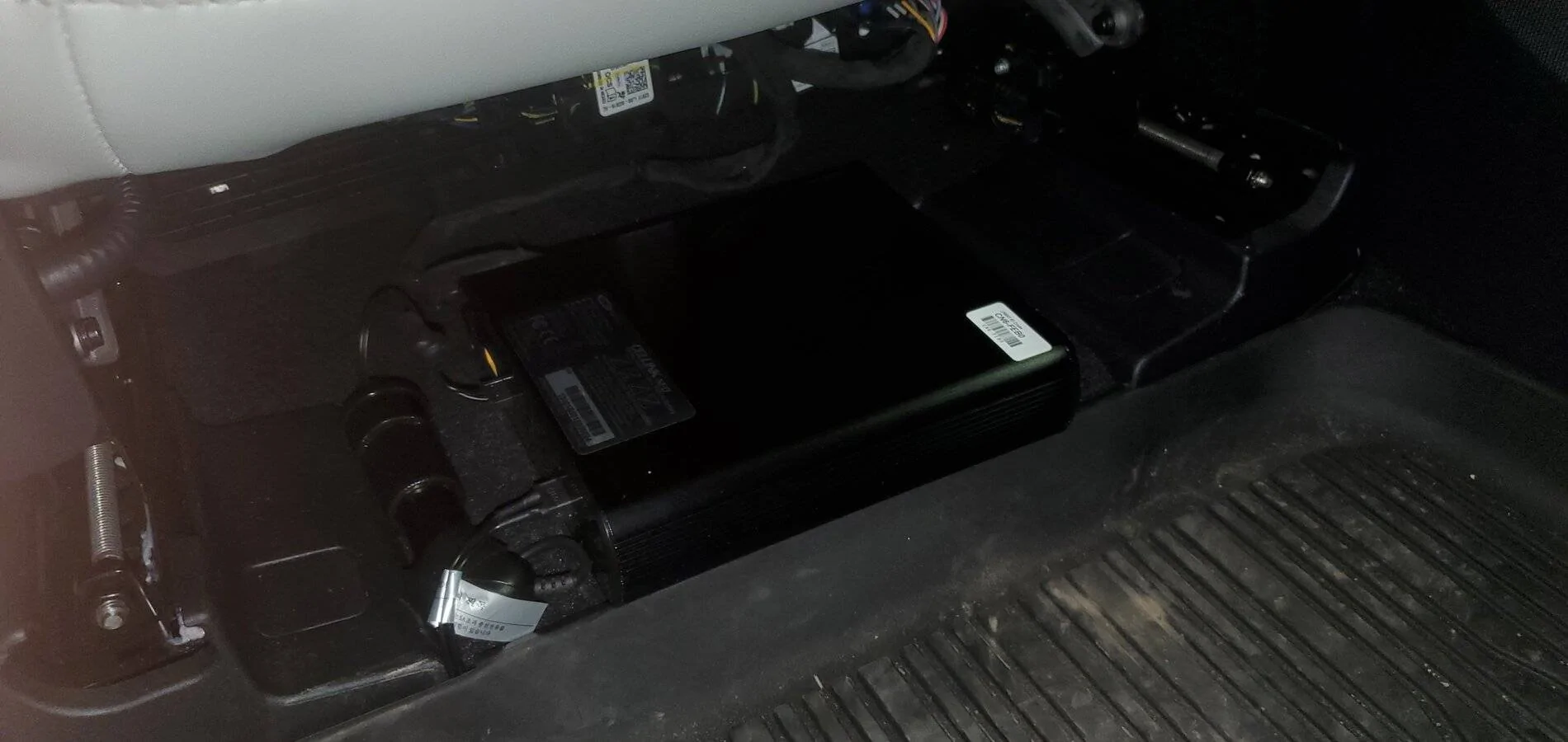

I also added a dedicated lithium iron phosphate battery for the camera that will run this 3 channel setup for about 19 hours continuously after ignition has been turned off and your vehicle is parked. The battery itself tucks away nicely under the passenger seat with adhesive velcro to keep it from sliding around.

It looks professional. I dont think I could do that without ending up with some bits visible.

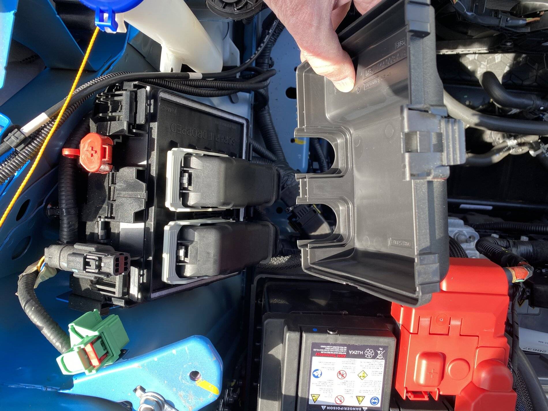

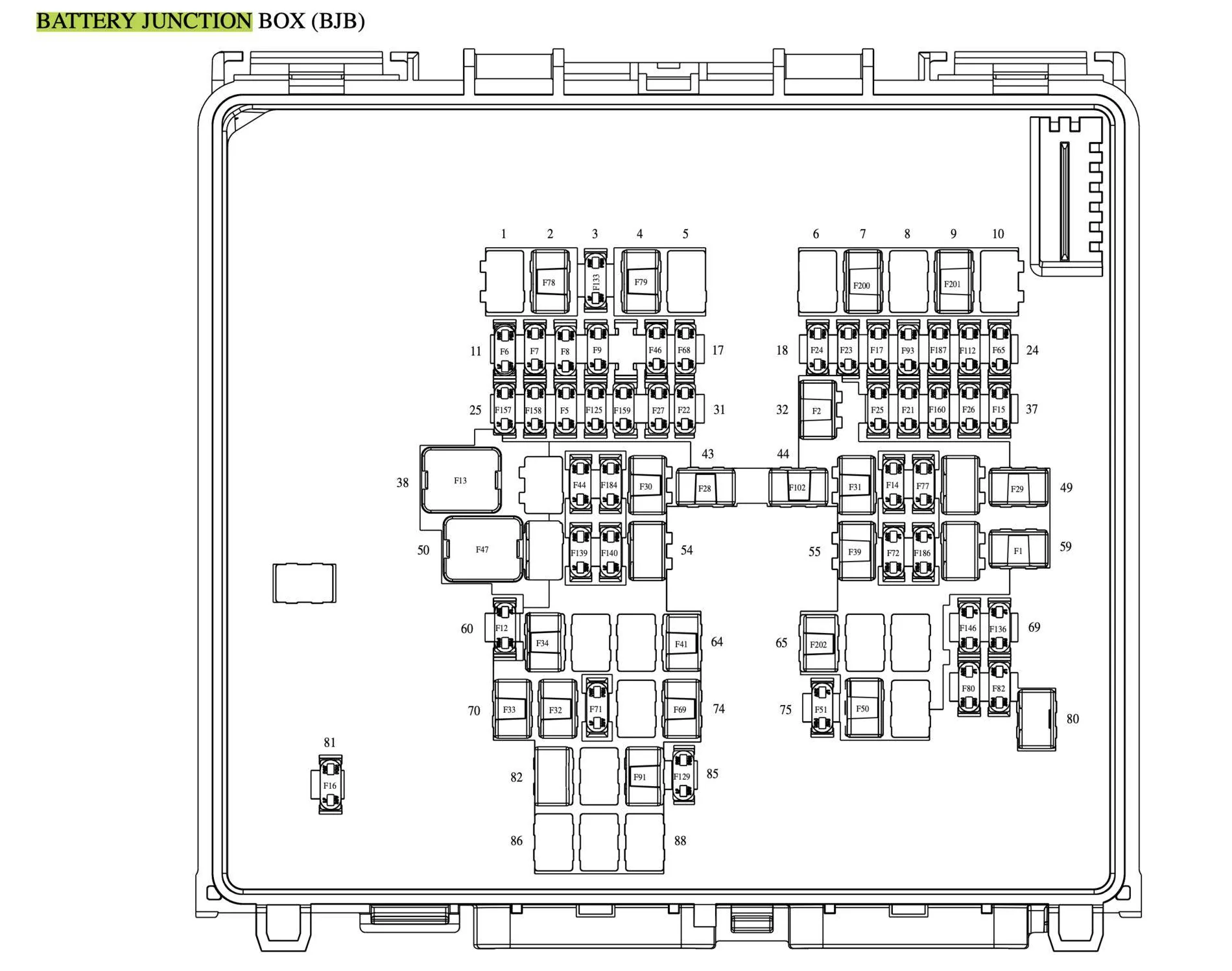

found the fuse box snapshots, here is a tour of the LVB fuse under the hood 12V Fuse Box a.k.a. the battery junction box (BJB).
So the tough part for DIY connections, including fuse taps is that +12V from the battery is provided to the fuse panel, by that one very large leaf contact in the upper corner (comes open when you open the fuse panel). Then, all the +12V distribution is out those multi pin connectors. The fuse panel can be removed by taking off the two multi pin connectors. But, with fuse taps and wires (IF the box will still close with fuse taps), then the fuse panel becomes tethered to the car by the add on wires.
Ford Mustang Mach-E Mach-E Dashcam and Sentry Mode Updates IMG-1547

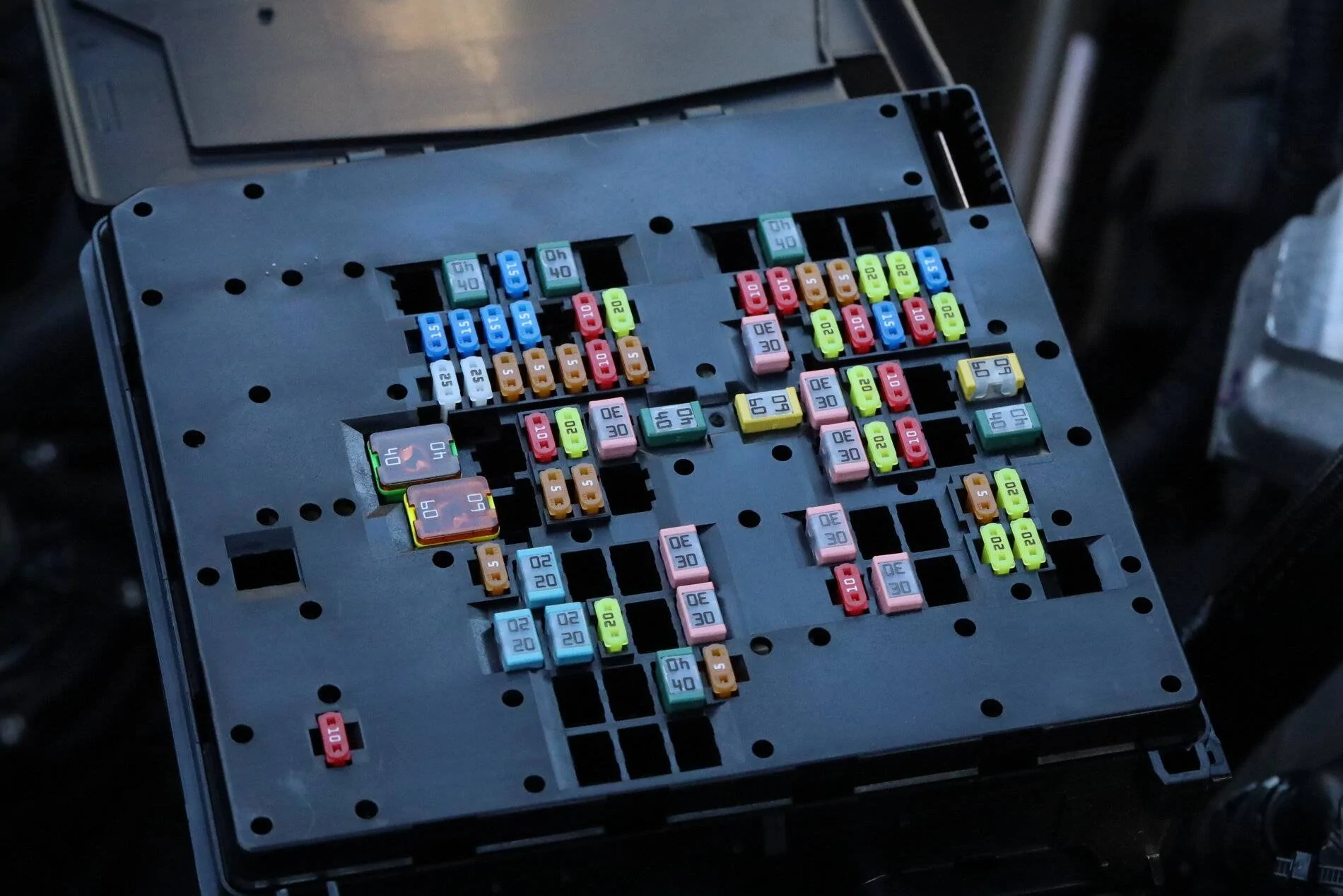

Here is to open box, the large leaf contact is upper right in the picture:
Ford Mustang Mach-E Mach-E Dashcam and Sentry Mode Updates 6Z5A0922
Ford Mustang Mach-E Mach-E Dashcam and Sentry Mode Updates Screen Shot 2021-03-23 at 7.42.04 PM
