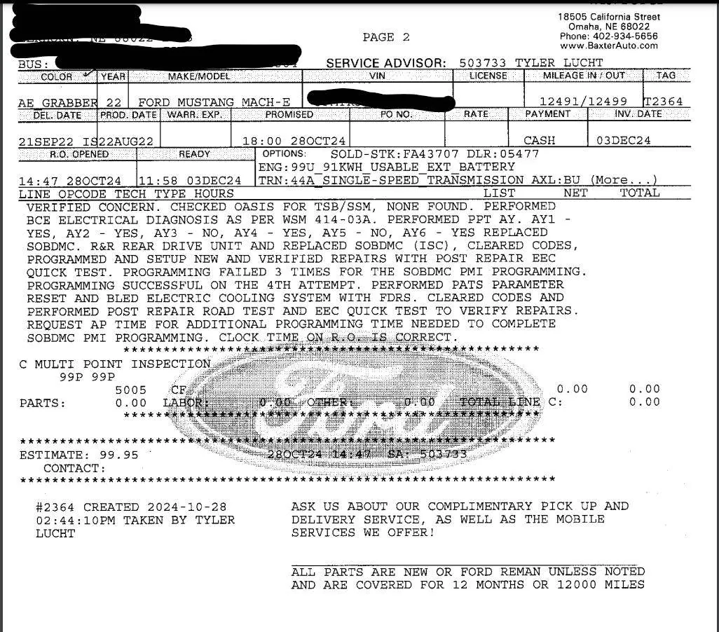

I just got my car from an over month long repair and I thought that was crazy. I have enclosed what they did below. Btw, when I got my car back I could not change the radio station. It said something to the effect of "Hardware Problem". When I shut the car down and restarted it, it went back to "normal". This has been so frustrating. I have never owned a car with this many headaches in my life.:crying:
I recently paid for the Navigation for a year since the subscription expired after 3 years. Ever since I did that when I use turn by turn there is no voice on the turn by turn and the radio drops down to a lever 4 and won't go any higher. You can barely hear it. Frustrating!
