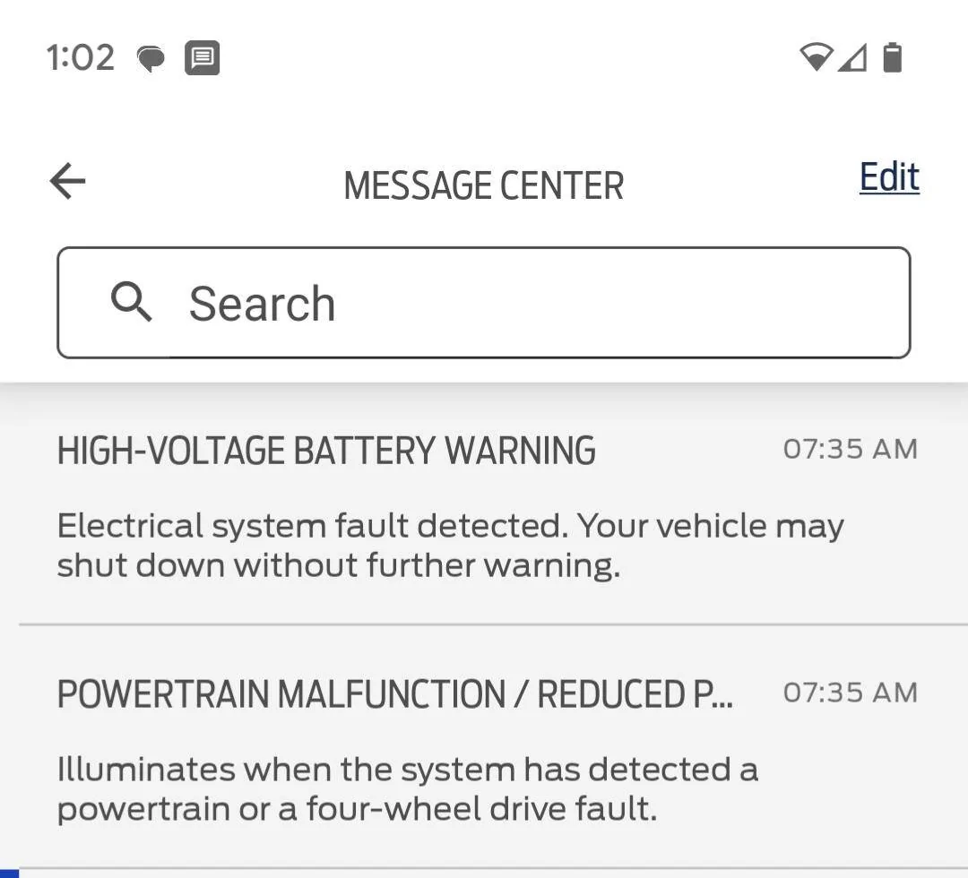

No error codes on the VIN, no msgs in fordpass, confirmed by the service department. Nothing to fix. My photograph is the only evidence it happened aside from the nice folks who checked on me. It started up completely normal on the 6-7th try about 15 mins later, so as far I as know I have a car that will stop while in motion for no reason whatsoever.
This has happened to me twice now in the last 1000 miles. As, apart from the recall HV problem, this is a recent event within my 18000 miles I was to say somewhat perturbed. The only thing I can think of is that in each case Ford had done an over the air software update. Something of a rare occurrence in the UK. The only other software updates had been performed at the dealership. Within two days the car just stopped and wouldn’t start for 15 to 20 minutes. No error messages.
