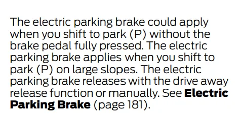

For reference I came from a 2017 Ecoboost mustang and every time I parked backwards or forwards, my car barely ever moved when I put it in park.
However, my Mach-E gives me heart attacks every time I park it. If I park backwards, it shifts backwards a bit. If I park forwards, it shifts forwards a bit.
whether you use auto-hold, or not,
put the parking brake on BEFORE shifting to P...
this is good practice for any automatic transmission to reduce the strain on the pawls
