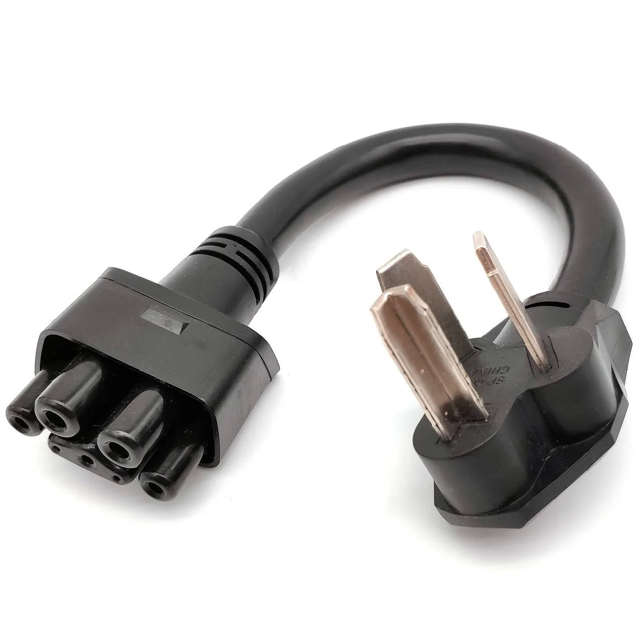

What I'd like Ford to provide or sell is additional pigtails for the included charger. The pigtail has an extra pin or two on the end that plugs into the mobile charger brick. There would be a resistor or some similar scheme in that end of the pigtail that would allow the brick to configure itself appropriately.
Exactly as Tesla sells for their mobile charger. Check out the selection on the pull down menu at this page: https://shop.tesla.com/product/gen-2-nema-adapters

Not true. The charger can easily sense that it is plugged into 120V or 240V.
I only know of any way the charger can test the load rating of the breaker for a circuit: go and blow. It's a 32A charger. The NEMA 14-xx receptacles are all different to avoid doing overloading circuits.
It's possible that the car's programming has the ability to limit charging to match the amperage of the circuit. However, most people won't know the amperage or even think to look. Plugging a known 32A load into a 20A circuit is relying on the last line of defense (circuit breaker) to prevent an electrical fire.
The Tesla mobile charger may have a system to identify which of their pigtails has been installed. There is no indication the Ford Mobile Charger can do this.

You're probably right. I don't think we've seen a side-shot photo of the included pigtails yet? So I'm still at least mildly hopeful that there are more than just the four pins we can see from the top-down photos.
The Tesla photos appear really similar, with four obvious pins shown in top-down views like at tesla.com. But when I search and find side-angle photos, I can see there are three extra pins used to communicate maximum amperage to the EVSE. For a Tesla mobile EVSE, it has nothing to do with the circuit or in wall wiring -- it's a feature of the proprietary connector from the pigtail to the EVSE.
