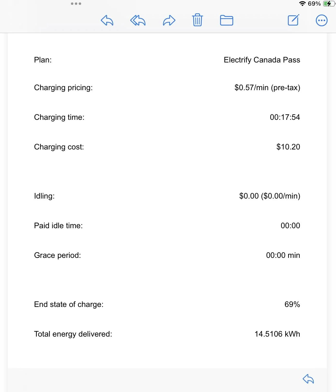

I charged at a new Electrify Canada in Red Deer Alberta this morning for 18 minuets. They have 6 chargers all rated at 350 kwh. It was just below freezing and I couldn’t precondition because the charging site isn’t on the Ford nav yet. I charged for 18 minuets and got 14.5 kWh. Crazy slow. Was showing 45 kWh on the screen while charging. Also the price of $10.00 is ridiculous. They advertise 90 kWh you pay $0.27 and anything faster you pay $0.57 kWh. Bottom line is I was very disappointed in the slow charge rate. I contacted Electrify Canada and they said they would look into reimbursing for the high rate charged to me. This isn’t how you encourage people to switch to BEV.
You don't have to put the exact charging station into the Nav, just put another DC charger that's close by.
