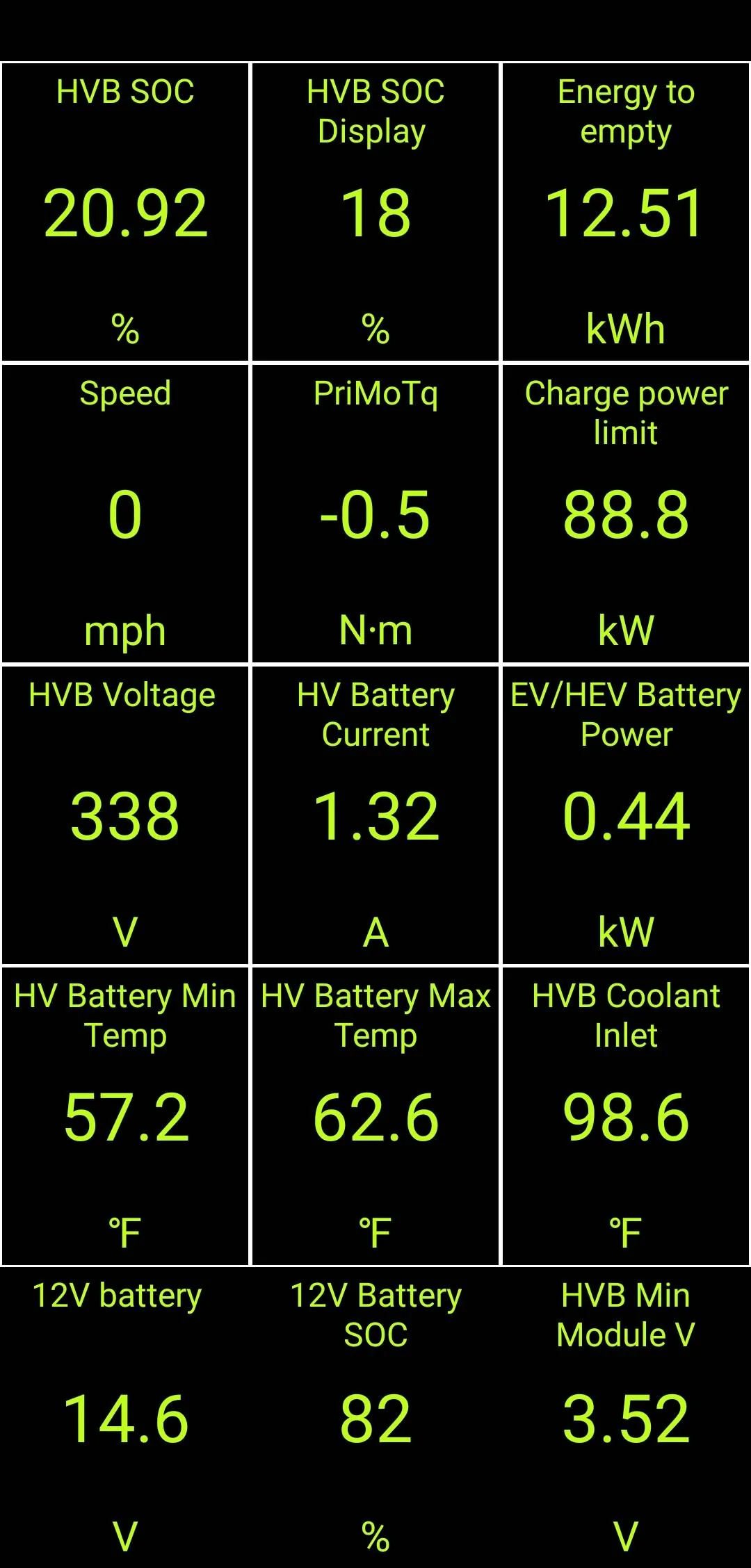

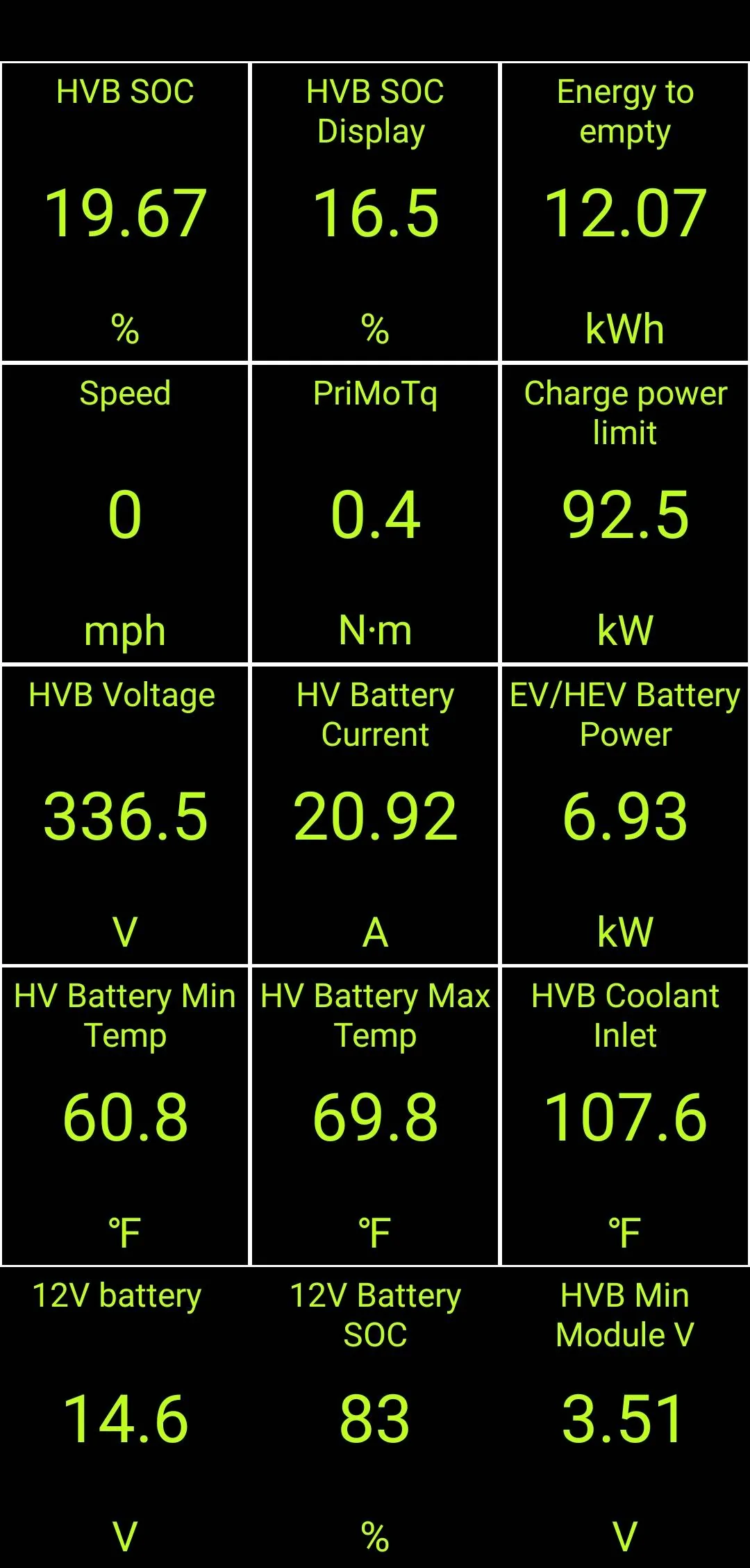

So I tried preconditioning by putting a destination to a fast charger (the one I'm going to is new so it's not on the map yet so I picked another DC charger 5 miles away. Car Scanner says it uses almost 7 kW to precondition the battery. Ambient temp is 50F, battery temp went from 63F to 70F in about 5 minutes. Sceenshots below.

Setting the destination in the built-in navigation makes a huge difference. I took a 600 mile trip this past week in New England and in similar circumstances (SOC, drive time) I maxed at 76kWh to start without preconditioning. When I preconditioned prior to my next stop I got 168kWh to start. Both were 350kWh EA stations.
I’ve had a few similar experiences, so now I try to always put in the charger destination first, and then just go back to CarPlay.
