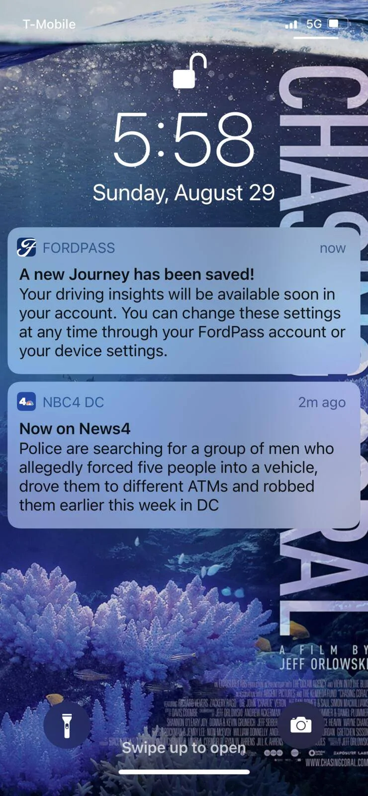

My journey stopped saving. I have everything turned on and connected and it even gives me the notification after a drive that it’s saved the journey but when I go pull it up, it’s not there. Anyone have this issue before?

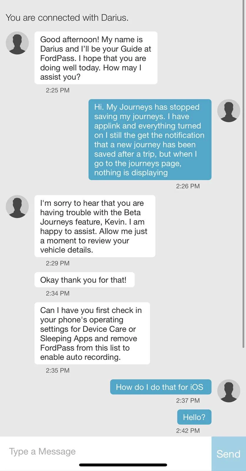

I’ve been ghosted by Darius. I have no idea what setting he’s talking about and google didn’t help.

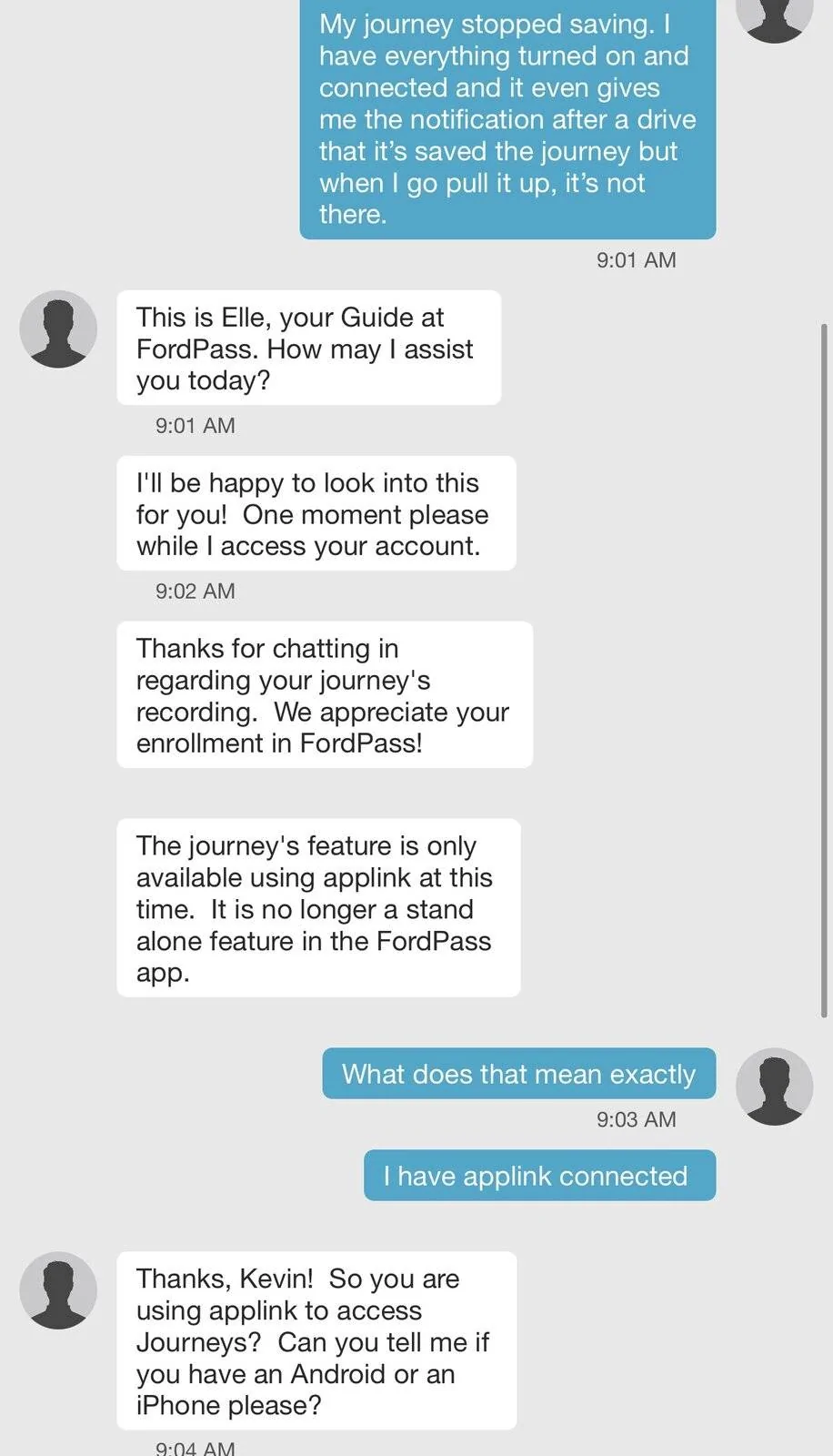

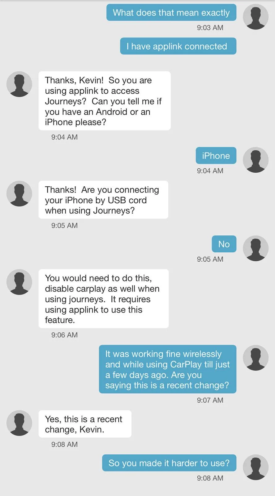

Update: this time Elle ghosted me. Apparently they just straight up made it impossible to use.

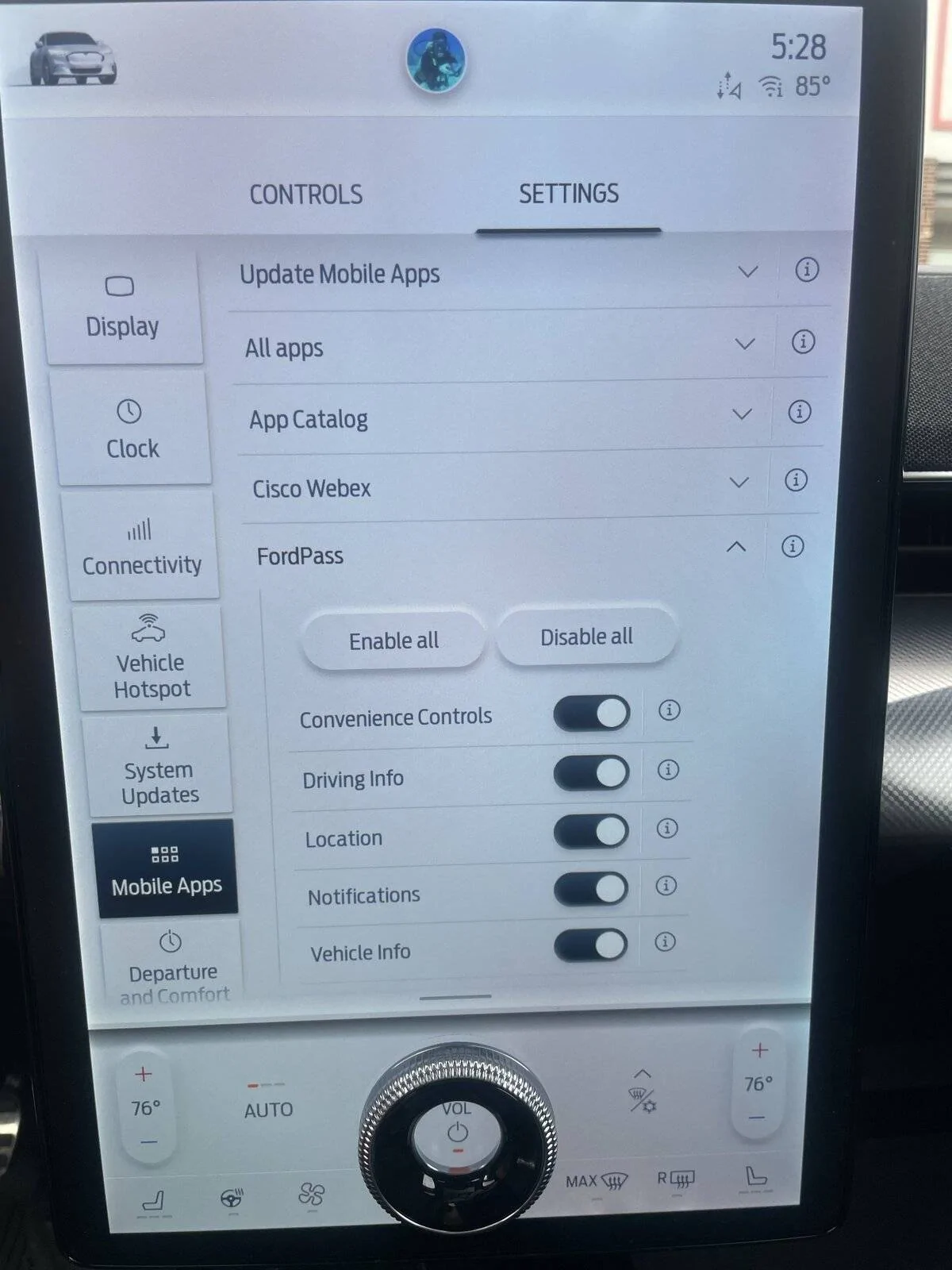

For me, My Journeys was fine in February-March, and died sometime in April-May when Marlin was in the body shop. With all the business about turning off CarPlay to use applink, yada, yada, I was never able to get them back — until today.
Awaiting my wife to come out of a store, I was in the Mobile Apps under settings. Lo and behold, FordPass was there. Opening it, I found none of the options were enabled. I enabled them
Ford Mustang Mach-E My Journey not saving B2760036-D5D1-4F9D-9F09-4B38D774FC7C
When I arrived home, voila, I had recorded a new journey
