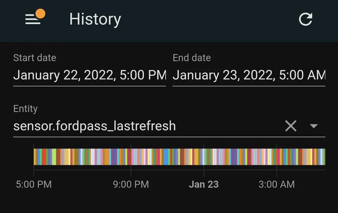

The way I determined it was forcing a refresh was via monitoring the data transmission from the car. I'm looking for the screen shots that I know I provided to someone here.

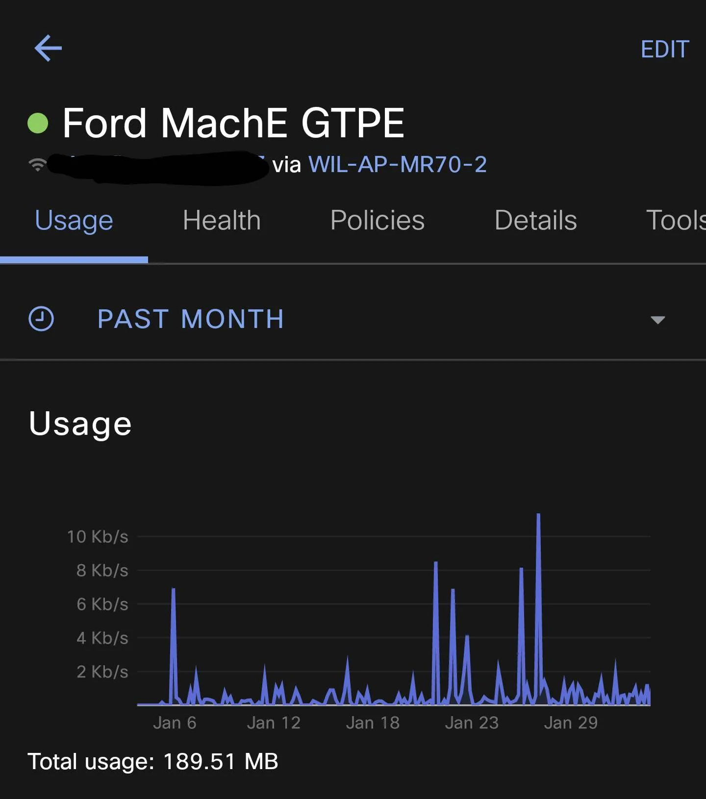

It uses WiFi. I forced a refresh every 5 minutes when I was testing this and my MME WiFi usage was pretty extensive. I was able to cause numerous battery drain errors in the process.
I know I have my data screenshots somewhere, I found my proof of testing refresh

The car reports back for a number of events, door locking is one of them as well.
If you take a look at this and the previous picture forcing a refresh you can clearly see when I was testing the refresh.
