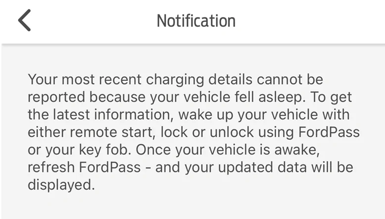

I really don't think it has anything to do with the Widget because I get the same stale data in FordPass too. When I do force the car to refresh by changing a charge setting in FordPass, the updated data is reported in both FordPass and the widget.
It seems to me like the requested refresh command that comes from FordPass (or the widget) is ignored by the car or never actually makes it there, which is strange since all the remote commands (lock/unlock, start, etc.) work fine.

There's no question that my car is going to sleep (but not deep sleep) any time it's not plugged in. I see this message in FordPass quite frequently, even if it's only been a few minutes since driving. But in spite of what the message says, a lock/unlock of the vehicle does not wake it up. Changing the charge settings in FordPass does though.

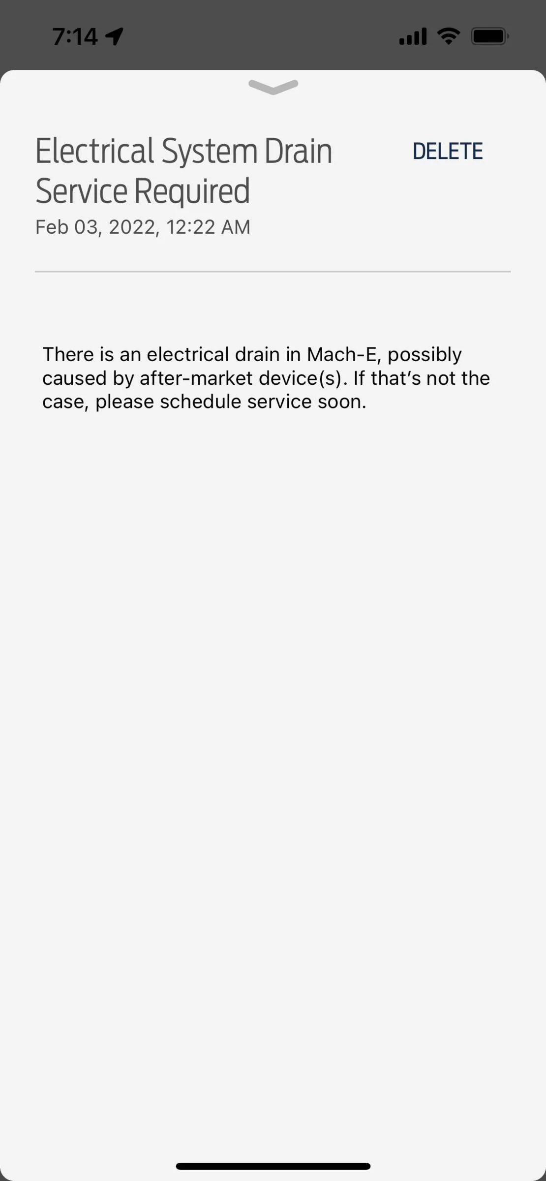

Got this message over night. I’ve changed nothing, so not sure what would be causing the drain. My car is a May 21 build, so I believe there is a bulletin regarding this issue. My car also goes into deep sleep mode after around 12 hours of sitting. After a 5 day trip, it fortunately started with no issue, but I wasn’t able to remote start it or use any other remote function.
I have an appointment tomorrow for the windshield recall (no roof glass) and will raise this issue with the dealer as well. I’m also due for the 21P22 update, so I guess we’ll see how tomorrow goes!

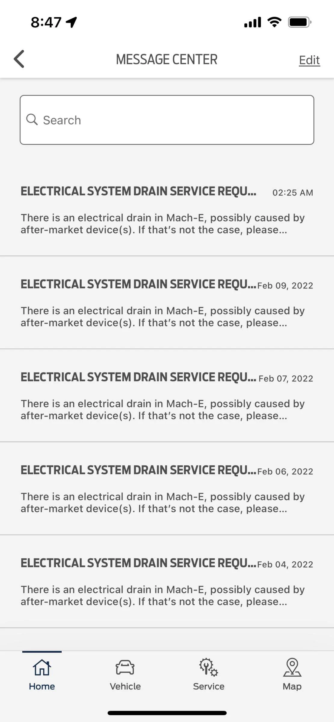

Since posting this, i have received the Electrical Drain message every morning. Due to the weather, I did not make my appointment on Friday, so no 21P22 update yet.
Dealer said that the software update may fix the issue, and if not, I’d need to leave them the car for a few days.

Did they figure out the problem? I’m suddenly getting this notification daily.
Ditto. Along with the 12V Battery fault message - into the dealer on the 23d. I told the service manager that I would rather have their best technician rather than the available technician. In any case I am sure that I am paying for their learning curve.
