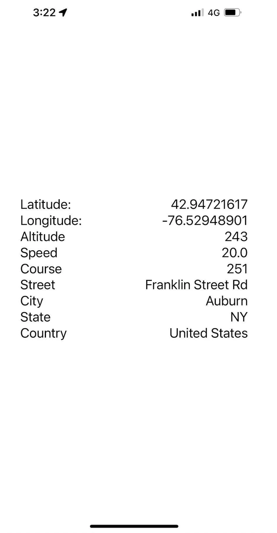

I know it doesn't look like much but it gives me access to navigation-quality GPS data that I can log with the vehicle dynamics to present a detailed and complete look at a trip. Let's dig in to see how it works.
When I first started I required an internet connection to relay the data to a Raspberry Pi server in my basement. Because of random cellular signal dropouts I could see this wasn't going to work so I upgraded the software to use a local data store whenever the database connection dropped. The Record software will continue to keep trying the connection on subsequent writes and will write the backing datastore when the connection is restored. The design is nice since it can be used without any internet, I can just upload the backing datastore when I return home and the MME Raspberry Pi connects to the home WiFi.
In order to find my GPS web server I need a static IP address, something else your phone will not have and for this I turned to Tailscale, which in their own words is:
Tailscale is a VPN service that makes the devices and applications you own accessible anywhere in the world, securely and effortlessly. It enables encrypted point-to-point connections using the open source WireGuard protocol, which means only devices on your private network can communicate with each other.
Perfect and free, just what I need to find my MME anywhere it has a cellular connection and be secure to keep anyone from snooping in on my location and traffic.
Writing an iOS app means I needed to learn the programming language Swift, so I searched for open source software projects that had a compatible HTTP server implementation, which is called HummingbirdCore. Turned out to be pretty simple given I had never used Swift and last used Xcode/Objective-C in 2014 when I wanted to learn iOS programming. Two days later it is done, contains just 300 lines of Swift code and I'm back to working on the Raspberry Pi Python code to incorporate with the other MME data.
By tying the phone GPS data into the HTTP server response, I can retrieve the current GPS coordinates simply by visiting the URL.
% curl -X GET http://100.93.138.71:8080
{"speed":20.0,"latitude":42.94721617,"longitude":-76.52948901,"course":251,"altitude":243.2}
The Python code to request and extract the GPS data is simple as well:
>>> import requests
>>> r = requests.get('http://100.93.138.71:8080')
>>> print(r.json())
{'speed': 20.0, 'latitude': 42.94721617, 'longitude': -76.52948901, 'course': 251, 'altitude': 243.2}

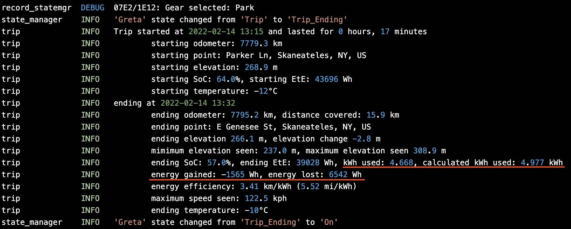

And finally a look at the initial trip logging. This new feature exposed a few issues but most are fixed and the few left should be corrected in a day or two. Adding new features always seems to break something and the new Trips capability is no different.
Ford Mustang Mach-E My winter Mustang Mach-E project 1644895775173
What is shown here is a log of the key items that one might like to know about a trip. I focus on the change in the EtE (Energy to Empty) as it and the distance traveled is the efficiency of the trip. The EtE and my calculation of it is the first red underline, there is a small difference between results but I guess Ford can do it better than me trying to integrate over the CAN bus. Perhaps increasing the sample rate will help but I include it to make sure the results are rational.
I screwed up and failed to note the MME reported trip details but I'll repeat the test with the next version and make sure things are accurate. 5.5 miles per kWh is impressive but I choose a hilly route so I could experience energy recovery on the downhill stretches. You can see this where I measure the energy returned to the high voltage battery versus the energy removed from the battery (second red line), the sum of these being the overall energy used. These results make sense for urban driving or in my case, lifting off the pedal on the downhills and letting 1PD slow the vehicle.
I see some fun graphs in the future, using distance traveled on the x-axis and elevation on the y-axis should be interesting as I live in an area of scenic hills and lakes. I haven't used FordPass for some time now and can't really remember what they show but I should have access to information they won't offer to augment what they do well.

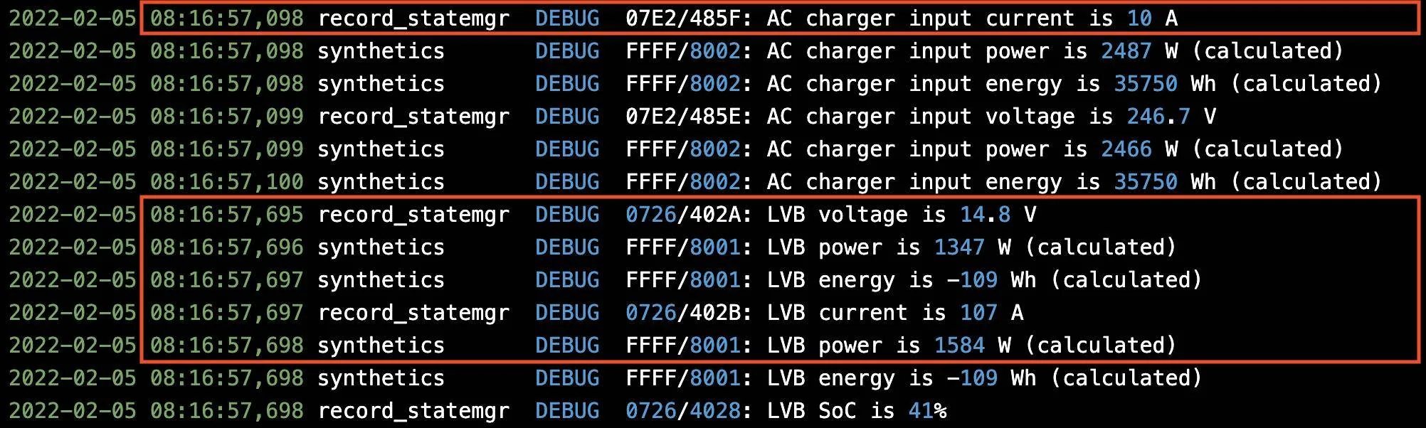

Let's dive into the MME sitting in idle connected to a wall charger after having completed charging the HVB to 80% SoC.

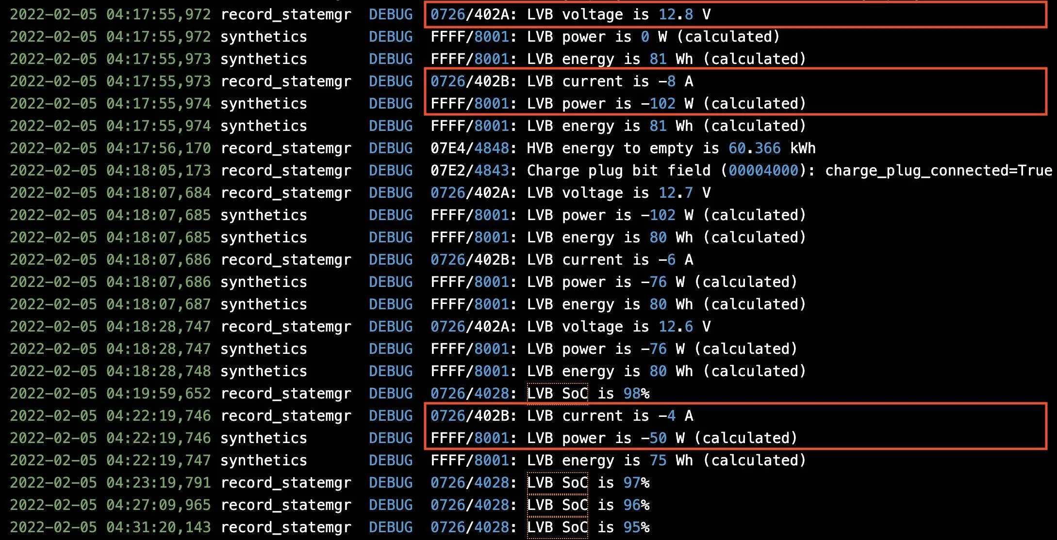

At this point the MME will be slowly discharging the LVB, losing about 1% SoC every 4 minutes:
The battery starts at 12.8V which is good for what I assume is an AGM lead-acid battery. Initially the load is 100W but within a few minutes it drops to 50W as the car shuts down unnecessary equipment. This continues until a few minutes after 40% SoC is hit and the DC-DC module is re-enganged:

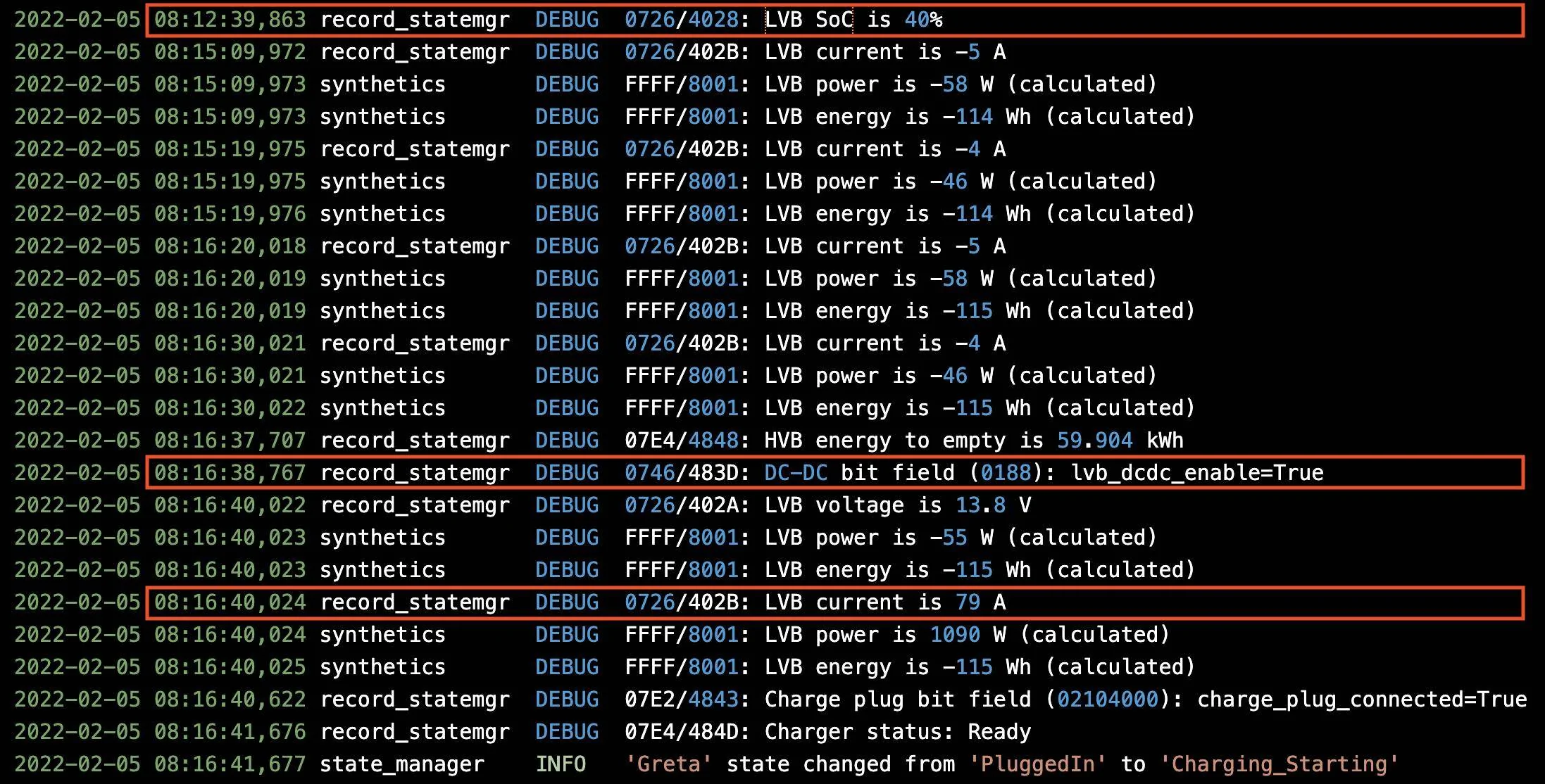

Unlike my previous post where the recharging was from the HVB, there is a power source connected to the charge plug. We can see that it starts out drawing 10A from the wall charger. Charging starts at over 100A, peaks at 110A but will quickly taper down, just 8 minutes later it is half the peak current and the LVB SoC will be nearly 80%.
It takes over an over to bring the LVB back to 100% SoC, in this example it wasn't until 9:30 that the AC charger disconnected and the LVB started a new discharge cycle.
I don't claim to know the details of how the AC charger and DC-DC modules work together but this should give you an idea why Ford nags you to plug in when you shut down the car to keep the HVB at peak condition and let the wall charger do the work of refreshing the LVB and preconditioning the car.

I monitor the LVB every 5 seconds and my data is vastly different. My discharge cycles get to 15% SOC no-load voltage before it kicks in the charge from HVB. While connected to the charger I only get HVB to LVB charging while the HVB is being charged. If the HVB has reached it's target the LVB charging stops.
I would agree with this but as the LVB charging takes just over an hour it tends to be at 100% SoC before the HVB reaches 80% SoC. My charger will kick on again when the LVB reaches the low point, nominally 40% SoC, and it will bring it back up to 100% SoC.
