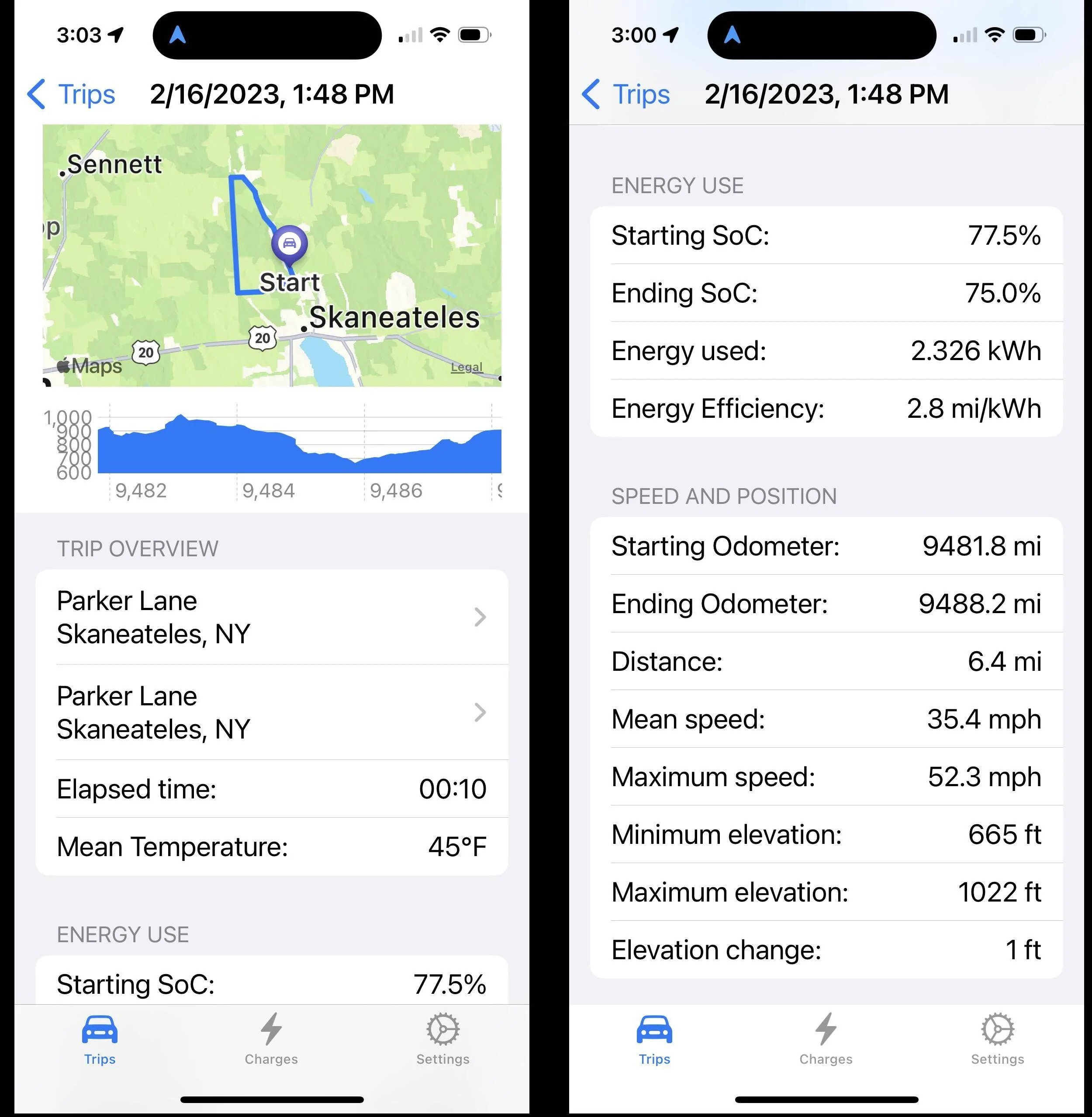

I can now collect the data from a ObdLink MX+ - no more Raspberry Pi's, no more cables and no more power draw that has FordPass yelling if I leave the original Raspberry Pi plugged in the ODBII port.
Here is a new trip, recorded earlier today using nothing more than an iPhone and the ObdLink MX+ with the OBD Record app and visualized with the OBD View app:
Ford Mustang Mach-E My winter Mustang Mach-E project 1676577835111

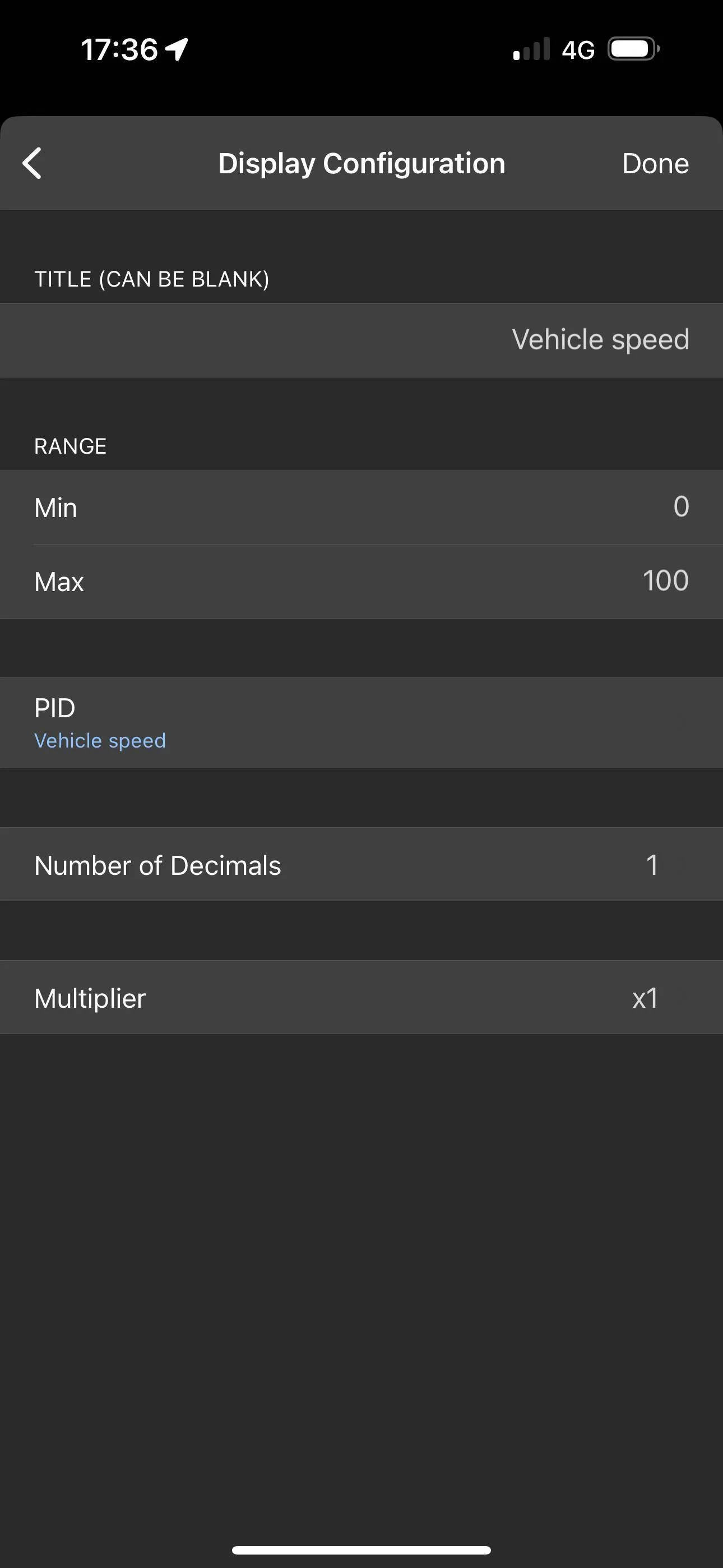

MX+ arrive here today and I can’t find SOH in the dashboard item lists.
Can you point me in the direction.
After choosing dashboard item attributes, I arrive at this menu (screenshot attached) and I’ve been though each menu item and can’t find hybrid/EV SOH anywhere, or it is called something else

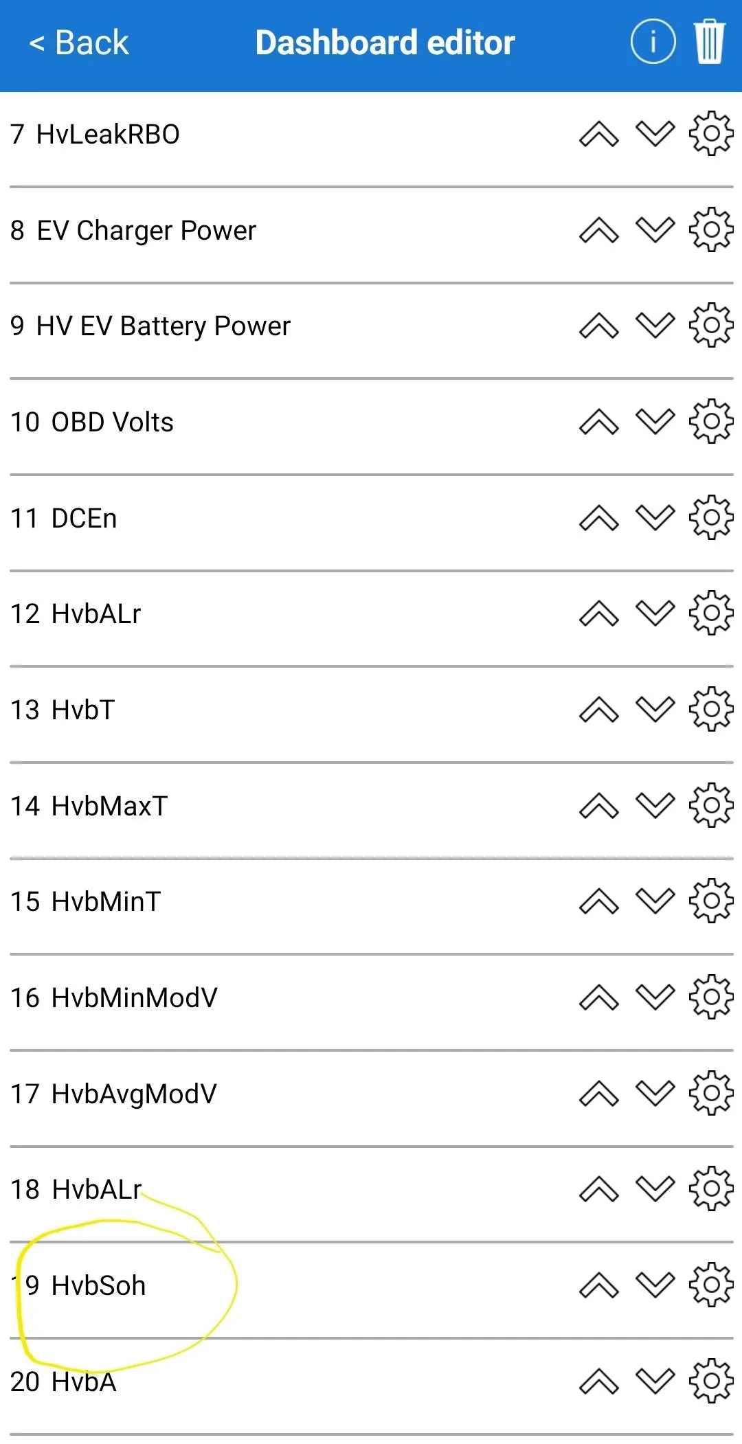

Enter the Dashboard Editor in Car Scanner, and add SoH as shown below:

You can do it by creating a new dashboard, or editing an existing one. I have edited the ones CarScanner built. It is easier IMO.
This screen is probably from the OBDLink app.
For SOH you need to use another app Car Scanner ELM OBD2, and choose Connection profile: Mustang Mach-E during initial setup.
One of pre-loaded Dashboard screens in Car Scanner shows SOH and battery age in months.

This is true. CarScanner includes SoH in an existing dashboard. No need to add it unless you want it on another dashboard, which I did...
