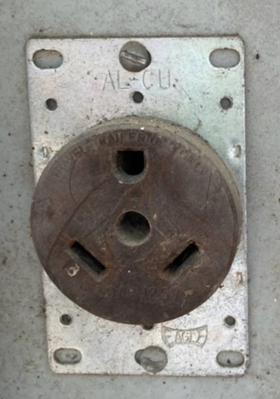

I’m short on time here. I leave for a trip tomorrow. The location where I’m staying said I could use one of their RV spots for charging.
I have the ChargePoint Home Flex with the NEMA 14-50 plug and want an adapter plug to fit the RV receptacle from Amazon.
Please help if you can recognize the plug below. TIA. I don’t know what to search for to find an adapter that will convert the 14-50 to this:
If there is a Camping World near you, they will have the adapter.

It’s probably easier to ask the campground if you can rent a spot with a 50A outlet instead of the TT-30.

They only have 30A plugs.
