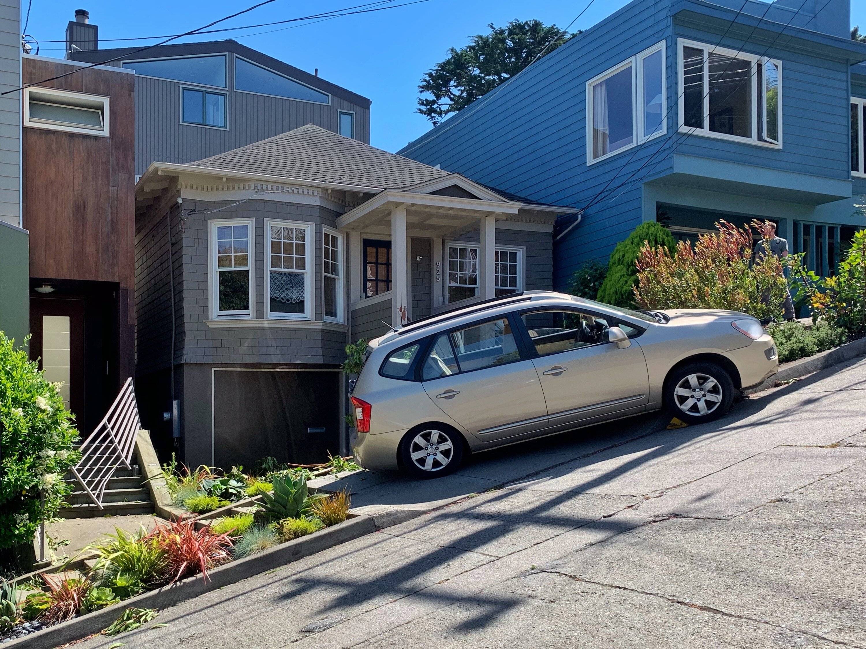

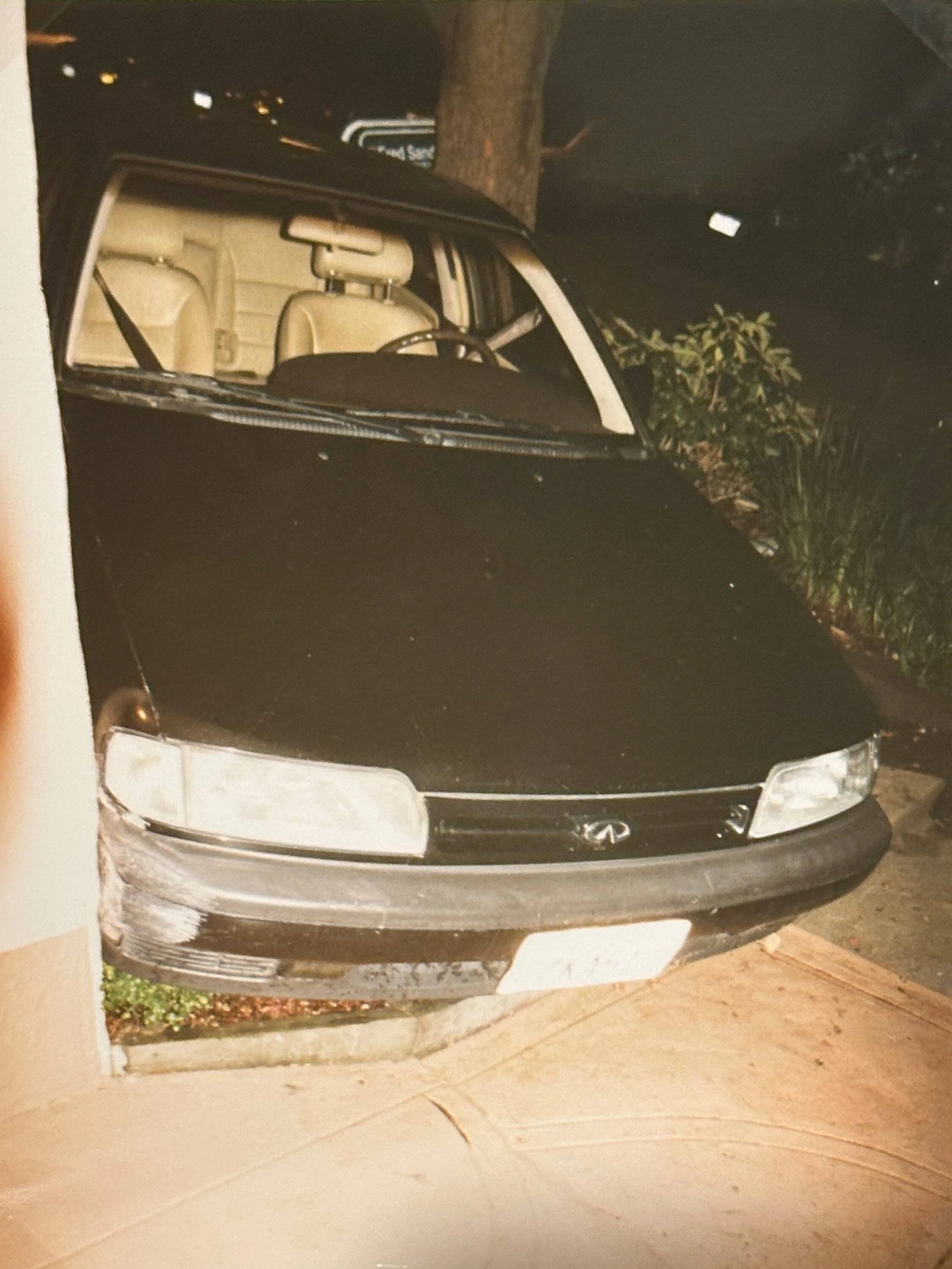

The first time a car ran away in the 25 years we've lived here was on Halloween not long after we bought our house. A car popped out of gear and slowly made its way into the planting strip in front of our house where it nestled up against the house and didn't even crack the stucco. (The parking brake was engaged, otherwise we'd likely have needed a new front porch.) Amazingly we only needed to replace one plant!

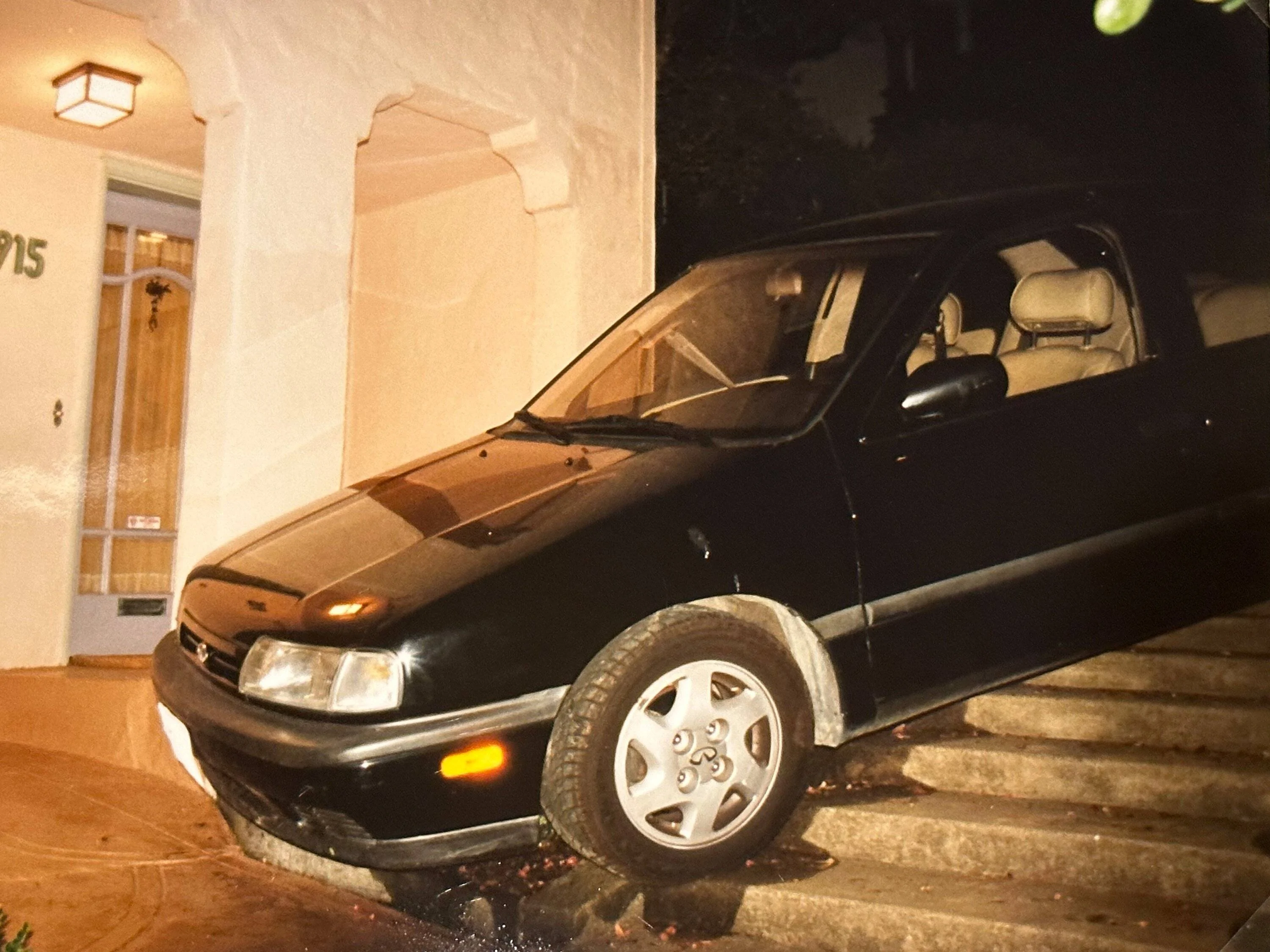

This was one of the more destructive times a car ran away. The driver lost control of the car in reverse, ran over (and took out) a tree in front of the blue house, took out the railings in front of the gray house, and then took out the metal railings of the condo on the left. The concrete steps are what finally stopped the car's terror campaign. Luckily no one was hurt. (The car is being winched up by a cable to get to the waiting tow truck.)

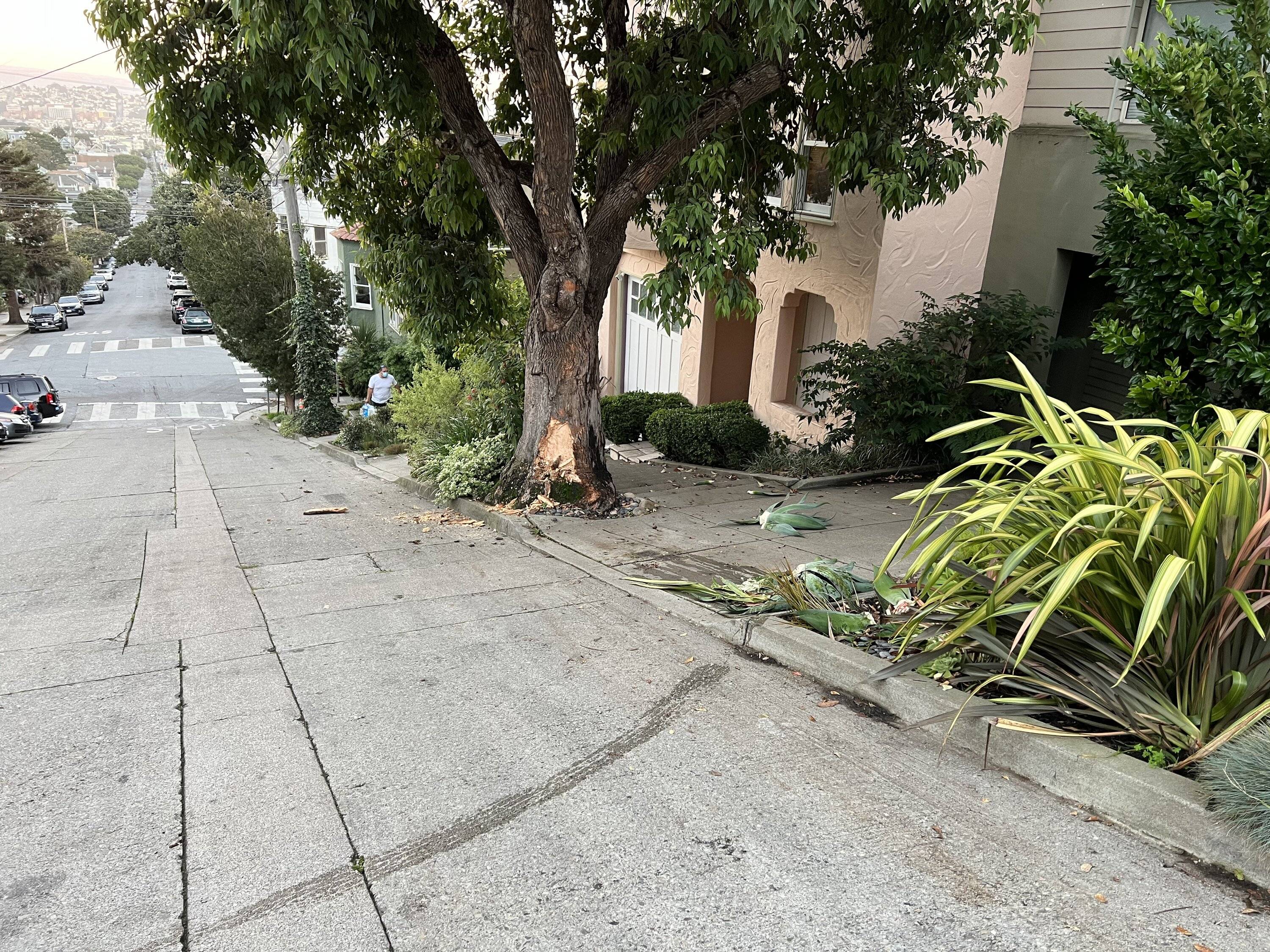

Here is the aftermath of the second time the tree in front of our house (the peach colored one) was hit hard. On this occasion the tree stopped the car. On the first occasion (no photos sadly), the car bounced off the street and ultimately came to a stop in the intersection below. Luckily the tree is still doing fine.

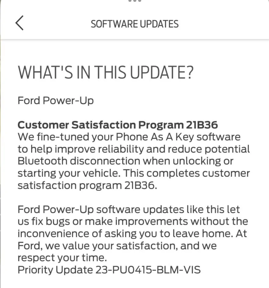

I have been out of town, but today I received:
Ford Mustang Mach-E New feature: Automatic parking brake enabled with a recent update IMG_3122
Now when I put it in park I see a message that says something like ā€œParking Brake setā€œ and the word ā€œBrakeā€ now illuminates when it is in park.
Not sure if it was 23-PU0415-BLM-VIS or not…but now it operates as I would expect it to with the ā€œBrakeā€ indicator now on when the car is in park.
