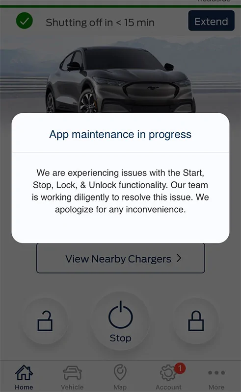

Please explain how we avoid that? Mine charges immediately and always hits 100% if not manually unplugged ever since it showed up. It has been a charging maintenance nightmare for the first 2 months. Throw in a drained 12V with a flatbed it has just been rosy. Manual charging at home was not what I expected for the cost of this vehicle. Wonder when the L2 charging problems will get some attention? I have no problem or care for paak as it has nothing to do with the basics of maintaining your new purchase. Got this popup this morning.
Ford Mustang Mach-E Optimal Battery Charge Level? Untitled-1
The workaround is hit (initiate) it once (it will error out most of the time) then hit (hold) it quick again and it will start (8 to 9 times out of 10). After the 12V draining and the vehicle not maintaining itself at all you have a tendency to check it is still alive and it has been. There is no workaround for a dysfunctional home changing schedule. Want to report here that it works and discuss recommended SOC but that appears to be a long road and is taking considerable time. Feeling for the ones that can not L2 charge at all. But for those with no real problems except remote start not working the first time they are working on that. Hoping for a fix soon to charging problems if for nothing more than to just to get rid of me and/or shut me up. Been long enough and looking for at least some sort of acknowledgement at this point, not excuses and finger pointing at me. What I got was why do you need a schedule what's wrong with just keeping it at 100%. Possibly I need you to explain this to them? How many other owner bought that? Only 2 in N.A. ya right.
