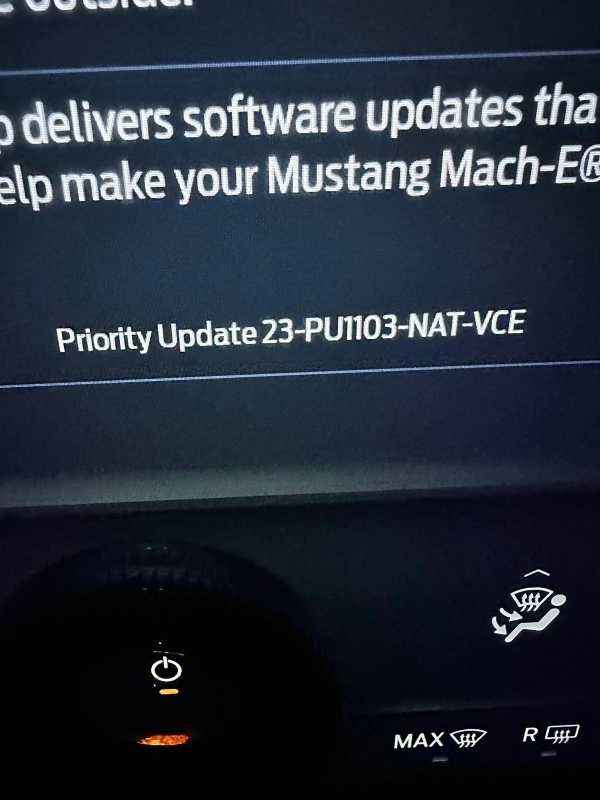

It says revision 713 and my hands-free is good till 2074 that’s good lol
Yes that is really old and won’t show bars. Make sure arrows are showing and hopefully you will start getting OTAs.
So how do I update that and since it’s not gonna show the bars and I have the arrows going up and down should I just go out there and leave the car running for a half hour right now?

Definitely trying your tips, but I’ve had the problem of the arrows that go up and down communicating with Ford disappearing like every other time I start the car and I either have to wait about a half hour and go back out and try it again cause I’m not gonna start pulling fuses like I did before But I have full bars on my phone for AT&T
Check this thread. Everyone with the problem had it started after the radio preset update (check if your last one is 23-PU0110-RAD-PS). This update introduces an error on the Ford server side, essentially stopping all OTA for us.

I went for 100 mile drive this morning and I had the up-and-down arrows indicating communicating with the Ford connected services I guess. I don’t know if that’ll trigger an update later in the week. I think I read somewhere they don’t do updates on the weekend? I used the built-in navigation this time as well. I wanted to see how it worked, wasn’t bad. I didn’t have to navigate to many charging stations, but I did set it up to navigate back to the one where I live. But the little Up and down arrows that you see on the top of your display. I also noticed them down in the bottom right corner of the navigation map. I’m not sure what that was even not even navigating to us. It had him down there. I’m guessing they were the same thing?
