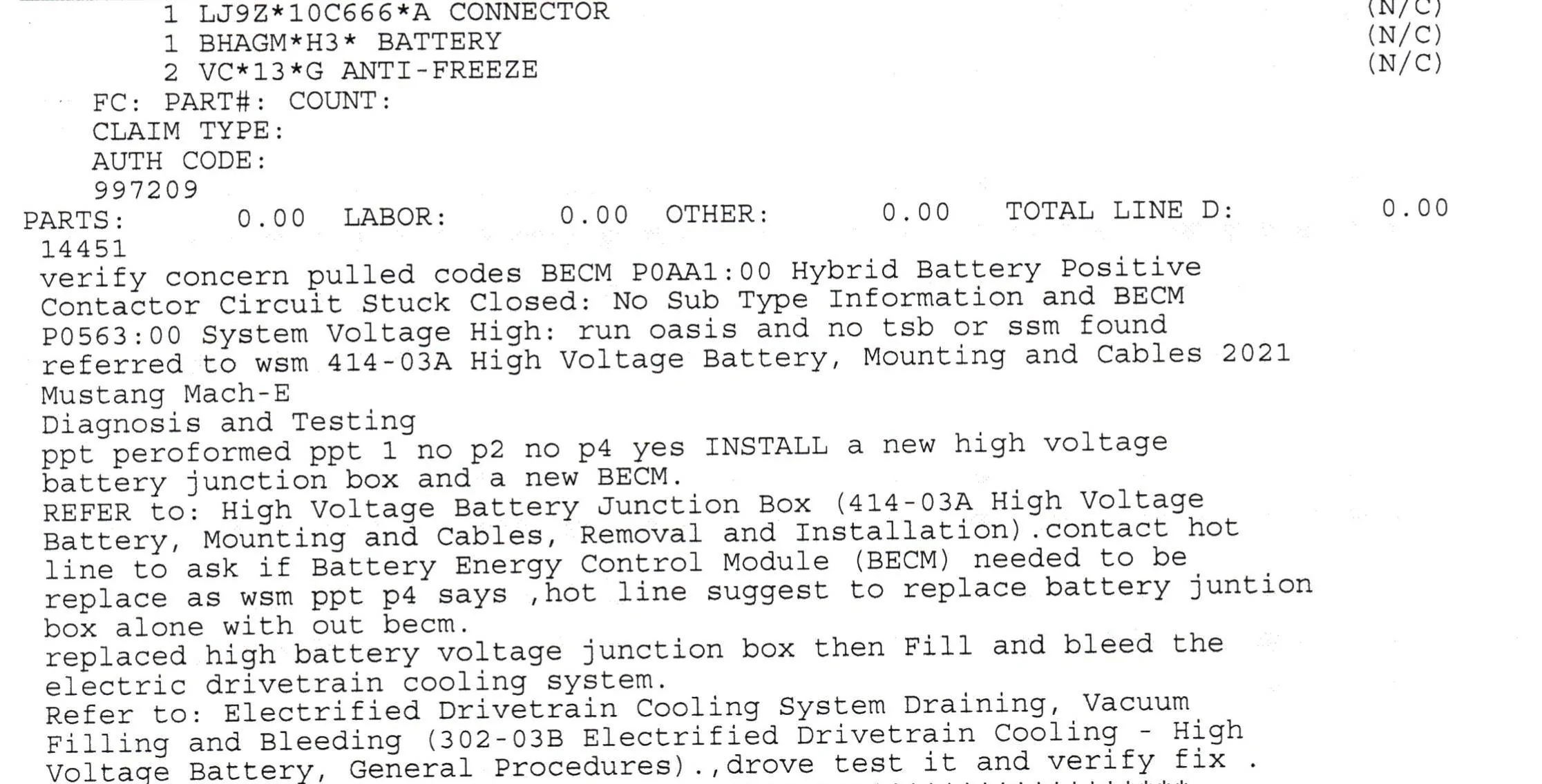

Update: Got the Mach-E back!
They were ultimately able to de-energize the HVB and then remove it from the chassis. Later, they thought the LVB was fried, but was ultimately able to charge it and it was holding its charge. They're still ordering a new one for me and I'll get that installed once it comes in (on national backorder right now).
The shorthand on the paperwork is tough to interpret, so I'll leave it here for others to explain what was done.
Ford Mustang Mach-E Our Ongoing Nightmare Screen Shot 2021-12-23 at 10.34.31 PM
I'll let everyone know if it indeed solved my issue, but I hope that this at least helps anyone that has similar problems to mine.

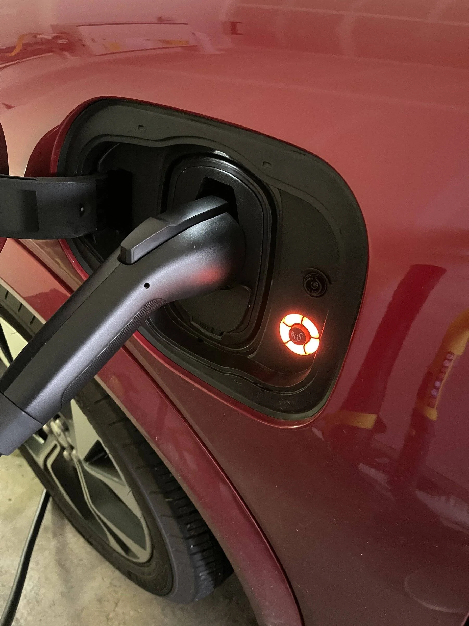

Update; today, March 18th, The Red First Edition has yet again come down with the 'I don't wan't to work today' disease (luckily in the garage this time and not on top of a mountain in 10 degree weather). Wasn't able to troubleshoot as I had to go to work so I took Boo. Currently waiting to hear back from @Ford Motor Company and Ford of Kirkland for further action. Will keep you all posted.
