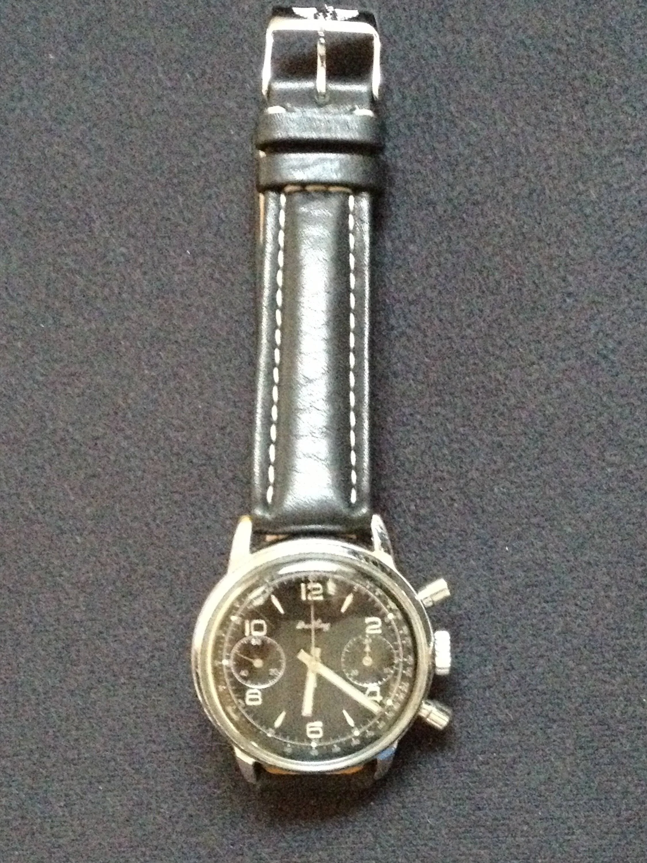

I wear a Breitling. My power problem is remembering to wind it. ??
13,025
17,577
Same. Or forgetting it has 31 day calendar and needs to be adjusted for months that aren't 31 days.
Ha ha. Mine doesn’t have the date complication. Old watch. ??
