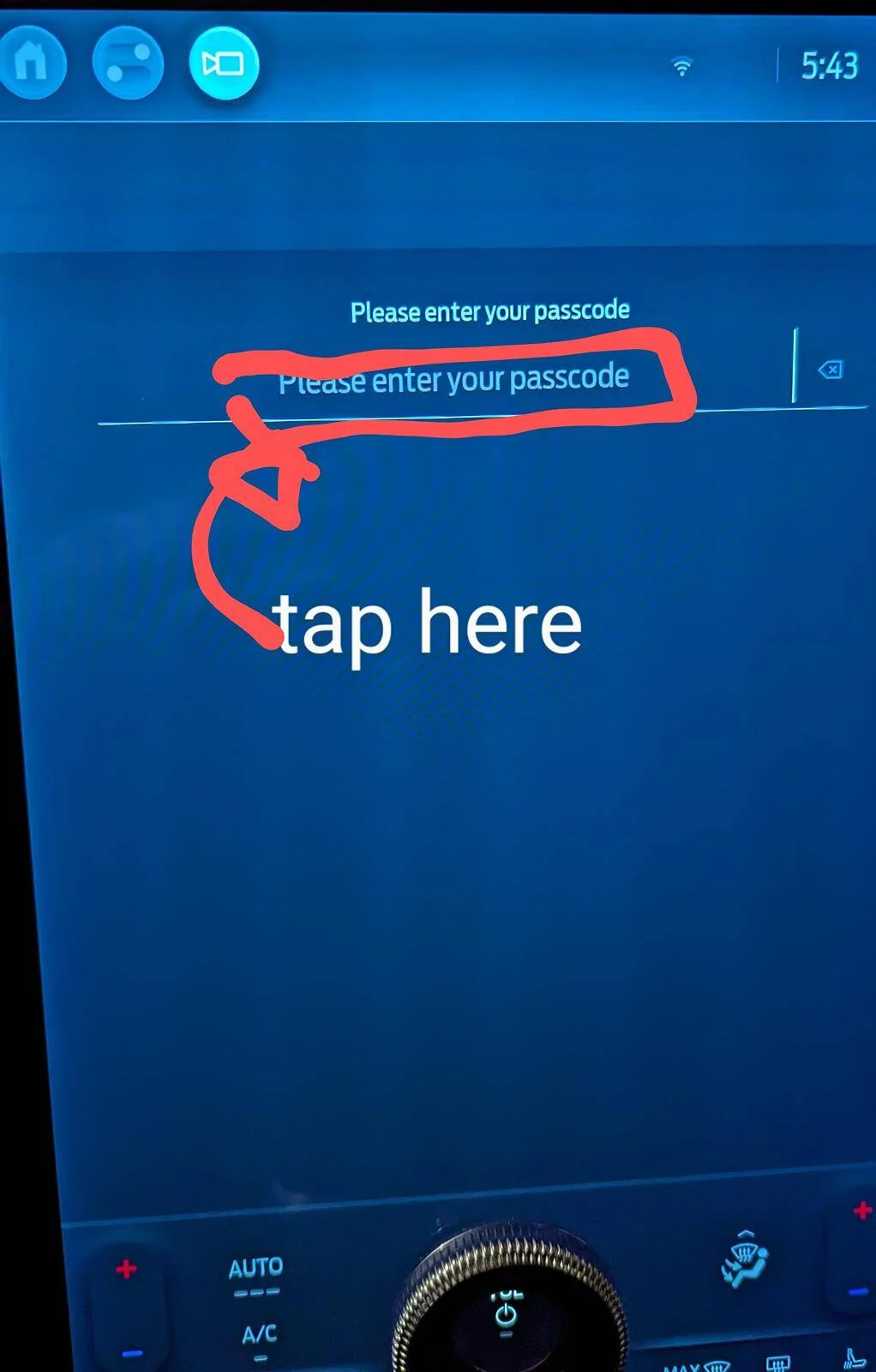

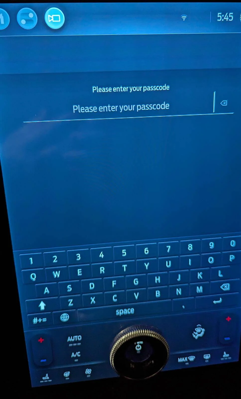

you need to tap in the input area - two pics to show the sequence:
then the keyboard should show up:
the important part of the repeated brake presses is to ONLY press the brake; do not also push the start button. the repeated brake presses is the trigger.
definitely a good idea to test it to make sure you know how it works and what to do if there are hiccups.
That worked had to touch in the middle between "enter your"

I use PAAK almost exclusively, and every few months I'll be in a situation where my phone battery dies. I actually kind of appreciate having the opportunity to regularly test that the passcode process works. The following has been 100% reliable for me: unlock and access the car using the door pillar pin code. Press brake pedal and then start button. Wait for passcode entry screen to appear, tap the text box to bring up the keyboard, then (in my case) make sure to click the "shift" button to workaround Ford's software bug that defaults the first letter of a password entry to uppercase. On trips far from home I'll bring the fob out of an abundance of caution, and in case the car needs to be towed to a dealer for some reason.
I wonder if people who are struggling with this are using a different process? I see mentions of using the app to access and/or start the car, which I've never done in this situation.
